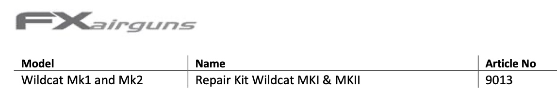

Anyway, I went to refill the gun from my diver's bottle and the O rings blew on the filling probe! The local gun shop had never seen one, so I travelled further afield and had to buy a complete unit - which worked fine!
Then the gun developed an air leak at the filling end of the cylinder! I had some O rings that I bought when I bought the gun and managed to replace it. Then the O ring leaked at the other end grrr! (due to the tapping at the other end maybe?) I replaced that as well. Finally it holds air again.
