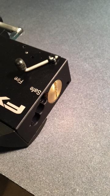

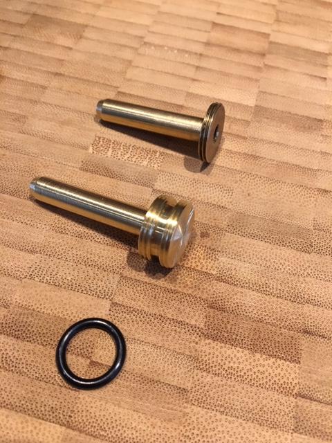

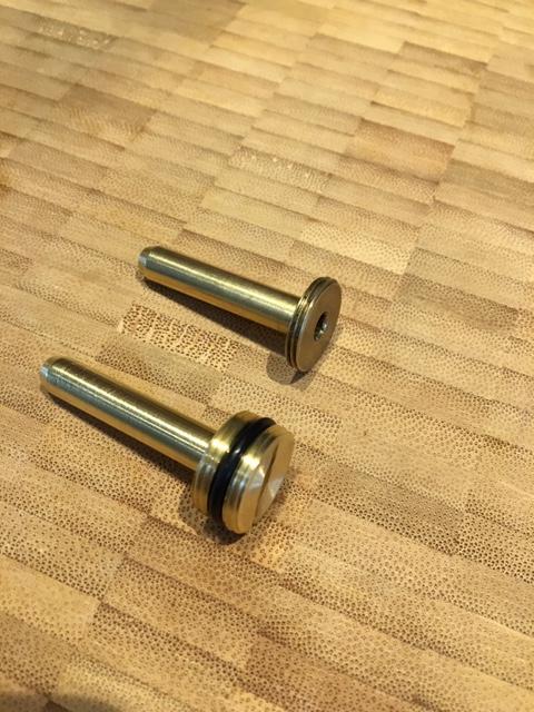

It was not holding on the position even with thread lockers. I increased thread length (added 5mm in my case) to be flush with the block with initial velocity around 780fps. Had a groove made and inserted an o'ring to act as a locknut. It is working well. JSB 18.13 optimal velocity after adjustment is 860fps.

Since I am not in the USA it makes a bit harder to help my fellow airgunners. Also, I have no access to other airguns other than mines. Hopefully the pictures I am sharing can help the community when sourcing from a local machinist. The issue with this adjuster was the spec M16 X1 which is not easy to find the proper tools. We had to make a nut in a lathe to use it later to calibrate the thread's adjuster.
