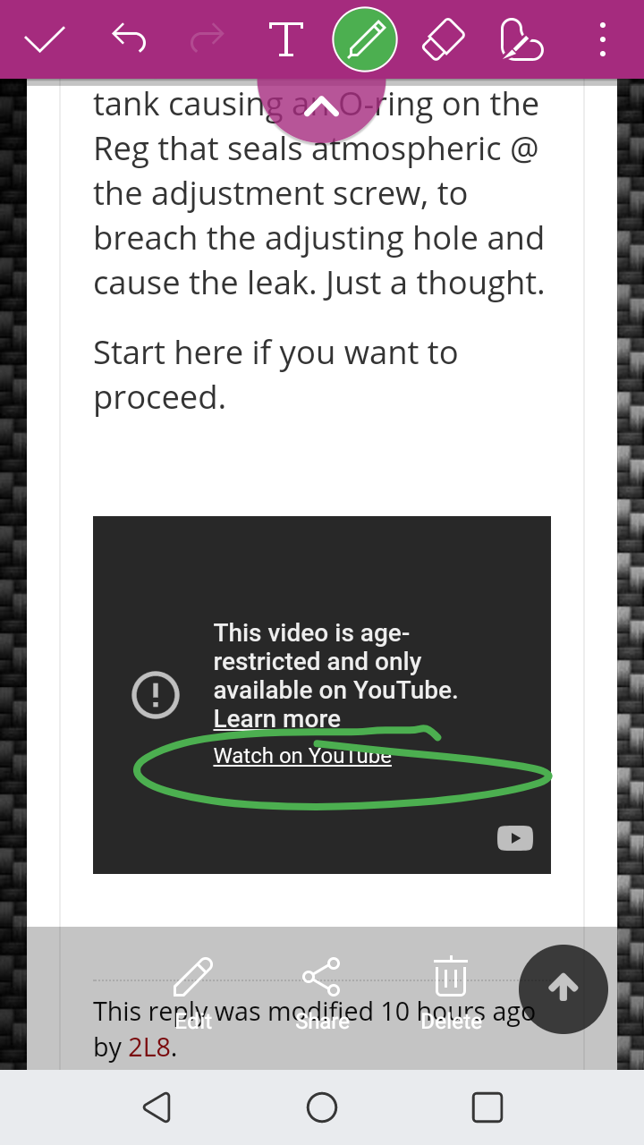

I remember reading somewhere that if you dont have a fast air source, there is some O ring that can unseat.
Any ideas on where to look for the unseated O ring? Up to now the gun held air fine. Yes, I bought this gun to begin exploring the FX world before moving up to the next one.
Any ideas where to look and the procedure for tearing it down? I can look at the Disassembly vid on YouTube so pointing in the right area would be great!
