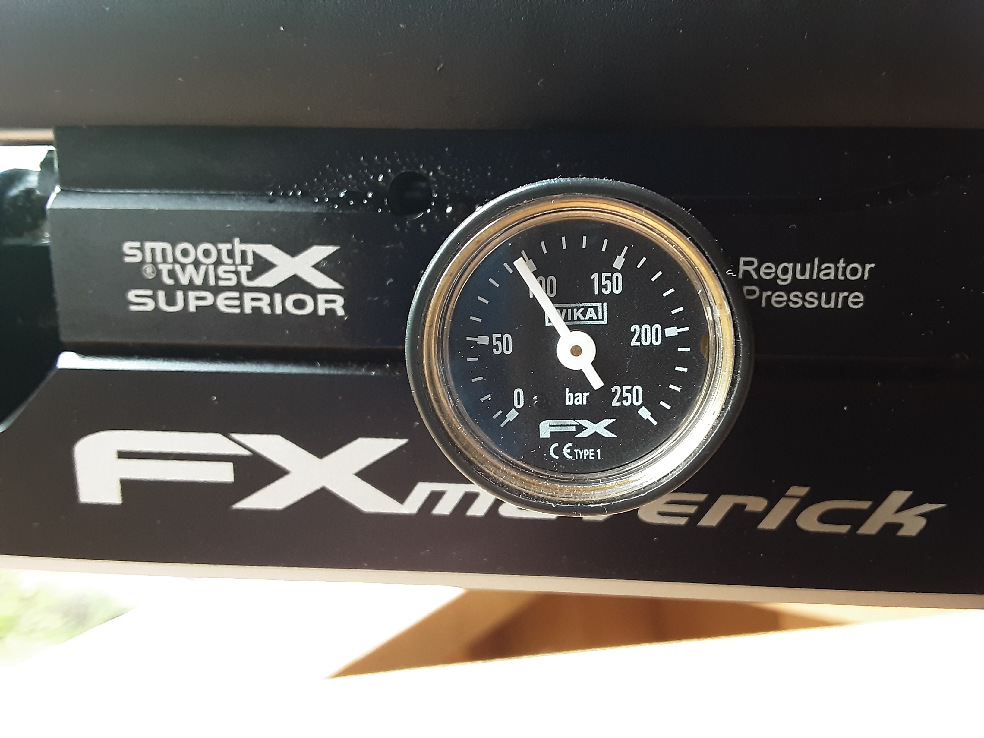

Pellet port…but I cheat a little with a slug probe, NOT a pin probe. Reasoning . Why have two small holes for the air to go through? I'm running 126.1 bar on the rear. It MAY have a .25 cal hammer weight in it because it was a .25 Sniper at one time, the .22 cal compact. Also be aware that I've tuned my Bellville washers so they are all the same. My SD in this gun isn't as quite good as my .25 and that may be the reason but it's close enough that I don't care. On #7 I'm still getting 60+ shots, don't ask the size of the bottle I've forgotten let's just say mid length, one size up from the compact. With 25.4 gr I'm getting 860 fps and 42.2FT Lbs with a SD of 7.6fps and a full spread of 26FPS. 22 gr slugs, 892 FPS, 19FPS spread and 7.5 FPS STD, 18.13 985 fps, 11 fps spread and 4.0 SD and the fun one....Crossman on HSA 4 14.3, 909fps, 98 fps spread, 34.6 SD but they absolutely drill, it's cheap thrills.

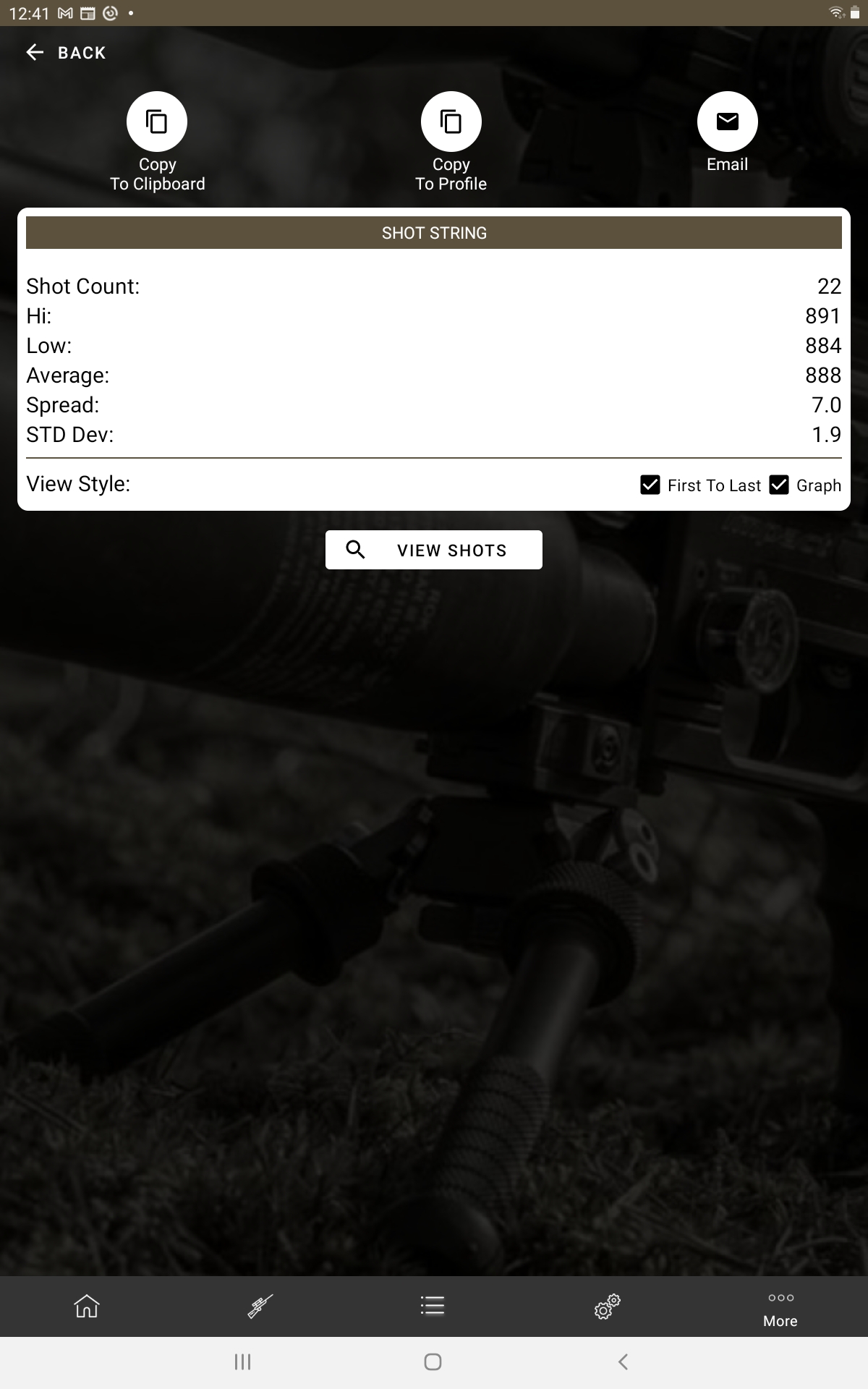

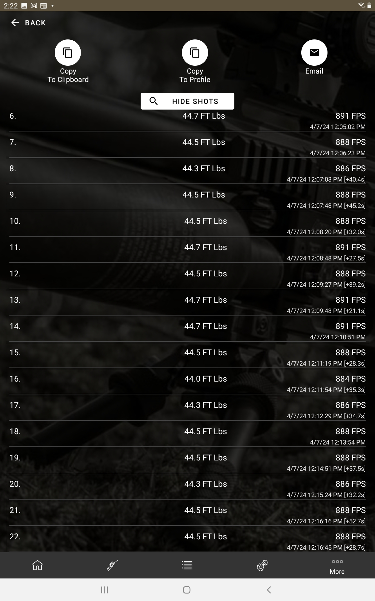

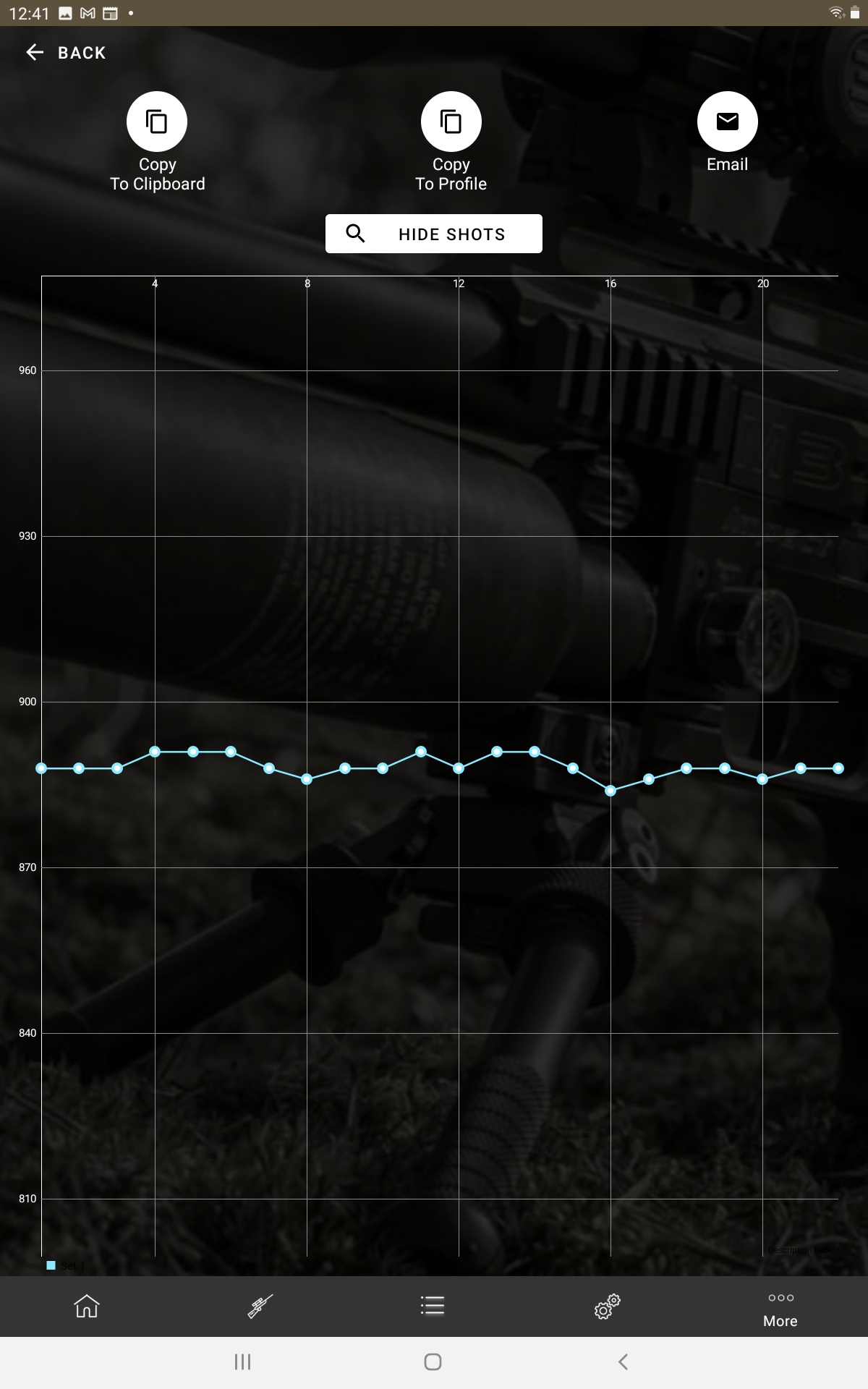

I finally got into the 1s with my Maverick . I was using JTS 25.4 pellets . Then I ran some more shots over the chrony with fx branded JSB 25.39 . Both the new design. The JTS was more consistent. Accuracy wise it was close, poi was about an inch left whith the JSBs. I finally got a CF 300cc bottle
Good data, thanks for sharing!
