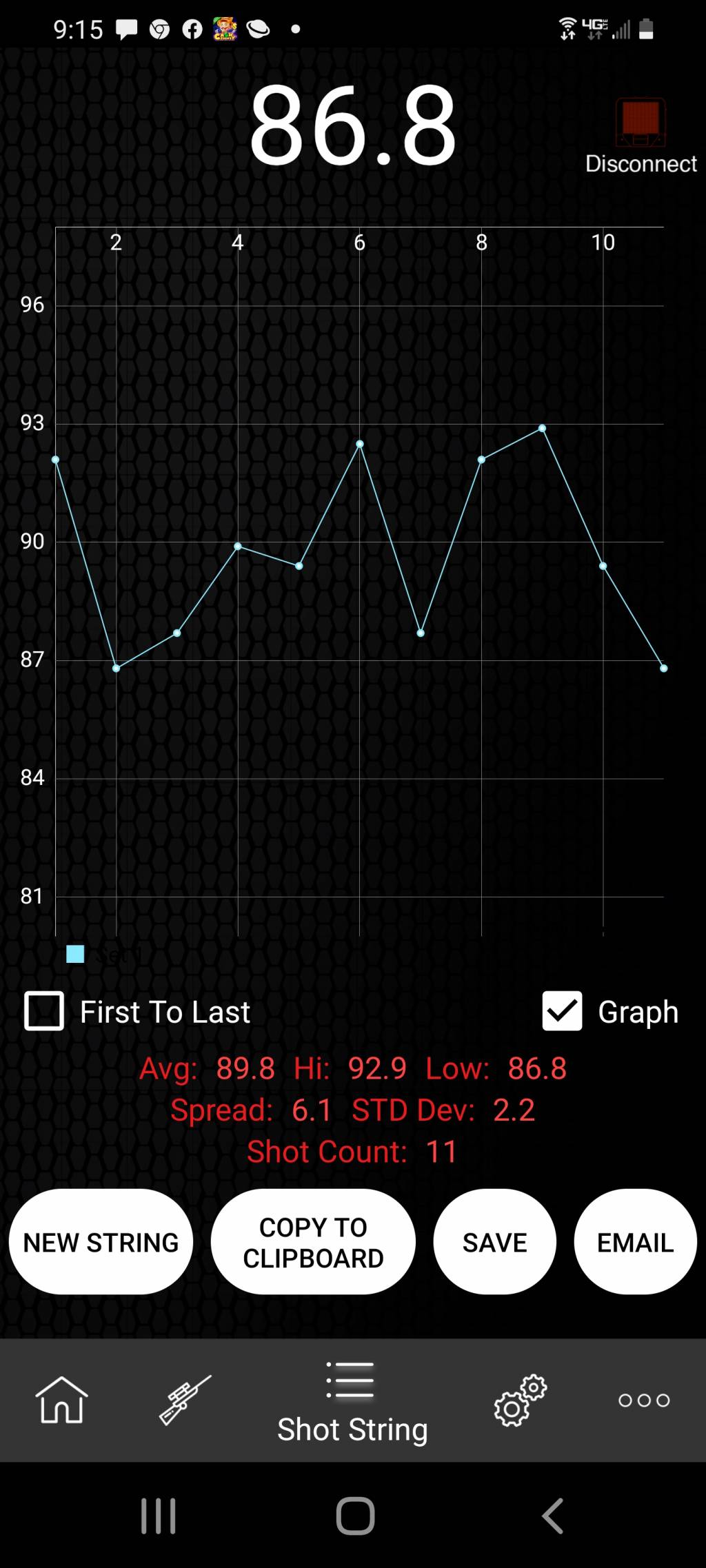

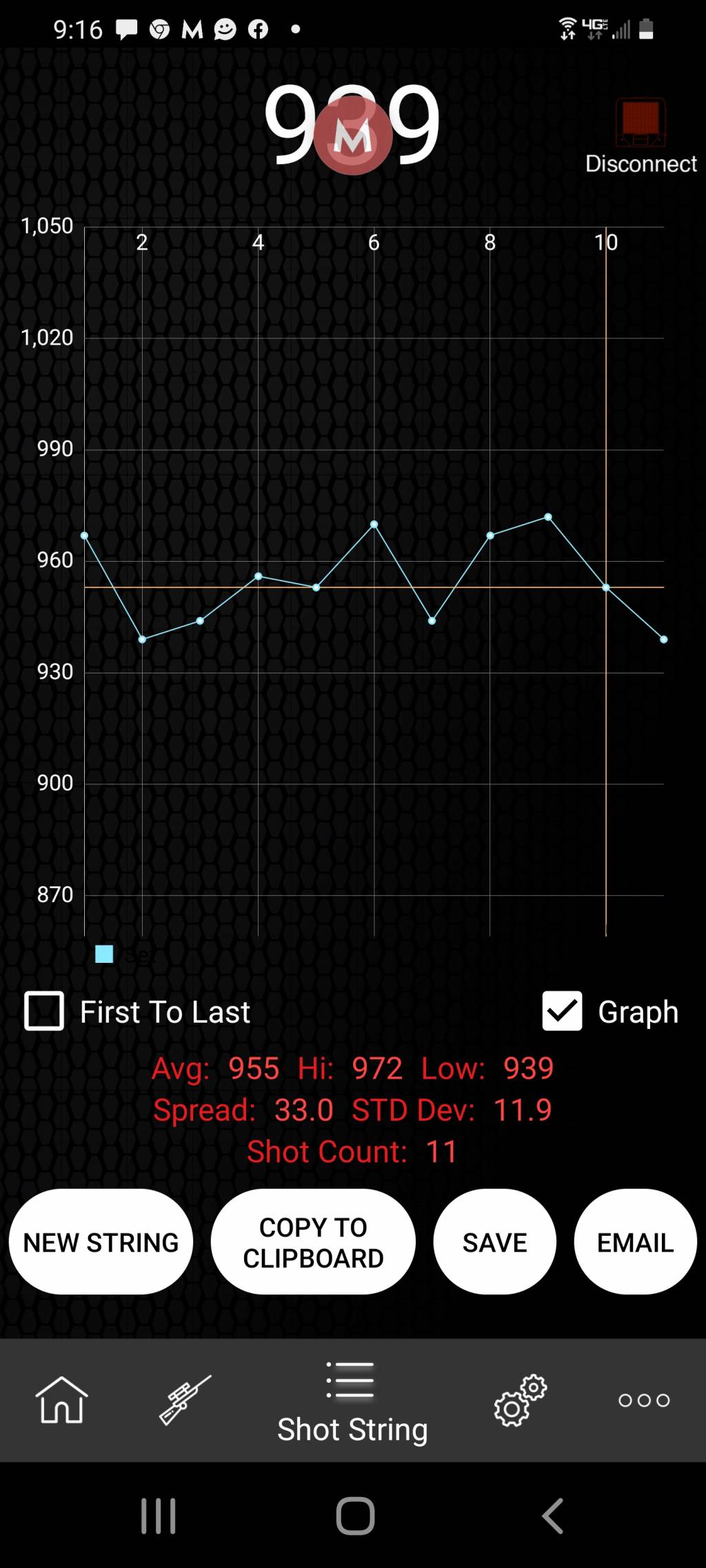

Just added a huma air reg and power plenum...reg set at 155 hammerspring maxed....no fine tuning yet but here are the results
