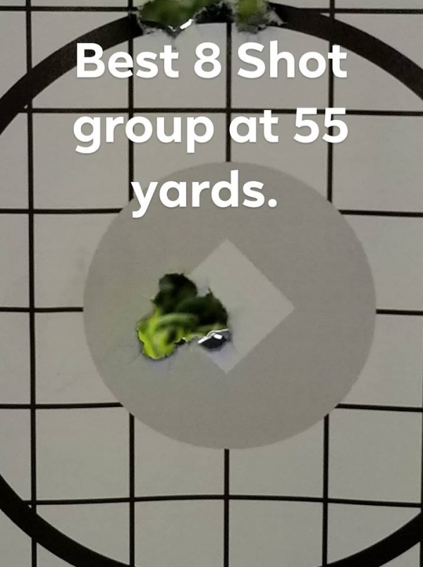

Ive gotten my Wildcat extremely accurate thanks to CHUCK here!
I suggest you try to turn down the reg pressure to 140bars, im shooting under .4" groups on 50 yards with King Heavy MkII with 140bars and hammer spring adjusted so i get speeds of 827-829 fps.
Today with a little wind i got 0.9" group on 70 yards, and i can easily hit beer cans at 100yards!

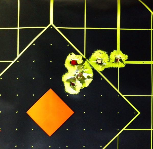

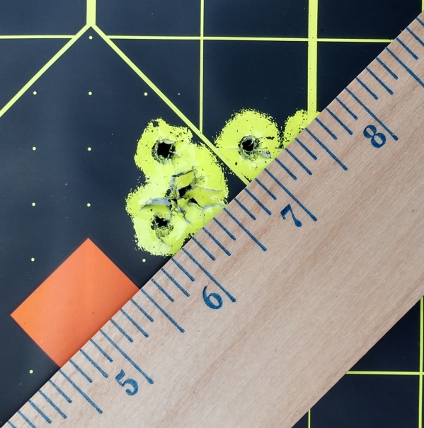

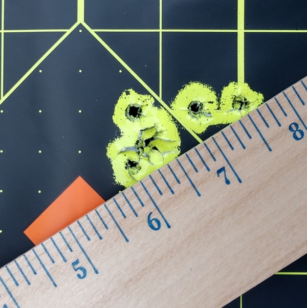

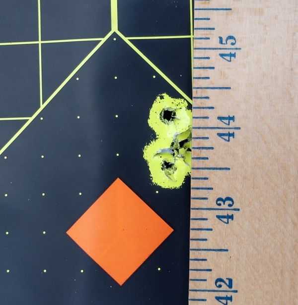

Here are a few pics of that 100-yard Target.
In my video I mentioned that the entire group was less than 1 and 1/2 in.
Turns out that it was just over one and a half for the entire group. Seven of the eight were just a hair over one inch.
But those six in that really small group were only 5/8 inch.
I just wanted to put this out there for accuracy.
Just some observations.

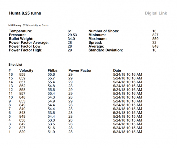

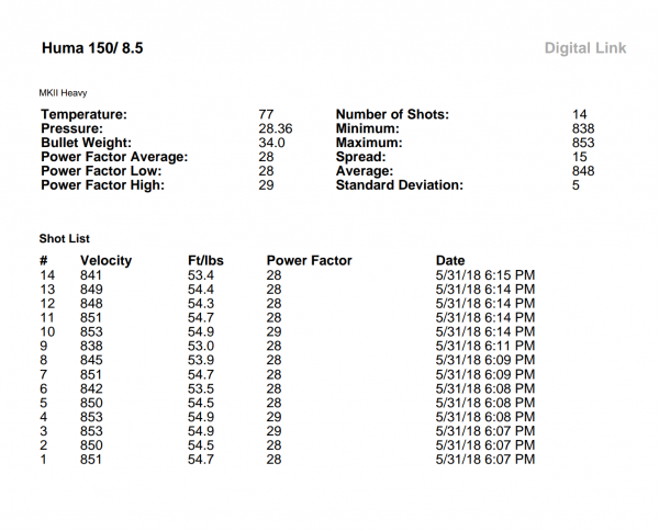

Average velocity was 848fps for both charts. However, the ES and SD was cut in half at the lower reg pressure.
Seems the "system" is more efficient at lower reg pressure and higher HS tension?
This first chart was with ST barrel, Huma set at 155 bar, HS set at 8.25 turns.
This second chart was with ST-X barrel, Huma set at 150 bar, HS set at 8.5 turns.

Just some observations. Average velocity was 848fps for both charts. However, the ES and SD was cut in half at the lower reg pressure. Seems the "system" is more efficient at lower reg pressure and higher HS tension? This first chart was with ST barrel, Huma set at 155 bar, HS set at 8.25 turns.
bob your wildcat first chart is also looking like your AA can you relate them? Do you still think is anything wrong with your AA reg?
Interesting you found this and made a connection. I suppose it could be that the reg pressure and hammer spring tension are not working well together.
I have about 900 pellets through the S510 after today. I'll run another shot string after 1,000 pellets and see if there's any improvement. I don't expect there to be, it's probably as good as it's going to get, which isn't terrible, but can't compare with the Wildcat in the state of tune it was in when I sold it.
