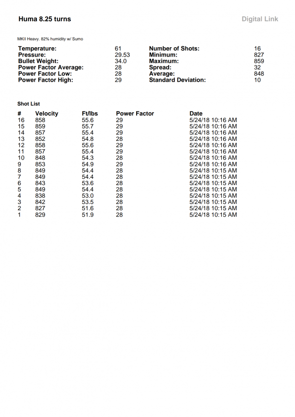

Here's a shot string at 8.25 turns in. Now to check for accuracy and wobble.
I agree it doesn't look great. And I still have some wobble. Less than before but still there. 100 yard group was better.....1" wide and about 2" tall. First two shots were next to eachother, third shot was a little higher and 4th and 5th were about the same as the third.
I have a ST-X barrel on the way. Going to leave the gun as is for now and see what happens with the new barrel. I know it has nothing to do with the regulator, but I was going to get an X barrel anyway.....part of the reason I bought the WC MKII. Maybe that will drop the velocity a smidge and stabilize the pellets. If not, then I guess I'll go to 8 turns on the HS. If that doesn't work, my thought is that I would need to drop the reg pressure to 150 maybe and crank the HS tension back up?
Bob forgive me if I sounded like I was being critical but I wasn't... I was just flabbergasted! My Wildcat has an extreme spread of 6 feet per second with a standard deviation of 1.6 ft per second, so you understand why the shot string you created from today looked just terrible to me.
You say you bought this gun primarily for bird Pest Control so you don't need all that much energy to kill them efficiently and humanely. So why don't you try this... set your regulator down to 140 bar, and adjust your hammer spring tension until you find its Peak Performance and and find out what your velocity is with the MK2 pellets. If I remember correctly you will be about seven and a half turns in on your hammer spring nut, and with your reg set at 140 bar that should put you at about 830 or 840 feet per second which will be very accurate and still deliver 10 times more energy than you need to dispatch a pigeon.

No forgiveness needed, the shot string isn't impressive.....I put it up primarily to show the reduced velocity. I bought the 25 because the farmer asked me to shoot skunks and raccoons......I already had the Streamline for birds. I've been using the WC on the birds, one because I can and secondly because I had to take my Streamline out of service because I needed the scope mounts from it in order to use the WC.

I guess the first thing I will find out is how much difference in velocity a 5 bar reduction on the regulator setting makes.
I'll post up a chart later. If tuning the HS gives me a velocity I like, I have a target with me as well and I'll check for accuracy at 50 and 75, and 100 if I have the time.

Based upon the above, if I lower reg pressure by 5 bar (from 155 to 150) but left the HS at 8.25 turns, should that result in a decrease in velocity and if so, any idea of how much?
28 fps slower averaged.
Here's a chart with the reg set at 150 and HS 8.5 turns in.

Bob that shot string looks much better than the ones before, and your right about the energy level being more than adequate for what you will be using it for. And that was a wonderful video you made...no wobble as far as I could tell, and 1" to 1 1/2" groups at 100 yards is more than accurate enough for any small game you may hunt! Very nice concentric group for 6 of the shots...once you start weighing your pellets and shooting a magazine of pellets that all weigh the same to within 1/10th of a grain you can say goodbye to those annoying flyers too, unless of course a big wind gust grabs one. Me and my friend Gabe were shooting on Memorial Day in 16 mph wind that was gusting sometimes up to about 30 mph, and still getting one hole groups at 50 yards with no flyers with weighed, sorted, and lubed pellets.
