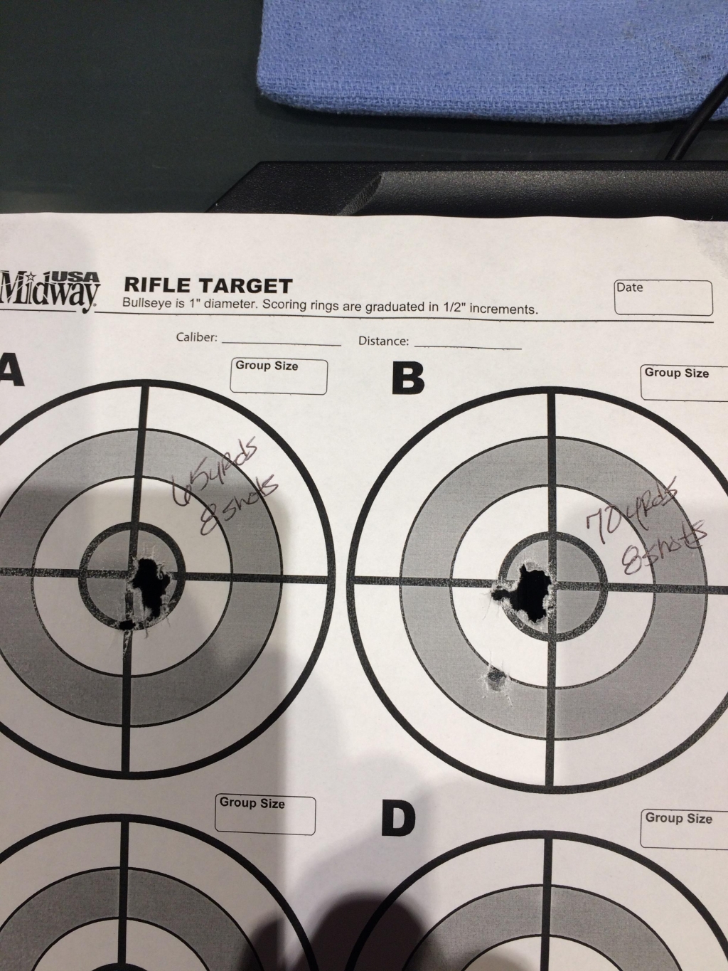

Okay been a while since I have posted related to getting things in order. I have since gotten my 600 FX X barrel and put in HUMA regulator here is the following review. I have finally gotten time to tune and adjust the regulator and hammer spring to a Vel of 900fps. All of this was it worth it well I would say yes got a constant velocity along with great accuracy. I have posted a couple of pics of 65 & 70 yard target groups on early dead calm morning. The 70 yard was to the left as I adjusted the scope but I should have left it alone. No more POI shift on first shot.
