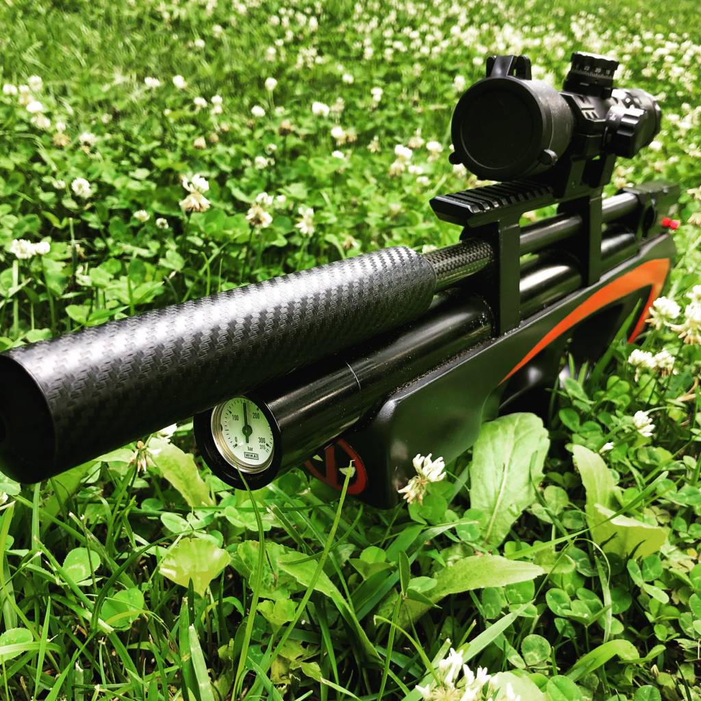

@tor47 Barrel has been cleaned & polished. I don't have to clean my Crickets this much, ever. I know there are guys out there that never clean their FX liners and their guns shoot well, or so they say. As for the different kind of pellets, it doesn't seem to matter what I do. I shoot 8 shots of the JSB Monsters into a single hole, test again in a little while, same POI, test again and it has gone to hell with no explanation whatsoever.
@bubblerboy64 Have verified the scope is not the problem. I have changed the scope a couple of times. I have also shot the original scopes that came off the WC in the other guns and the other guns are shooting perfectly.
@rj I can tell you that there is no o-ring in there. I looked. Will look for the size and see if I can source from somewhere and install. Hope that is the problem. Pellet probe is spot on. Have meticulously measured each time I take gun apart. All screws are on tight.

Just shot it again and the darn thing became a shotgun again. Same ammo, same everything, gun was cradled on shooting bags, has plenty of air. Mind boggling!!!

Not only is there supposed to be an O ring inside the liner locking nut, there is supposed to be one inside of the breech end of the barrel sleeve that the liner presses into.
When you insert the liner into the sleeve, you should feel it hit, then press past an O ring before seating fully into the brass transfer port.
If either or both of them are missing, therein lies your issue.
Well, the ine inside the liner locking nut is missing. The one in the breech end is fine.
As for the hammer assembly, it’s the only thing I did not take apart. That, if needed, will be for another day.
Gun shooting accurately again, I think, FYI. Go figure. Either that, or the last 2 chipmunks I just shot are the unluckiest sob’s there ever were.
