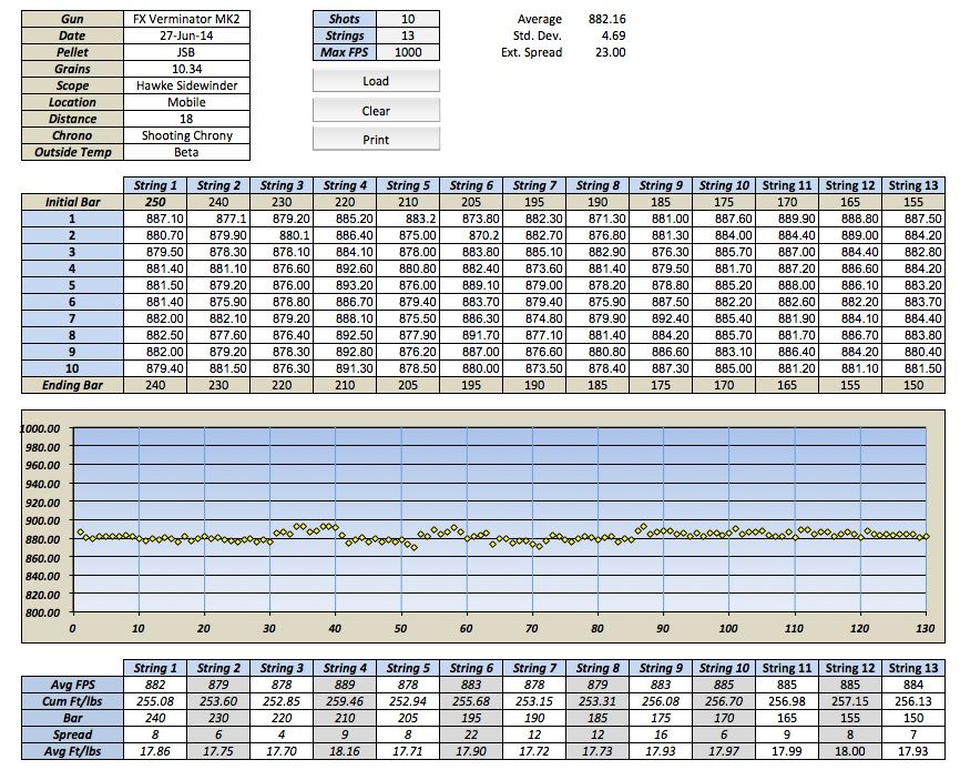

The Verminator MK2 (NOT the Extreme) is not 30 FPE in .22 and certainly not 24 FPE in .177. The 22 will be 24 FPE and the 177 is 17.5-18 FPE. I used to have one in 177. It was a fun rifle. I sold it because I got away from 177 but, it would get 130 shots before falling off the reg. I had the Huggett put on mine. It was the quietest rifle I've shot to date. Loved the JSB 10.34 gr.

With a regulator in the rifle you can fill to a higher pressure. The valve is what's limiting you to 220 bar. The regulator only allows 140 bar, or whatever the reg is set to, to get to the valve.
