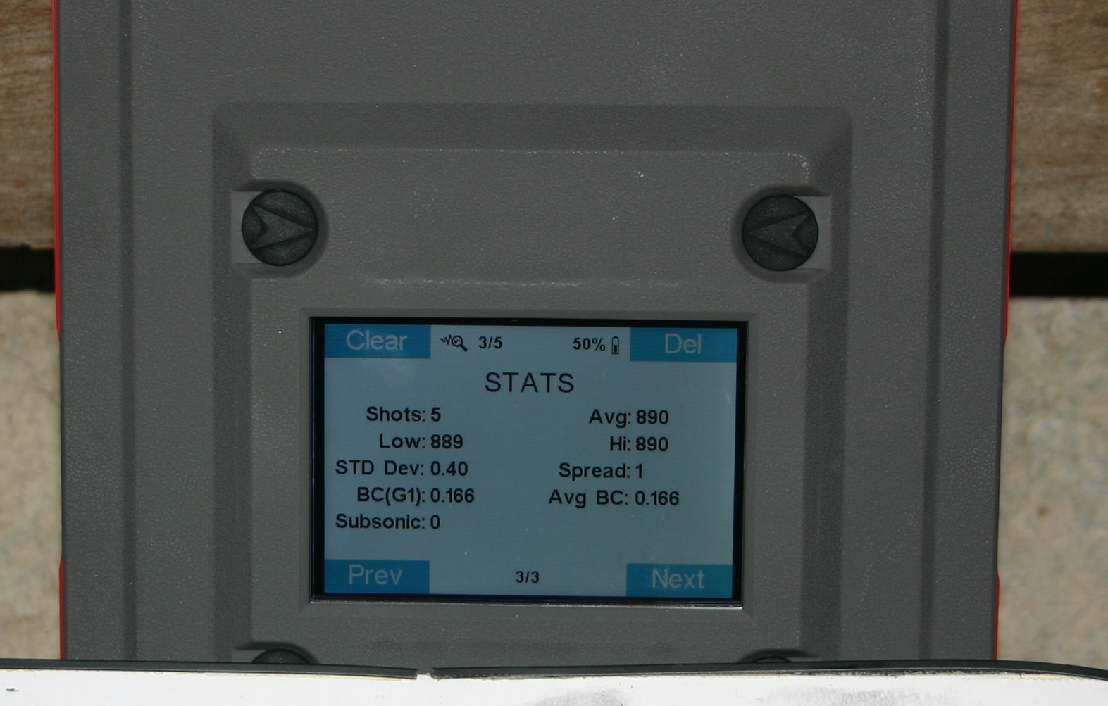

I did some 100y testing at the Misenheimer Ranch. Figured I’d pass along my findings.
1. The True Ballistic Chronograph is super easy to setup & use. I lined it up directly beneath the muzzle and it didn’t miss a single shot.
2. Atmospheric conditions affect the BC! Use the FX Radar app and select the option “send local weather to device”.
3. If possible record data out to 100y+. The BC most definitely changes as the velocity decreases.
4. While an average BC can be useful, multiple BC points are even better.

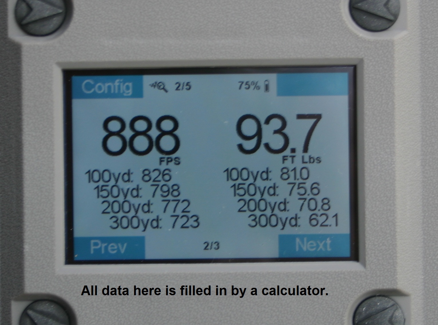

I've been using one of these for comparing different slugs BC and velocity consistency.
Great little unit. Very happy with it. Reads every shot even in the dark.
Don't assume that it reads at multiple yardages though.
It takes two readings, near the muzzle and somewhere inside of 33 yards and fills the rest in with a ballistic calculator.
The unit doesn't read at all those yardages
That being said, I still think this is a very handy chronograph.

Is there a good reason to get this instead of a Labradar that reads real velocities ?

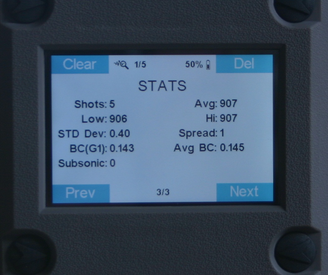

I spoke with Johan about this. It is true that in your scenario much of the results you are seeing are calculated. Here's some more information to help everyone understand this:
  • When setup properly the doppler radar will take hundreds of readings throughout the flight of the projectile (the 1st reading is taken after 10-15 yards).
  • Currently the most accurate readings are at 150y or less.
  • If you notice at the top of the display you see 1/5, 2/5, 3/5. This refers to how well of a reading was taken. 1/5 and 2/5 are really bad and chances are you're getting more calculations than raw data. 3/5 is better, but obviously 4/5 and 5/5 would be best. The raw doppler data can be improved by minimizing interference and properly placing the chronograph in line with the path of the projectile.
  • A new feature is in beta testing that will allow the end user to decipher between the actual doppler data and the calculated data. This will become available as a free firmware download in the near future.

Michael,
I believe there needs to be some clarification on how the TB Chronograph takes readings and displays the results. I had a conversation on AGN with one of the developers of the TB App about this very topic. The conversation started because I used the TB when I was shooting some of the AGN 30yd Challenge cards and I had it set up to give speeds at 10, 20, 30 and 40 yds. I shot the target and got velocities at all four ranges - only the pellet stopped at the wood backing of my target at 30 yds. So I figured that the velocities provided were CALCULATE and not MEASURED.
Below is a link to a conversation I had with AGN member "fiske" who stated that he is one of the developers of the software and app for the TB Chrono. He states that because they are sampling at about 1mHz they are doing the DSP in real time and do not store the raw data. So any data that they can output will have significant processing on it (a good thing actually). What I also got from this conversation was that the return signal from the pellet gets worse with range (see the spectrum he provided) and there is definitely a range limit on the radar (appears to be something like 100msec - so at our velocities something like 30-40 yds). So I expect the data it is providing at 100 yds is an extrapolation based on the ballistics calculation. The typical ballistics calculations done on a smart phone are estimates and only deal with drag in terms of known ballistics profiles, not computational fluid dynamics.
What I am trying to say is that while your BC calculation efforts are well intentioned and a good idea, I don't believe you will be able to do what you want with the TB Chrony. I would be happy for fiske or Johann to explain why I am incorrect in my reasoning.
Cheers,
Greg
