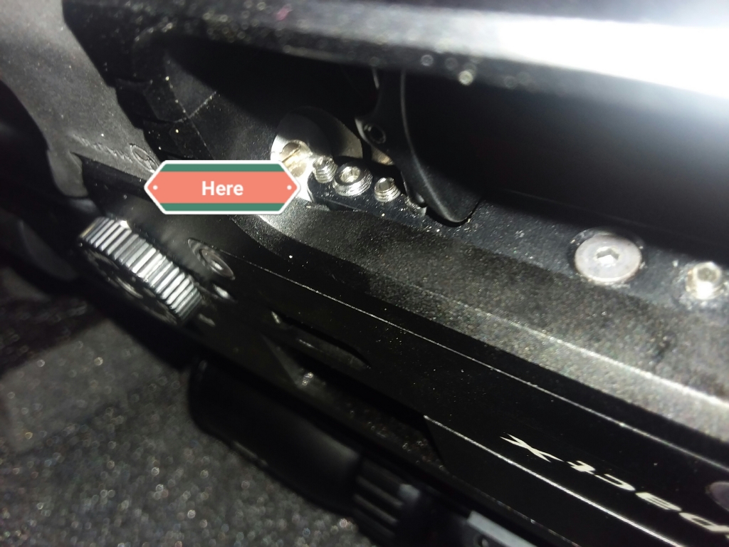

Not saying this is the problem, but it's worth a look.
Check to make sure the trigger isn't bumping up against the regulator body. If that is the case, have seen this before, and you need to screw the body in. Just a 1/8 to1/4 turn will make a big difference. If they are touching, trigger won't move much, and feels sticky.
In the picture I tried to point to were they can bump.
