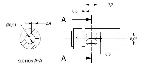

But your goal is to make it as close to the transfer port in the block with as little restrictions as possible.
I did a modification to the Huma transfer port (I have only a hobby micro mill, no lathe unfortunately.
With a 2mm ball nose endmill I could only widen the two slots, I didn't wanted to brake in into oring groove neither into barrel end. These are the numbers I could get, 7.2 x 8.0 mm (from 7.1 x 6.4 mm), on 25 cal port. I never toke it apart and could not measure what is a hole size in the valve housing block, and especially is it aligned at all or where is it exactly.

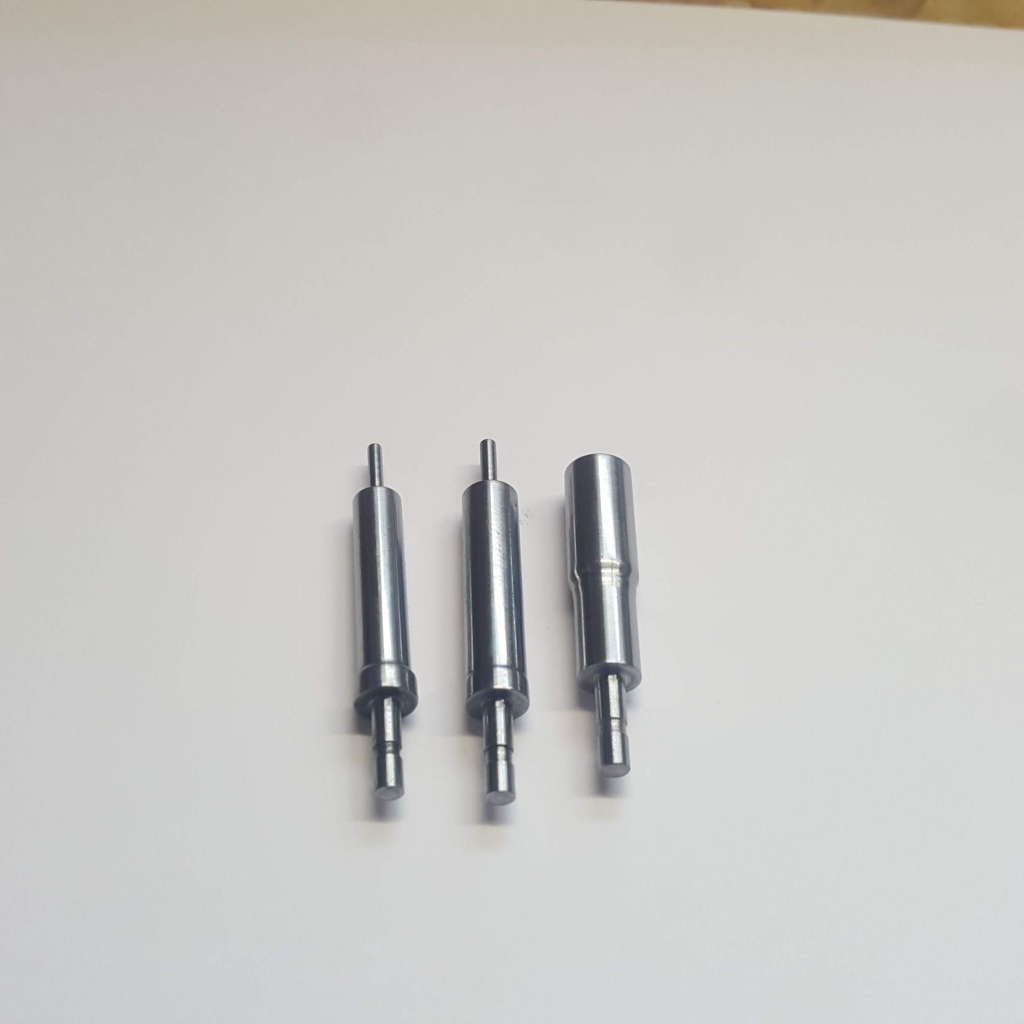

very interesting info regarding the Huma twin hole here. I already asked @Huma themselves if they would/could provide matching pellet probes. They said that they have plans in the future. I also have one, but i just put a warning topic on the forum, regarding someone who stole $280 from me.

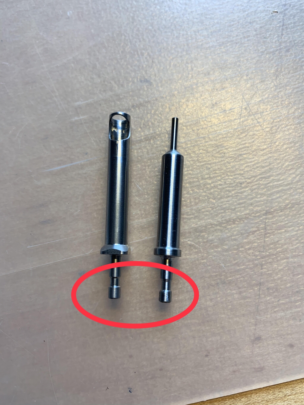

The pin pellet probe looks awesome, and made from decent materials.
The Polish man who’s got my money, also sent me a brass barrel probe, wit oval hole, but did not measure it up yet, because the Huma one has my favor.
Only problem : I’m from europe, and dont know anyone with a lathe to make me a pin style probe.
Gonna order and try Vlad’s version also, but with the corona virus, he can’t send anything out of his country.
