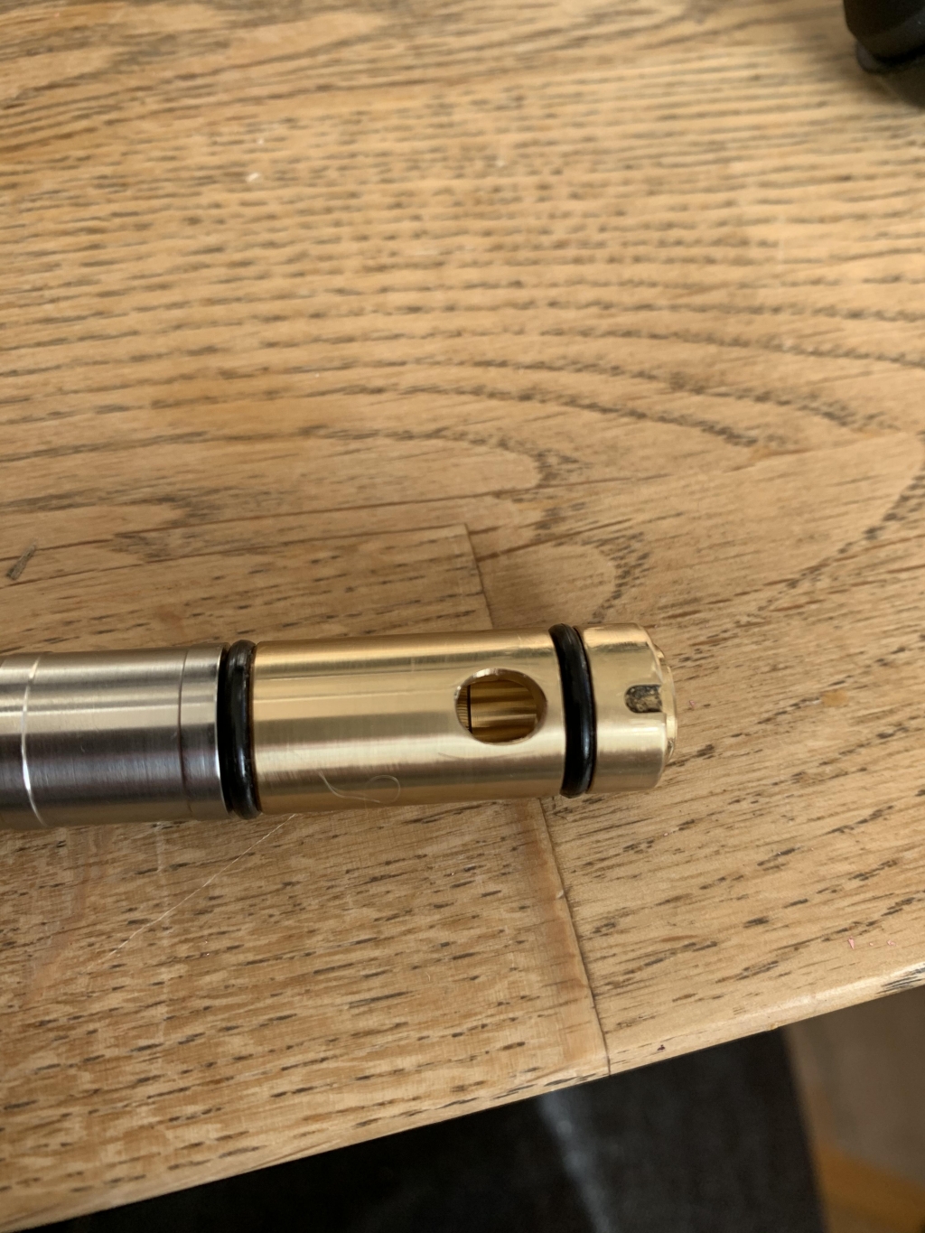

This is my attempt. Not tested yet. (No time and no possibility...... )
Looks like it is a lot bigger than the HUMA variant. (square 7.2mm) I've milled it with a 2mm end mill.
Would have thought that the .22 HUMA port should have been bigger, my oval port has got more surface area than the stock dual HUMA port.
I agree with Spyde82 that increasing the TP size is the easiest and cheapest way to gain power

I found that if you elongate it forward so it messures 6,3 x 5,2mm most pellets will work and it will give you some good results.

The oval port is bigger...but only after it causes pellet issues. I suspect the HUMA port is considerably better than the stock port. I will attempt an elongated port that isn't quite so radical. Any little bit will help.
I have never had any issues with pellet issues whatsoever.
If you get pellet issues, you likely went too wide on the port. That's why you should only lengthen the port, and leave the width as is.
Regarding the probe, deburr it meticulously in and out, front to back, to prevent o-ring damage.
This is my latest try on my 22cal port, I recessed the 7mm hole as far as I could.
TP size is 5mmx7.2mm
I've reached 103 joules (76ft/lbs) in 22cal, so I suppose it is doing all right
Spyde82 did right hogging it out, otherwise the gains would have been far less.

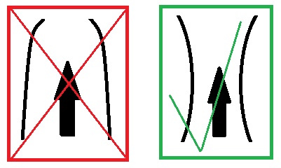

When making a turn you always want a radius. In a tube the largest part of the flow will be on the short side radius and so the greatest gains in flow will come from there. The smoother you make the turn the greater the airflow. You want to be as close to laminar flow as possible even though you'll never achieve it.
You are absolutely right but by removeing Air restriktions you Will get better flow, i would think

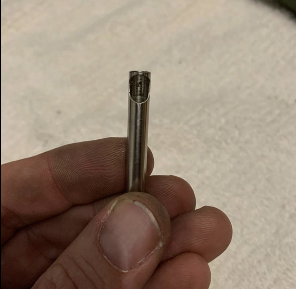

Ack! My tool tip bounced out when elongating the probe window and I scored the outside. Can't feel it but probably blowing air back now. Best place to buy new probe?
Polish the scratches and it will be fine. The o-ring will seal it.
