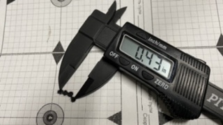

Just to add to CC's information; If you look closely at CC's pic, where the liner meets the conical piece on the right, you'll see a brass nut. Inside the conical piece there are 5 O-Rings. That brass nut tightens down, squashing the O-Rings against the side wall, compressing the O-Rings creating a solid-ish connection to the block/receiver. That is what holds it in. There is another thread here where danny5692 has created a 3D printable spacer. So, instead of having them attach to the liner as in CC's pic (3 of them), they attach to the carbon sleeve once installed (2 of them on the carbon sleeve, the third is at the muzzle on the liner as the carbon sleeve ends before reaching the actual muzzle). I just had two printed and hope to test this week sometime (wind permitting).
