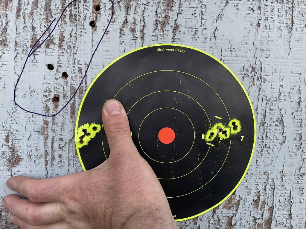

I can confirm that my Superior liner still needs cleaning. I'm shooting a .30 superior slow twist 1:37. It has about 1200-1400 shots through it and I've cleaned it twice, but waited too long both times. Accuracy had already slipped significantly.
First cleaning around 600 rounds I did 5 pulls with JB bore paste. Barrel was SUPER dirty.
Second cleaning around 1200 rounds barrel was cleaner and took a lot less patches. I gave it another 5 pulls of JB bore paste. From here on out, I'm planning on normal cleaning patches only, no more JB.
Last time I cleaned it, it was shooting about 1" at 50 yards. After cleaning it went down to 0.375" at 50 yards. Groups were so tight I had to jump to 100yards to do any tuning. I'm shooting JSBs right out of the tin.
I pull my liner to clean. This is easy since I am using masking tape wound around the liner in 4 locations rather than o-rings, and also I indexed the liner and marked both it and the housing by grinding a tiny dot with a dremel (paint, marker, etc didn't stick well). So far it has returned very close to original POI.
