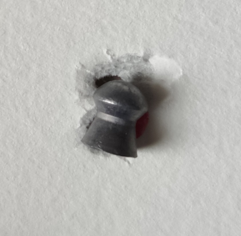

One more thing is that when I push a pellet through the bore it does not go perfectly smooth. I can feel about 3 tighter areas in the bore and then there is a choke.
