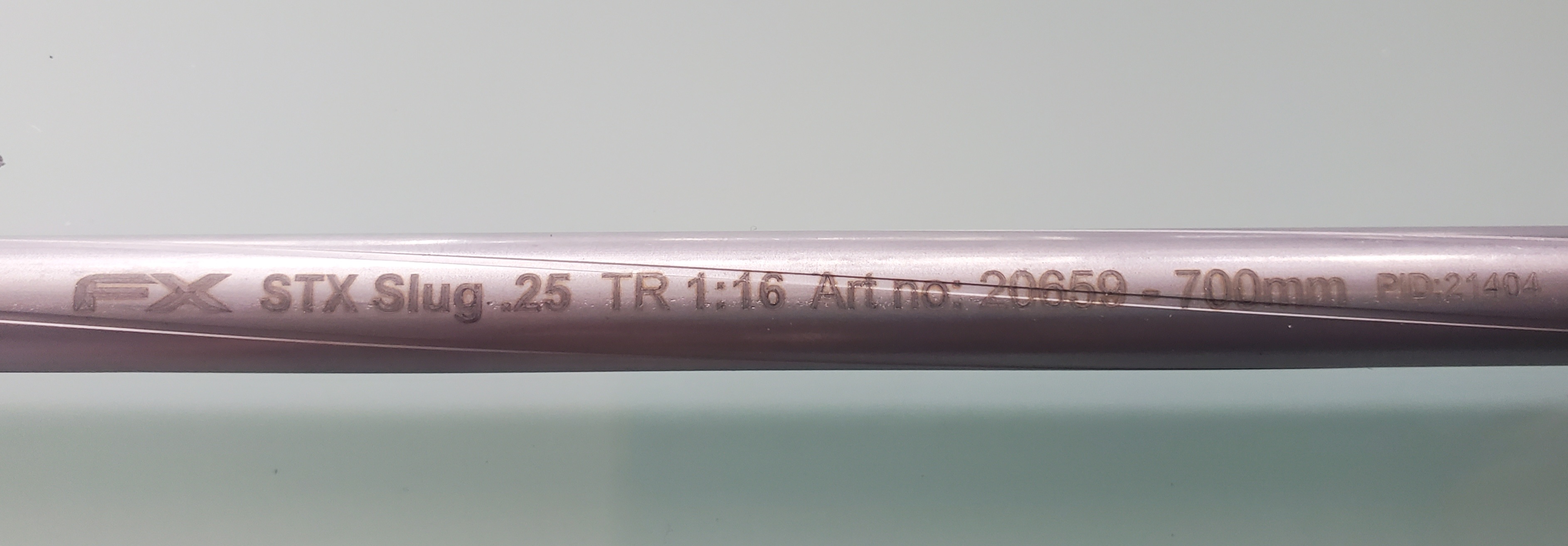

I did some testing this last weekend with the new 0.25 cal, STX Slug liner (1:16 twist). The results were discouraging and unpleasant to say the least.
My FX Impact M3 is setup as follows:
  • 0.25 cal, 700mm barrel
  • STX Superior Slug liner (1:16 twist) – latest and “greatest” version
  • Carbon fiber liner sleeve
  • FX carbon fiber tensioner kit
  • Reg 1: 180 bar
  • Reg 2: 145 bar
  • Probe: Factory pellet probe
  • Transfer Port: Slug side
  • Moderator: DonnyFL Sumo (.25/.30)

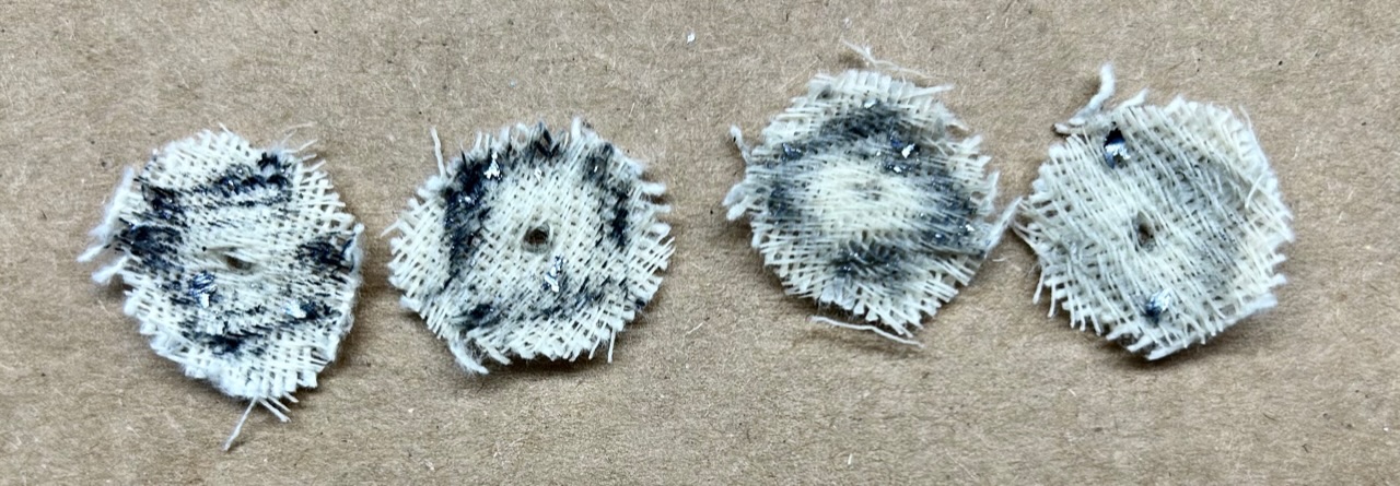

After getting home from the range and feeling defeated I decided to the clean the liner with my Patchworm kit. The first 4 patches were extremely dirty with large amounts of lead shavings as shown below. It took another 50 patches to get the liner cleaned switching between Ballistol and Butch’s Bore Shine to get all remaining lead fouling out of the liner. Some lead particles were extremely difficult to get out and I ended up using a cooper bore brush to “scrub” the liner as the patches and chemicals would not pull them out. I suspect heavy liner fouling is what caused the fliers during testing.
