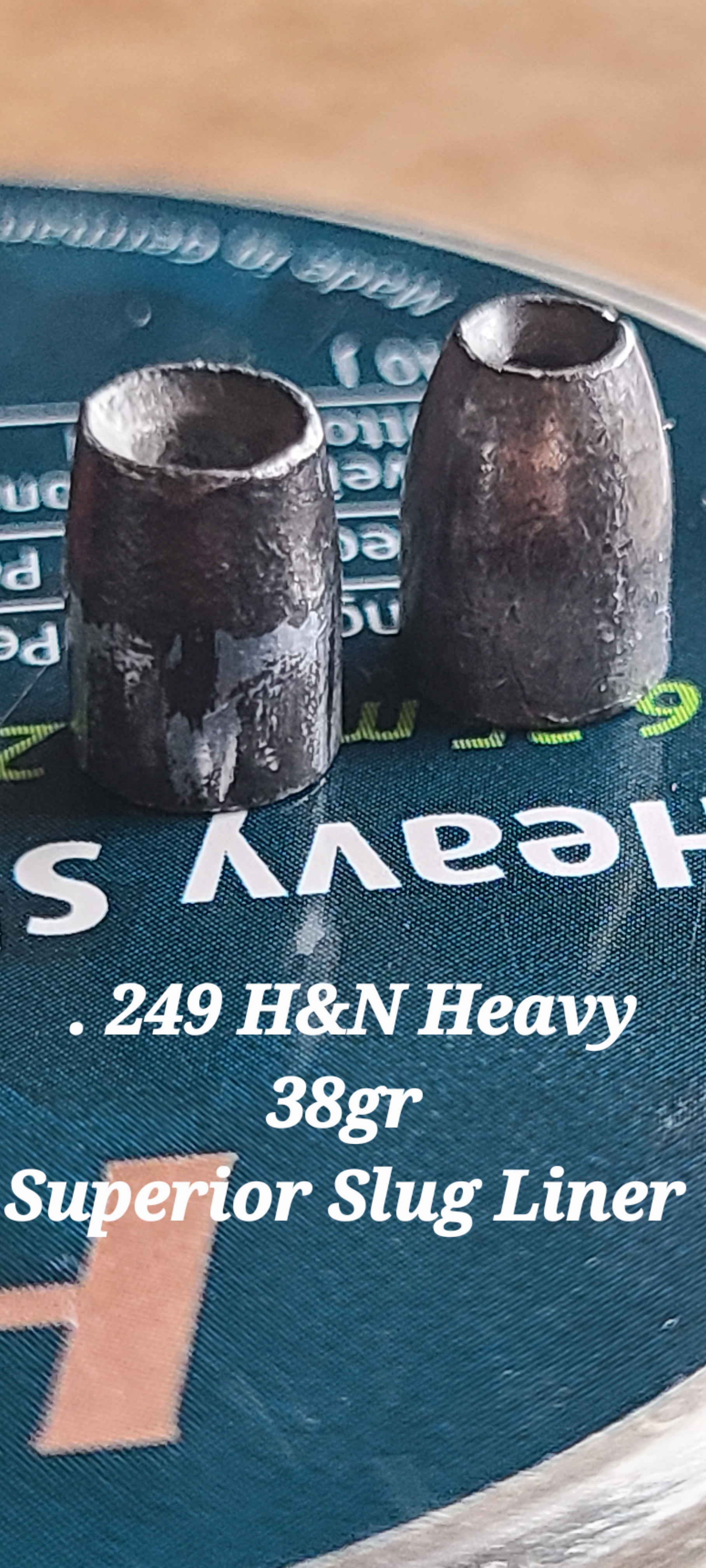

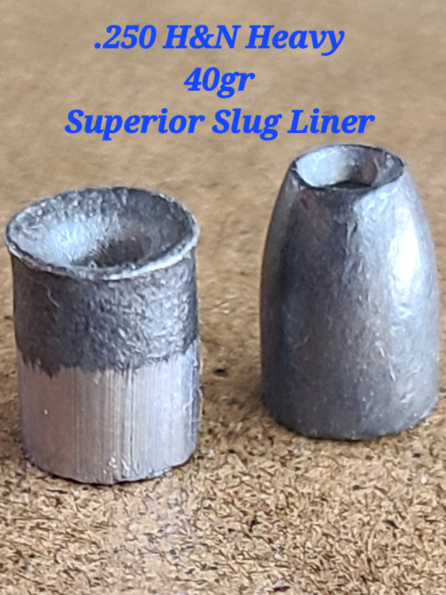

I just received my Superior Slug Liner. From what I can tell comparing it to the Superior liner and the Slug Liner A that I have.
My observation while cleaning the 3 liners is the choke in Superior Slug Liner is more gradually tapered and not as noticeable but the bore is tighter that the other 2 liners.
I don't have pictures of slugs I have recovered from the Slug A or Superior liner but look how tight a .250 slug compared to a. 249 slug.
The .249 looks more like .250 slugs I have recovered from the other 2 liners.

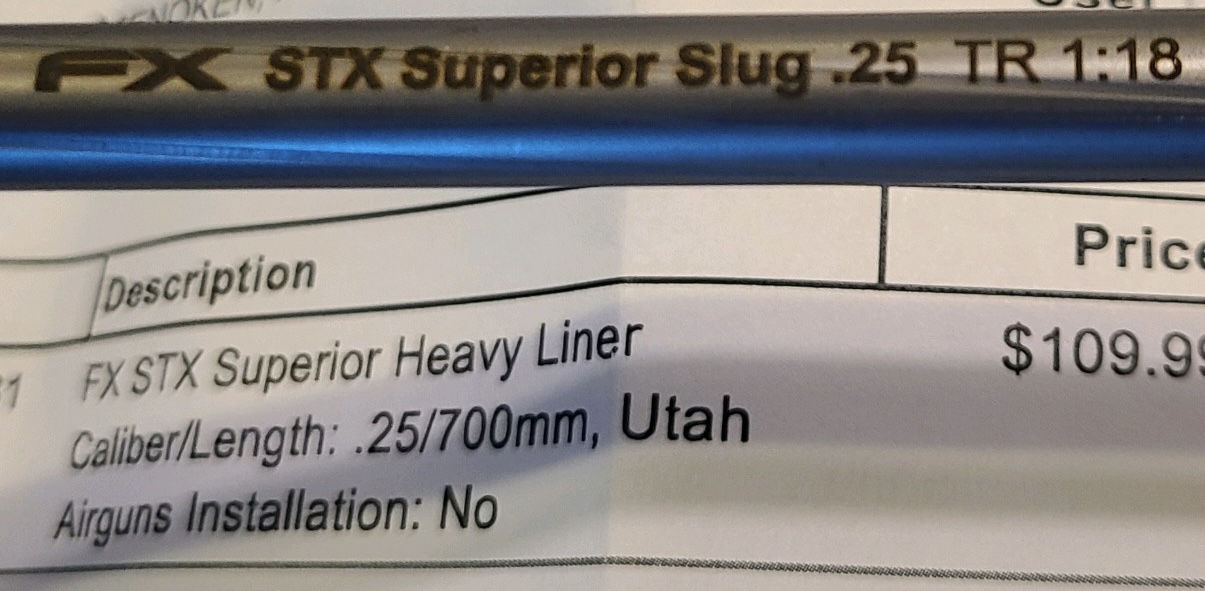

Utah only has the Superior or Superior Heavy option in 700mm .25 caliber.. I ordered a Heavy a few days ago. We’ll see what I get. I do know the Slug A is 1:21, and a looser fit than the older 1:18 Superior Heavy liners. From what I understand the Slug A liners were specifically made for NSA slugs, especially in .25. Perhaps that’s why the NSA 43.5 grain work so well in the Slug A. Stability Factor (SF) in Slug A is 1.51 which is about perfect.
Reactions: mtnGhost
I got my Superior Slug Liner from UA but I contacted them before I ordered and asked if they could send me the Superior Slug liner and not the Superior Heavy Liner.

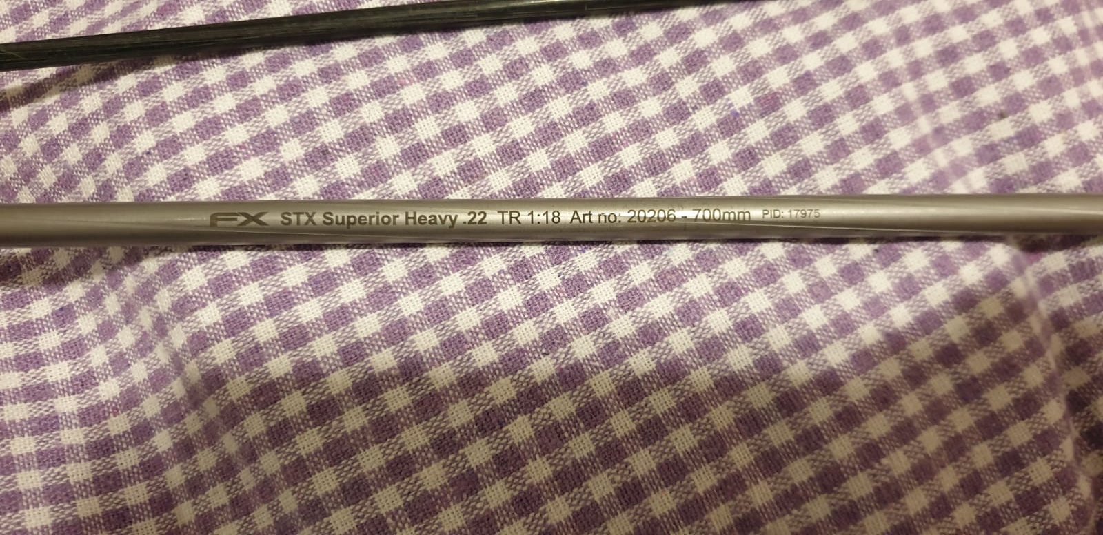

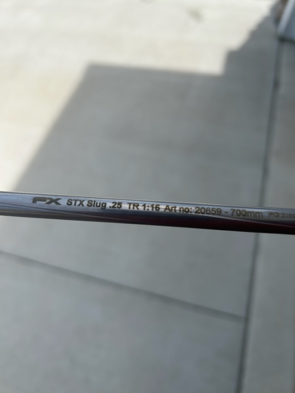

In late June, ordered the FX STX superior heavy liner in .25 cal, 600mm for my FX Dreamline tactical which was supposed to come in a 1:18 TR. The liner I received was stamped "STX slug Liner" with a "TR of 1:16". I inquired about the liner with both FX USA and Utah Airguns, providing them with the Art. No. I was told this was the new superior heavy liner in .25 cal. released by FX. But, I understand you can still get the 1:18 TR barrel. I think FX seems to be going back and forth between TR. Note: the .22 cal superior liner has always been a 1:16 TR.
So I just recently received a replacement liner from FX USA and it is indeed 1:16 TR. The dealers/vendors seem to be totally unaware of this change when asked. I hope to do some testing this weekend. My previous slug liner (1:18 TR) did not perform well above 34 grain, although I suspect it had factory defects. 2-3” groups at 25 yards. 6-8” groups at 100.
Below is a pic of my new liner - initial testing to be completed soon.
Reactions: Impact701
I forgot to mention my new 1:16 TR liner must have a slightly larger external diameter. While previous liners installed quite easily into my carbon fiber sleeve, this new liner is extremely tight, almost like a press fit. I’m not sure if FX intended it to be that way or not. At any rate there is no need to epoxy the liner and CF sleeve given the tight fit. They are essentially bonded with the press fit.

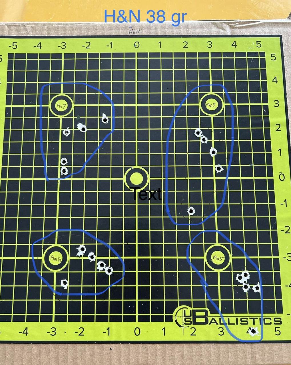

Test groups were 5 shots each, utilizing 2 burners between each setting or projectile change. Velocity was very consistent from shot to shot as measured with my FX Pocket Chrono. Also, wind was very light…maybe 2-3 mph if any. Below are the 25-yard test groups. I didn’t see anything that really stood out as being tolerable except for the H&N slugs at 905 fps. Unfortunately, that group was not repeatable. Also, I started seeing a pattern where I would get 3-4 shots that “grouped” and then 1-2 fliers.
I took my best 25-yard groups from the H&N and Javelins and pushed things out to 100 yards. Results were quite awful and downright depressing. Below are some the targets from my 100-yard testing. You can see from the photo below I did have one exciting group in the lower right where 4 shots grouped well and then 1 flier hit 2” low. Again, I was unable to replicate this grouping.

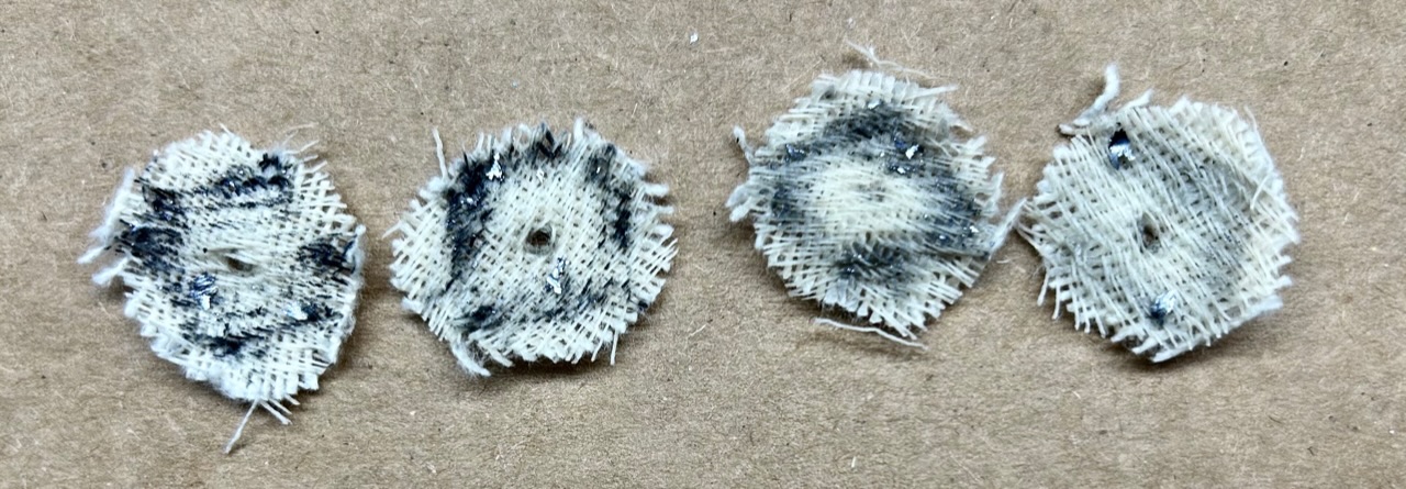

After getting home from the range and feeling defeated I decided to the clean the liner with my Patchworm kit. The first 4 patches were extremely dirty with large amounts of lead shavings as shown below. It took another 50 patches to get the liner cleaned switching between Ballistol and Butch’s Bore Shine to get all remaining lead fouling out of the liner. Some lead particles were extremely difficult to get out and I ended up using a cooper bore brush to “scrub” the liner as the patches and chemicals would not pull them out. I suspect heavy liner fouling is what caused the fliers during testing.
