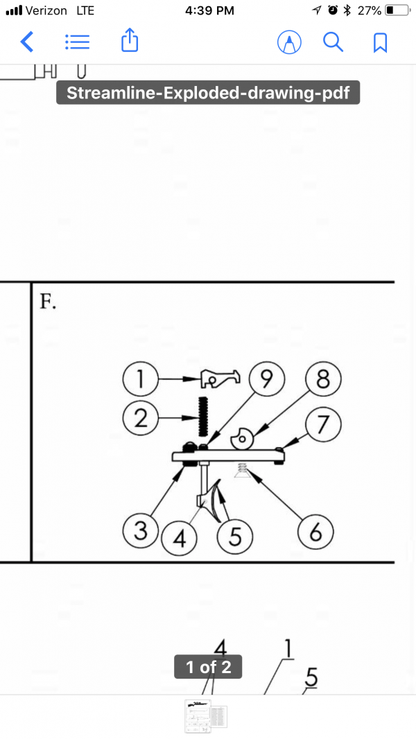

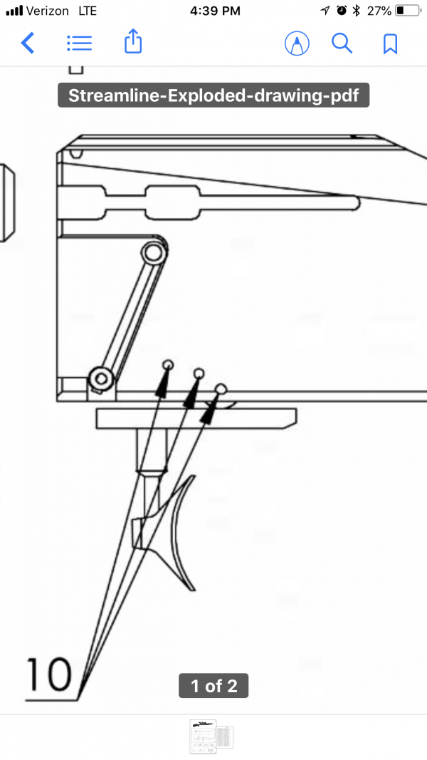

 I just bought me an FX streamline I haven’t had one day and triggered wouldn’t engage I called airguns of Arizona they told me to call the new FX airguns USA I called them their service tech told me to remove my stock there are three pins right by the trigger he said remove the one closer to the barrel the one in the middle and then hold the lever action to keep it from engaging the hammer and slowly remove the third pin closer to the end once I did that the gun freed up it turns out the hammer got stuck they were going to send me two washers to put on that pin on both sides of the hammer to center up the hammer to keep it from happening again Took me less than 4 minutes to fix on the Picture of the trigger Parts it was number one and these are the three pin to have to remove be very careful because the gun is live and when removing the third pin he can fire make sure it’s pointing i parts it was number one and these are the three pin to have to remove be very careful because the gun is live and when removing the third pen it can fire make sure it’s pointing Away from you and anyone else
