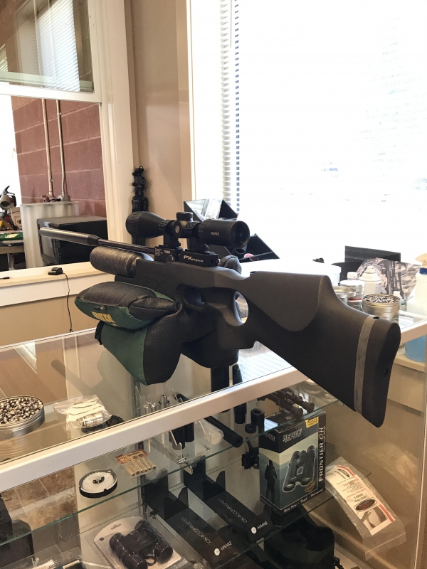

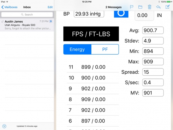

I just bought a 500 Royale with a synthetic stock and had them run some JSB Exact King 25,39's through it and this is the 3rd mag shot string. Right in line with FX specs.

Congrats on the 500 Royale. Look forward to hearing more about her in the future.
Yep Thanks, although I went the Royale route I still have the Streamline on the list as my next If I get another .25....
