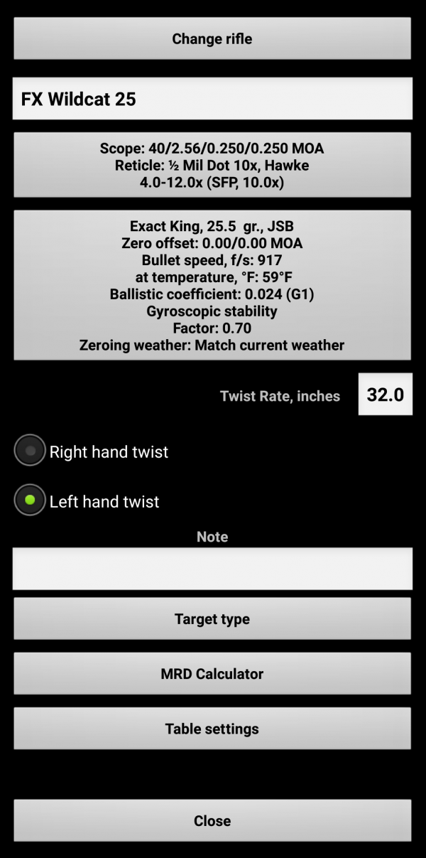

Hey guys, I figured I'd post this in here since it's a question related to ballistic calculators/computers. I'm new to using ballistic software, and I'm trying to get Strelok Pro setup on my phone. I have a few setup parameters I wanted to double check with someone more knowledgeable.
1) Twist Rate
Does anyone know what the twist rate is on a fullsize FX Wildcat Smooth Twist barrel in .25 cal? I did some searching and one guy mentioned his Bobcat was 1-32 left hand twist, and another person mentioned he thought it might be closer to 1-40 twist. Assuming either of those numbers are in the ballpark of reality, is this how I would enter 1-32 left hand twist into Strelok?
2) Determining Scope Height
I took the following measurements to determine scope height. Was this the right way to go about it?
Is there anything else that I might have missed to setup Strelok for airgun use? Thanks for your time!
1) Twist Rate
- Measure scope diameter and divide by two - 2.21" / 2 = 1.105"
- Measure barrel/shroud and divide by two - 1.1" / 2 = 0.55"
- Measure distance from top of barrel shroud to bottom of scope - 0.90625
- Add them all together to determine scope height - 1.105 + 0.55 + 0.90625 = 2.56" Scope Height
