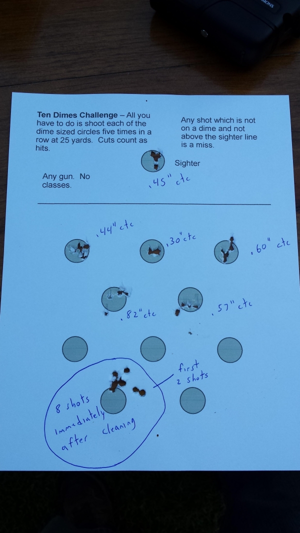

The reason I started this thread is because when I noticed accuracy fall off I unscrewed my shroud end cap to make barrel cleaning easier and noticed quite a bit of lead built up in the last inch or so of my barrel. I've never seen this happen with any of my other guns with traditionally rifled barrels so I "figured" it was fouling. Maybe it's a normal smooth twist thing and if it is I'm cool with that but if my gun can be improved somehow I don't mind spending a little just to make sure I completely enjoy my very expensive airgun.
I think I worded my initial post wrong. What I should have asked is if what I'm seeing is normal? Fouling just sounds like a bad word and it looks like I'm saying I'm not happy with my gun/barrel. That's not the case at all, I think it is a great gun and if I just have to clean it once in a while than it is what it is. Time will tell I suppose.
For what it's worth, I shot the Royale new without cleaning. It put maybe an entire tin through it and notice it had a few fliers. Hoping to cure that I checked the barrel. Same thing. The last 2 inches or so of the rifling was really crappy. I cleaned it and reinstalled. The fliers went away, but so did a good bit of the accuracy for about 100 shots. Then it went back to being a one hole gun again.

I just shot 2 groups today after work at 30 yards. 1- 5 shot group that ended up being about 1/2" because my first 2 shots were low (something to do with the reg but that's normal I think after a refill). My second group it stacked the remainder of my 2 magazines (11 shots) on top of each other in a single hole. Looks like pulling through a few patches solved my flier problem!

I didn't get it super clean. I pulled a couple of barely wet patches through then about 10 dry patches until they came out clean. That fixed the fliers for me. And that is sort of weird since I think most of my other guns shoot better after a 100 shots after cleaning. Just like the Royale did. Once the barrel is "leaded in" it shoots great.
