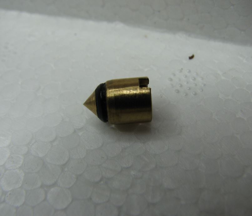

The fill port has an o ring that always leaks.
Funny you should say that - took the Monsoon out for a bit of plinking today, filled it up and the fill port valve let it all out again
So instead of having fun I spent the whole afternoon making a new part, all in delrin as it should have been instead of this complicated mix of brass and o-ring
The same part is used in the Typhoon, Cutlas, Cyclone, Revolution and maybe earlier, own them all and they all leaked because of this silly thing, the o-ring get compressed over time so the brass part rests in the alu seat
