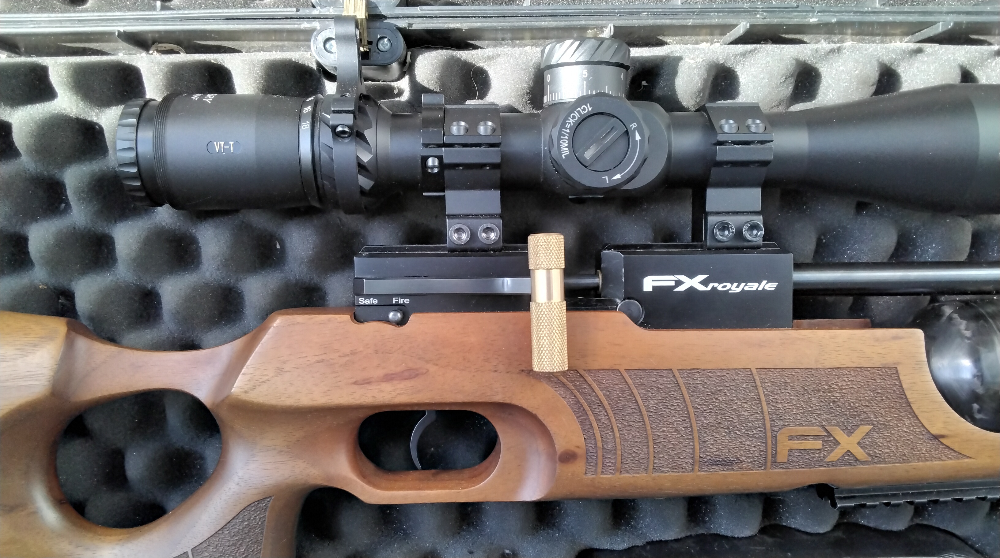

I two finger, sometimes 1 finger cock all of my PCPs. I really don't like the shallow knurling on all of them with exception for my Uragan 2's African Air Ordinance upgrade. That AAO handle has deep texturing a feels great. A 3D printer filament called TPU came to mind. I use it all the time. It's virtually indestructible, feels grippy even in 30 degree weather, and is oil and grease resistant. So I started designing some handles and testing them on various guns.
The handles are not flexible length wise. The FX handles have a M3 x 45mm running the entire length. The two piece RTI handles have a M3 x 40mm screw through the top piece and a M3 x 25mm threaded standoff in the bottom piece. Here's some installed pics:
