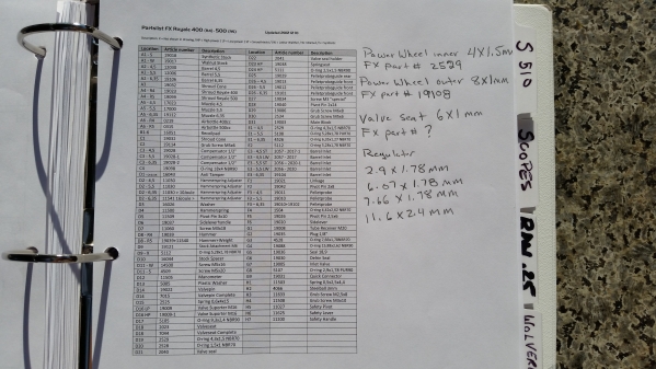

Long story short, the reg. nose should be hand tight, to just let it sit against the ridge in the reg. body. The o-ring will provide the seal. Hold reg. body with a loose grip between your fingers to tighten, when it starts to slip through your fingers, it is tight enough.
O-ring sizes:
2.9X1.78 (1x)
6.07X1.78 (1x)
7.66X1.78 (1x)
11.6X2.4 (2x)
