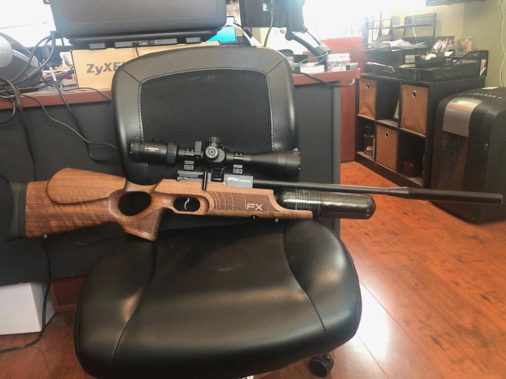

      I just replaced the gauge, valve seat and valve pin in mine which wasn't that hard to do. I also changed out the cocking lever and added a carbon fiber shroud over the barrel which I recommend for all Royale owners.

        Thanks I got it used which is hard to believe when looking at for steal which included a 22 LW barrel and 0db 160c moderator so I can shoot either the ST barrel or the LW if I wanted to give lightweight slugs a try for example.
        When I had my personal Royal 400 .22 I machined a 24" BSA hammer forged barrel in it and it became a special gun and extra ordinary shooter with a large variety of pellets.

        Sweet looking Royale. I absolutely love mine and I’m never getting rid of it. That CF shroud, where did you get it? It looks like a nice upgrade.
        Thanks
        flynviking thanks yes it's a great gun and it has a huma regulator in there as well which I also recommend way easier to adjust than the FX one. The carbon rod is great and super easy to install you can get one here https://www.amazon.com/gp/product/B07BGBQF8T/ref=ppx_yo_dt_b_search_asin_title?ie=UTF8&psc=1. You don't hear much about Royales theses but they have been out for over 10 years and you never seem that many coming up for sales on the classifieds like you do most of the more current models so that has to tell you something. I would get the cocking handle too it's while you're in the upgrade mode!
