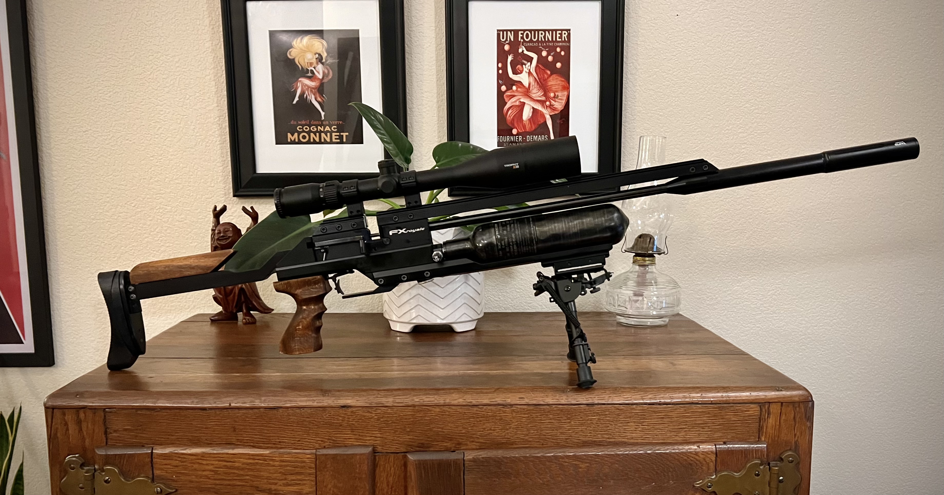

FX Royal 400- Like I needed another airgun.

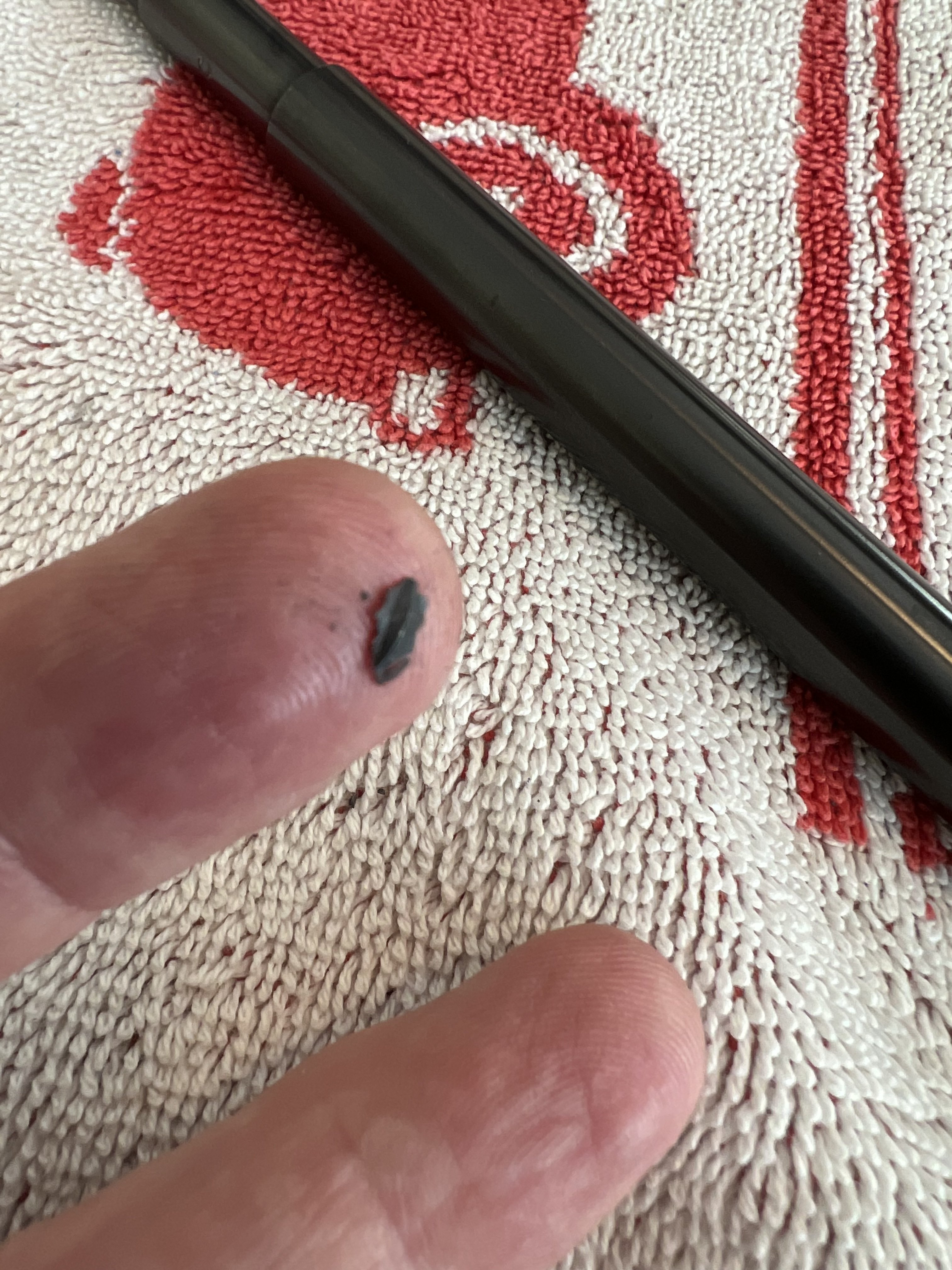

Looks pretty rough where the pellet enters. Lead shavings laying there. That may need some work. Seems like you might get occasional flyers.
It was all built up lead. I have never seen a rifle this dirty from just usage.

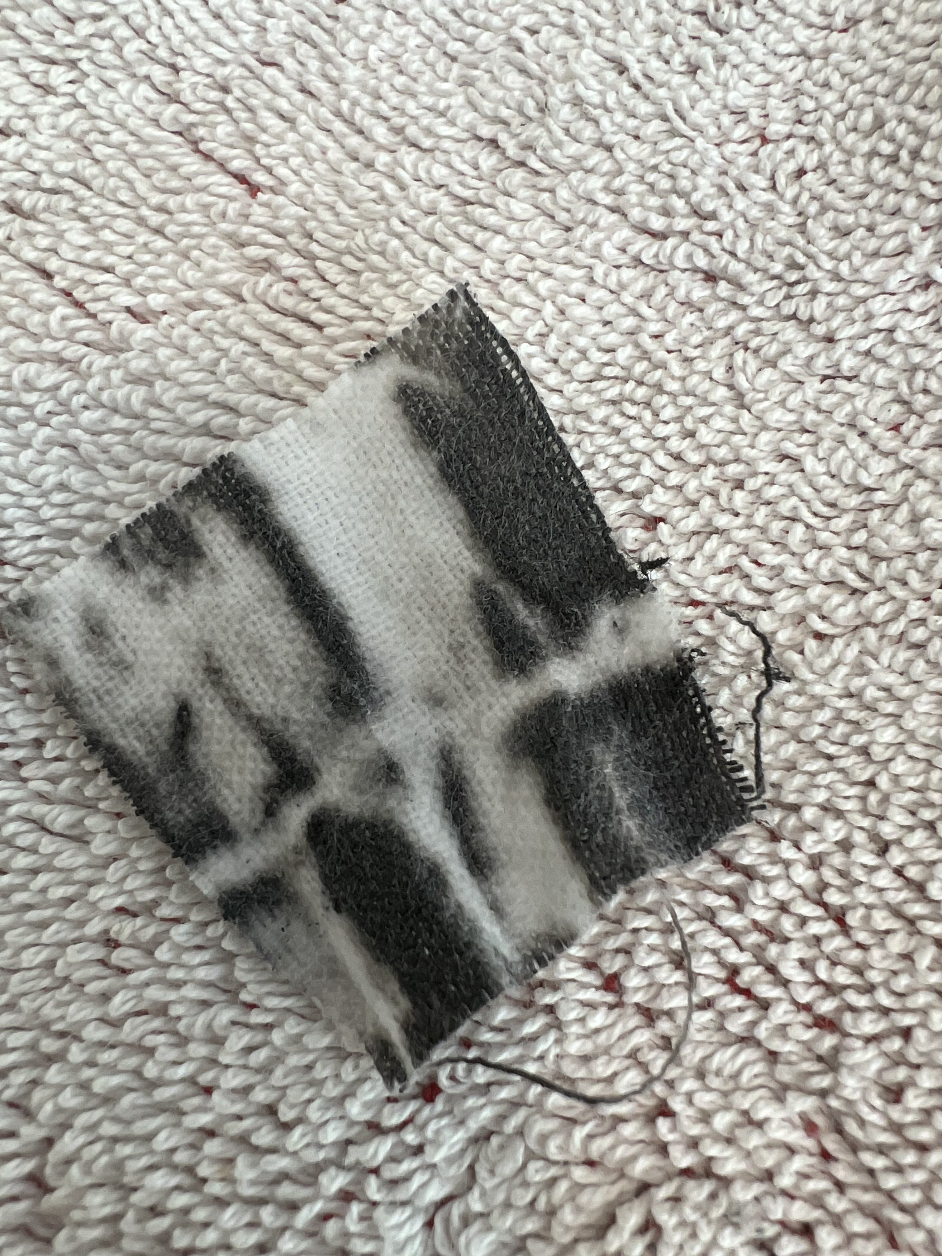

A few more pictures. Chunks of lead were falling out when I pulled the shroud out. The PO was a firm believer in not cleaning the barrel if accuracy is good.😂 The first patch was saturated with enough lead that I set it aside to melt down.

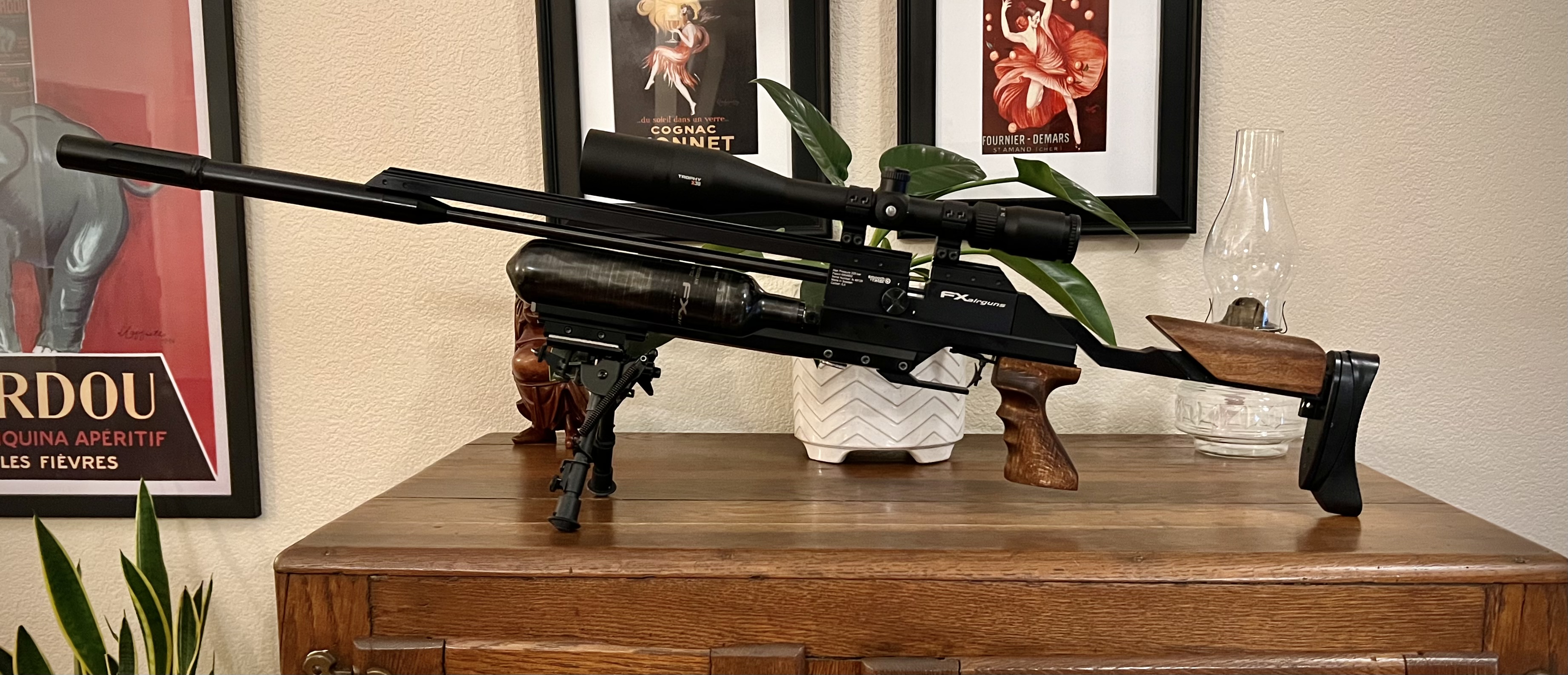

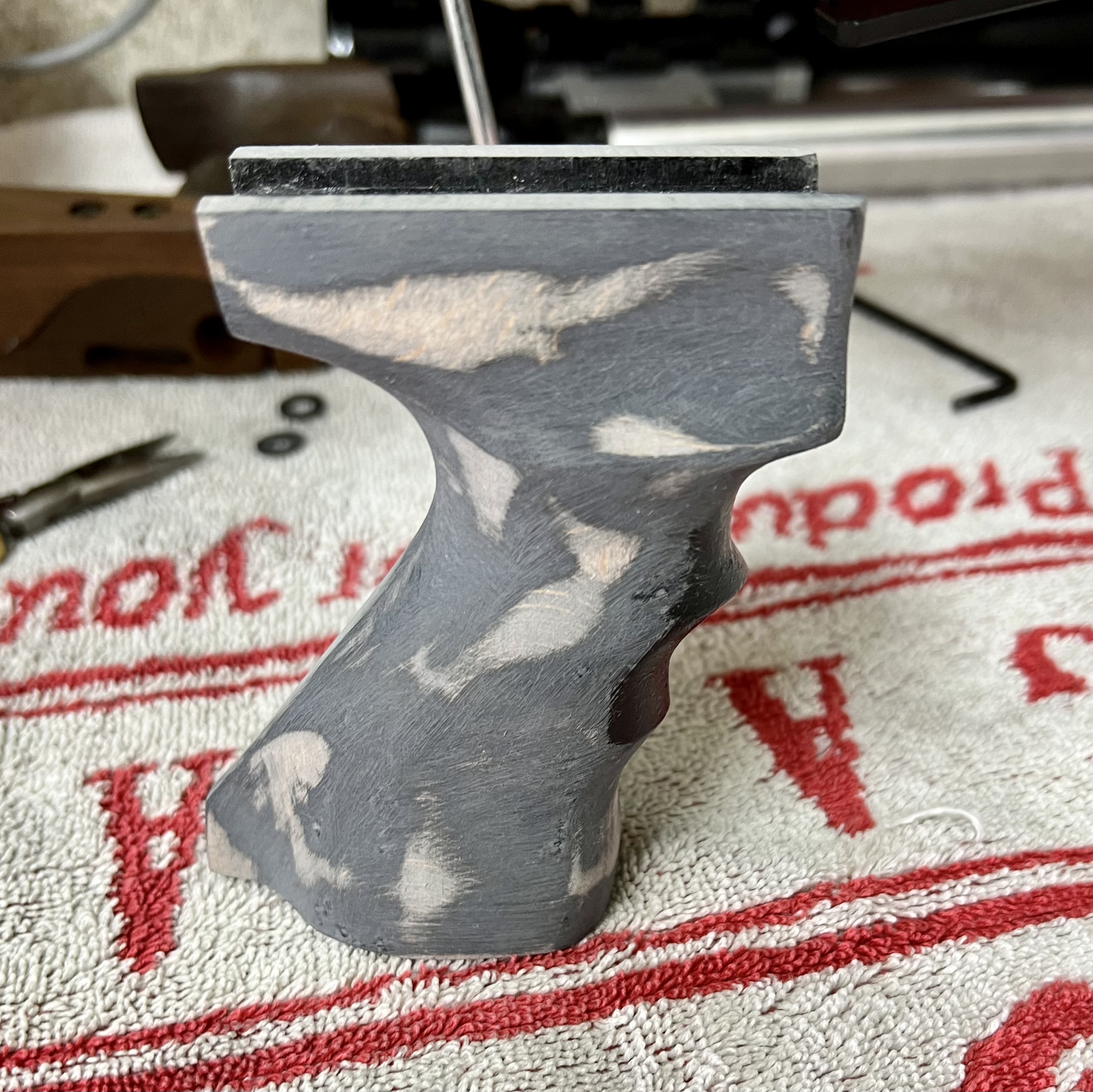

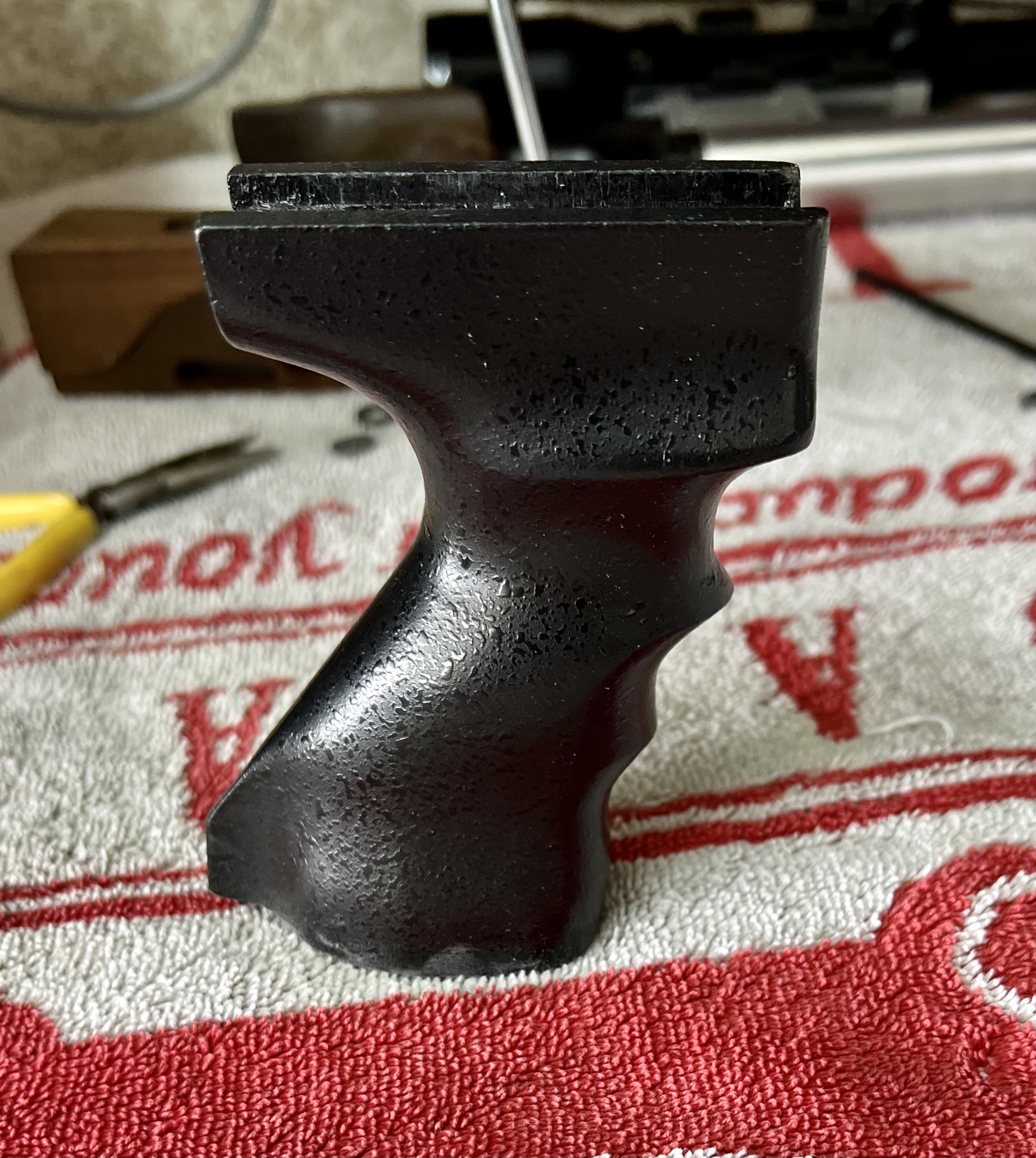

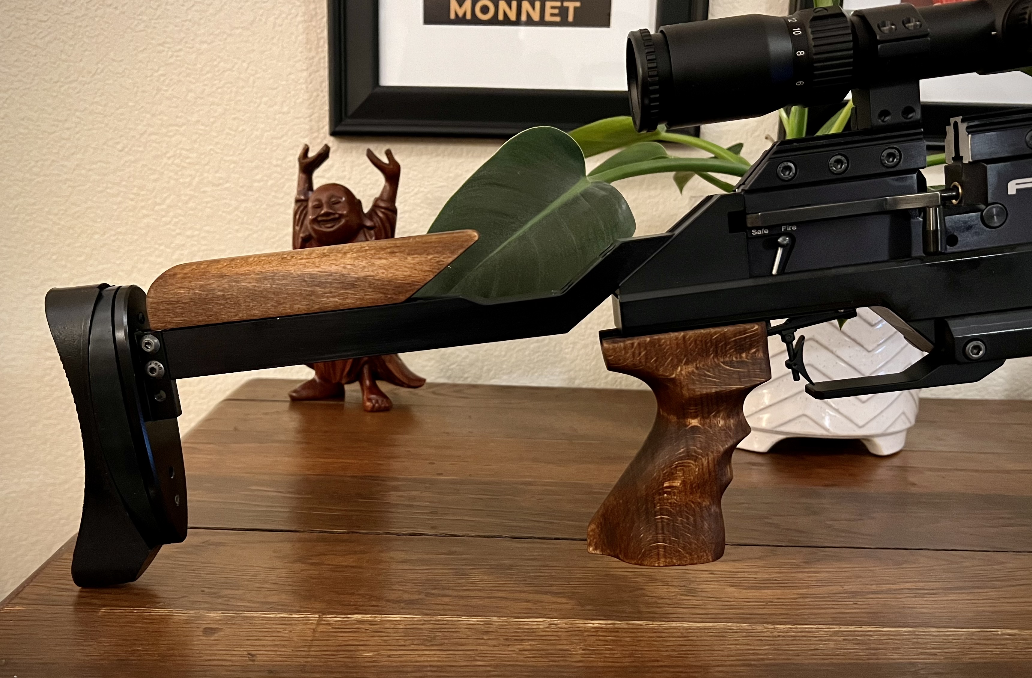

The factory truck bed texture had to go. I knew staining the wood and not getting blotchy color would be a challenge but I went with a dark walnut and oil finish. I don’t think the squirrels will notice it isn’t perfect.

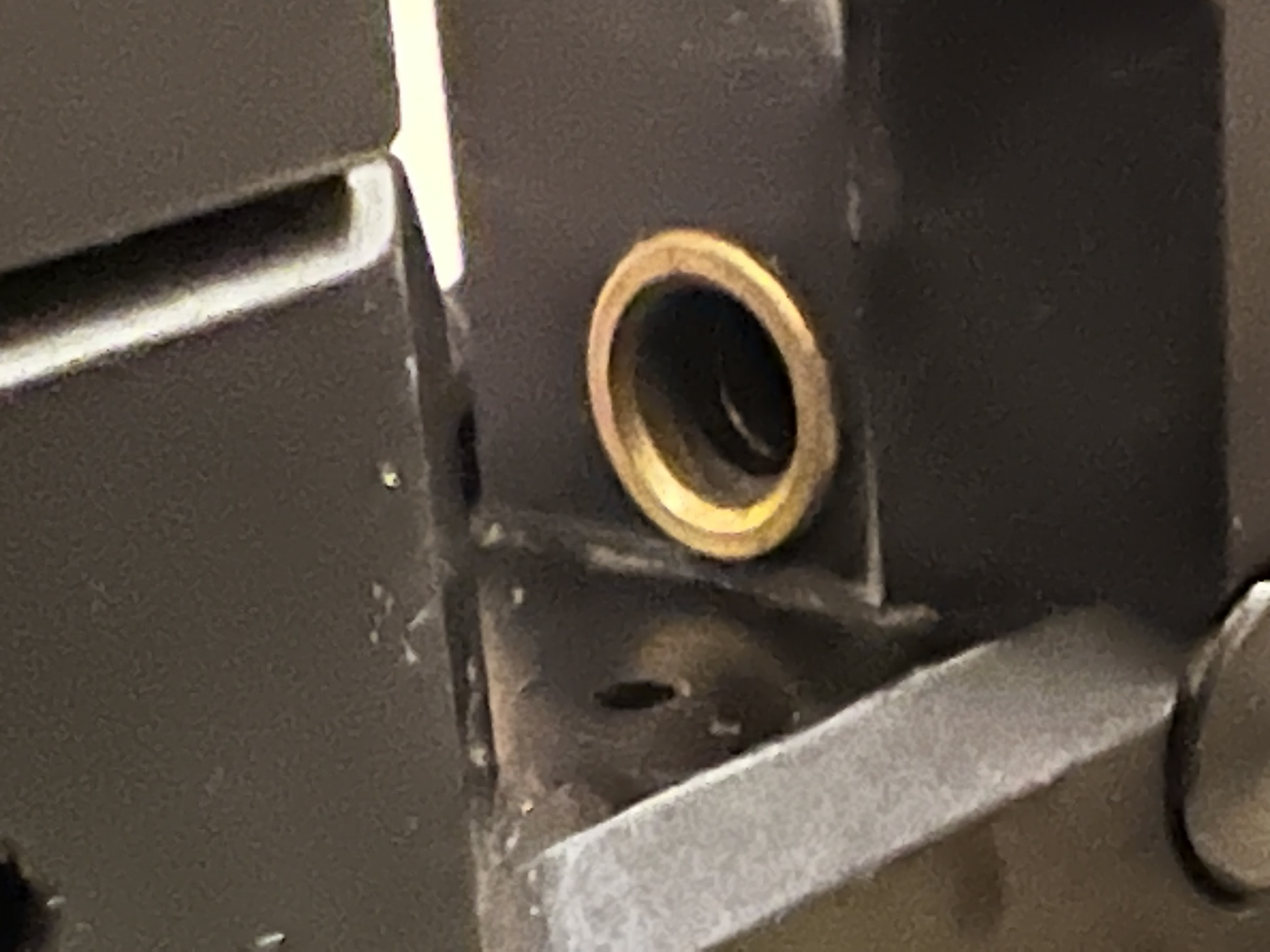

AOA came through on the trigger pin. The tech was kind enough to go through his stash of parts and mail one out to me. Awesome service!
