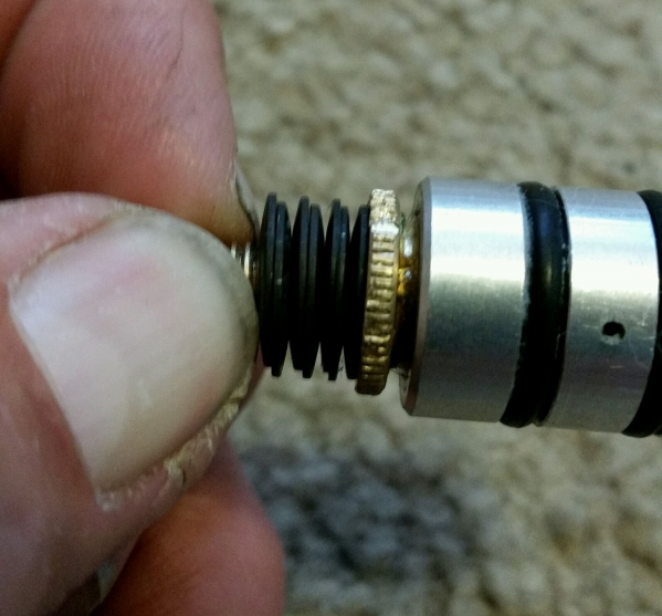

Here is what I found with my WC regulator. The difference in OD of the piston and the ID of the belleville washers allows the washers to "slide" between cycles. With the washers not "centered" all the same, the stack length can change. If the measured stack of washers is not the same each time the the pressure is different. Notice in the below pic how I can move the washers. I get a measurement of 6.16mm ID for washers and 5.68mm OD on piston. Then add to this the piston is threaded where the washers ride.

"BigTinBoat"AirGunShooter - if I were you I would never take those FX guns apart.
Although I agree it doesn't win the beauty contest, those BV washers are unlikely to cause issues keeping the the very minor movement they make in mind.
We are talking about tenths of mm's of movement here, and I have seen a lot of FX reg'. BV washers which were stacked like this, but they never caused any issues.
However, I always put them back in line with a Channel Lock (or Knipex in EU :p ) while I'm at it.
B.t.w, that brass knurled end looks rather marred :-o
Bigtinboat you have hit on the exact problem with FX regulators...there is nothing to keep the stack of Belleville washers straight up and down, and this allows them to slide apart. Another problem is their edges on the cupped side are not ground flat...it would only cost just a few cents more for them to buy the Belleville washers that have the edges ground flat so they make better contact when compressed and relaxed, so as to not slip apart like that. In the Huma regulators the stack of washers cannot get out of place like that because they are contained in a round tunnel that is only just slightly larger than the washers themselves. I learned this from Robert Lane by the way...another of the worlds premier air gun regulator makers.

I have changed the output pressure setting on Ninja paintball regulators and when you get to the higher setting 2/100's of a MM (in the spring stack) can make a change of 100psi in the output. At 1200psi a difference of 2/10's could easily make the output change 100-200psi.
