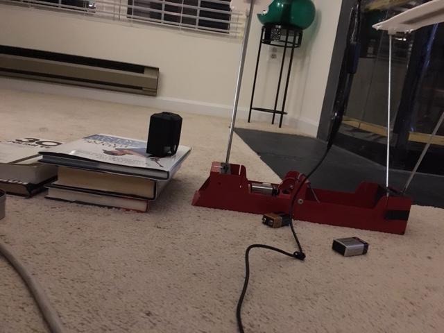

I setup my old shot-up F1 chrony with LED light-kit and the FX radar placed right before it elevated on books inside the room. So the difference in distance between the two chronies is about 1 foot, but the beam of the FX radar probably only measures the pellet further down the flight path, so the actual distance may be several feet of difference.

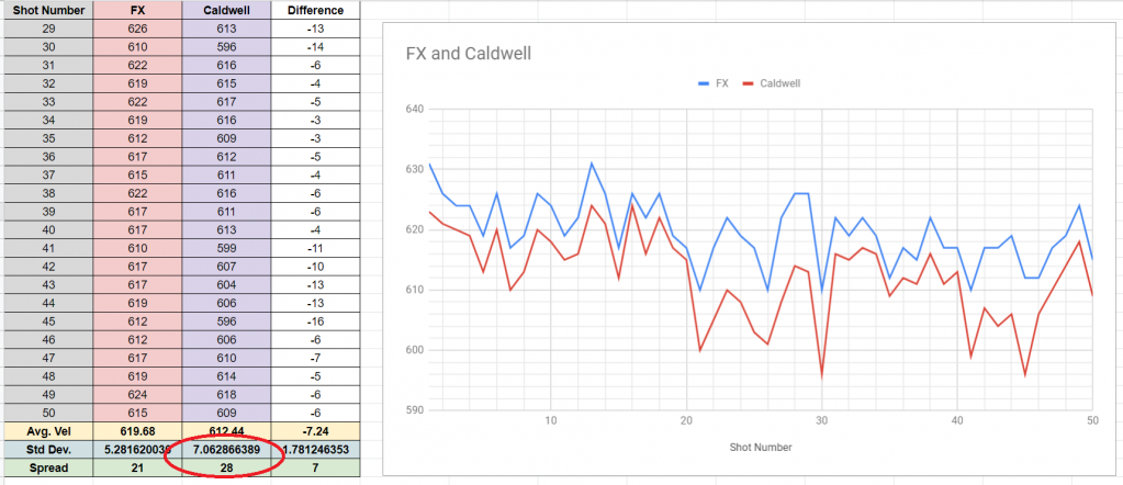

Just to add my evidence to the discussion...
My biggest gripe is that placement of the FX is so finicky. It did not like being directly underneath the barrel of my rifles and seems to prefer to be set on the table under the muzzle. Since the FX had the first chance to read the velocity (it was closer) my expectation was that the FX would read slightly faster than the my Caldwell Chrony. As you can see in the 3 charts below, it wasn't until I lowered the FX that I got the expected results. Even a couple inches below the barrel resulted in some weird readings.

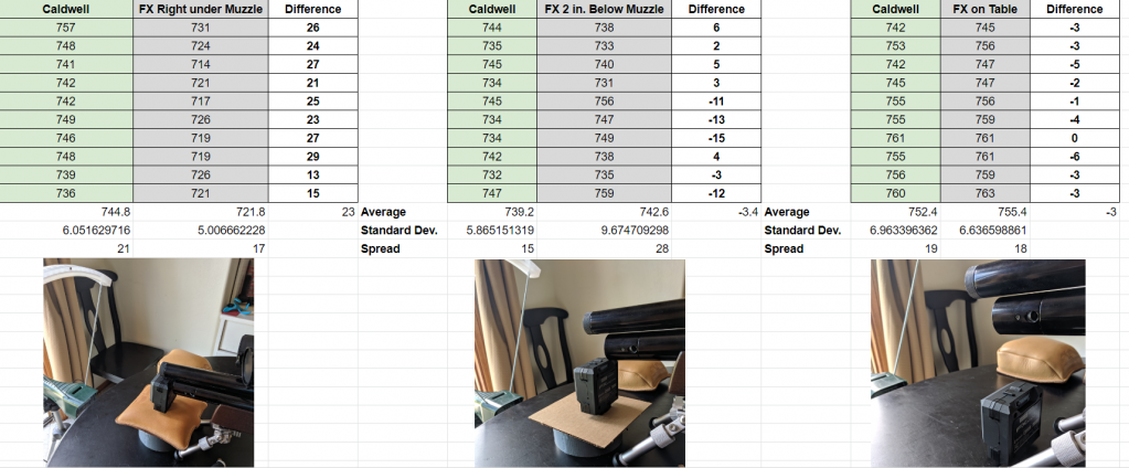

Agree. Good trial but hard to ascertain what is going on. Looking at the numbers in the tables above by mmahoney, it appears that the FX is as consistent (high to low reading range) as the Caldwell. How to know which is "more accurate" as to an actual velocity number? Maybe the FX is giving the "most accurate" number as to actual velocity and not the Caldwell. Hard to know without an outside standard.
The variation in the FX by position is something to be considered but I wonder whether moving the Caldwell (angle to bore) slightly might produce similar results. Was the Caldwell position in relation to the rifle changed during the above measurements?
The Caldwell stayed in the exact same position. I'm pretty confident in it's consistency, but not it's accuracy. All readings could be 20 fps fast or slow for all I know. The FX seems like it can be consistent, but I'm noticing that the FX seems to spit out a lot more duplicate readings almost like it is less accurate.
I don't believe the FX is giving the more accurate numbers. Mostly because any slight change in it's location causes significant variation. Here is another couple shot strings I made. This time I tried putting the chono in the same spot both times. The Caldwell was kept in the same position both shot strings and was never touched. The reg pressure on the gun was changed and that is why the velocity on the second string is lower. However, notice how in the second shot string the velocities for the FX dropped for some strange reason in relation to the Caldwell. Again, I TRIED to put the FX in the exact same location as the first shot string.

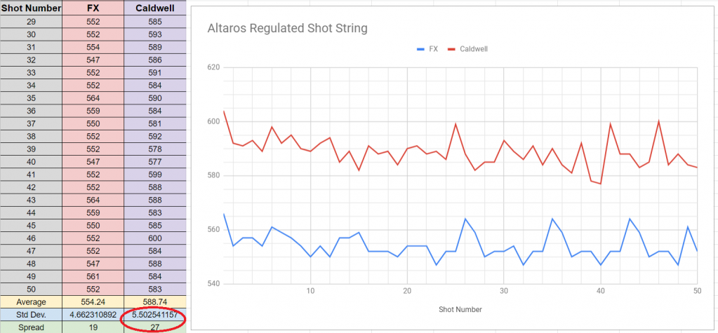

Nice work trying to compare the devices. I can't see that a duplicate reading necessarily indicates less accuracy. It certainly might but it also could be that the shots were actually duplicates. It seems that to compare how the change in position effects the readings you should move both devices each time. Inconvenient for the larger unit but that is the advantage of the smaller device. If moving the Caldwell produced similar changes in readings then that would seem to strengthen the utility of the FX.
If the FX proves to be too position sensitive for shooters to easily get reliable readings then it's usefullness would seem to be greatly lessened. I did note that the video Giles posted about the FX did mention exactly this issue, that some of his guns needed different positions for good readings with some "below the muzzle" and others back from the muzzle.

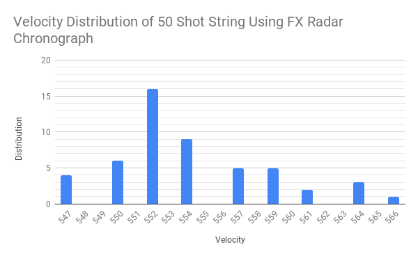

They could have been duplicates but if you look at the last 20 shots, 11 of them were 552 fps. None were 551, or 553. With pellets straight from the tin, that kind of consistency strikes me as odd. I almost get the feeling that instead of reporting an accurate measurement that there is some rounding going on. These were taken with the radar at the most accurate setting.

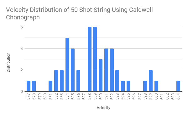

The results were really bugging me so I did a lot more testing today. First I ran a velocity distribution for the entire shot string. The gaps between the readings are not a good sign of accuracy. This is the same shot string measured by the FX and the Caldwell....The distribution of the Caldwell looks correct...The FX not so much.
1562986205_16673474395d2946dd5839f7.08893046_Velocity Distribution of 50 Shot String Using FX ...png
1562989701_5776690005d295485bbfa31.31757202_Velocity Distribution of 50 Shot String Using Cald...png

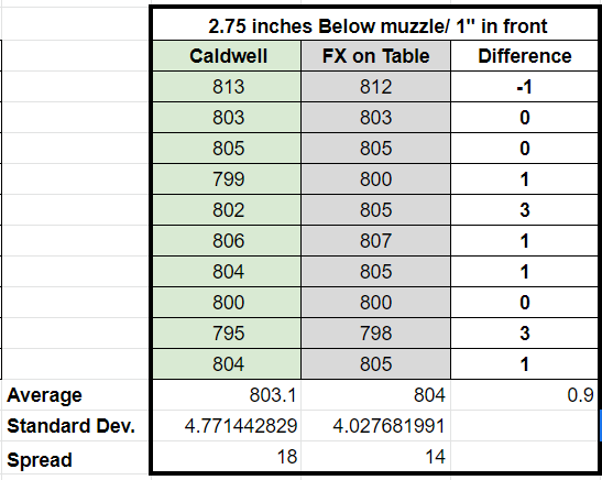

Then I shot hundreds of pellets through both chronographs again with the FX moved to different positions. I've found that moving it forward or backward along the muzzle has little impact, but moving it closer or farther away from the muzzle makes a huge one.
Summary: My FX Radar likes the top of the chrony to be located 2.75 inches below the center of the muzzle opening. Being an inch in front, flush, or behind the barrel makes little difference. The unit happens to be 2.75 inches tall making estimating the distance easy. If too high or too low, the velocity reading seems to be reported too low. The problem of lots of duplicate velocities and gaps in the those velocities continues, however. My conclusion is that the Caldwell is more accurate.
