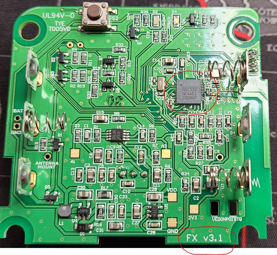

This is something new, FX radar ver.3.1

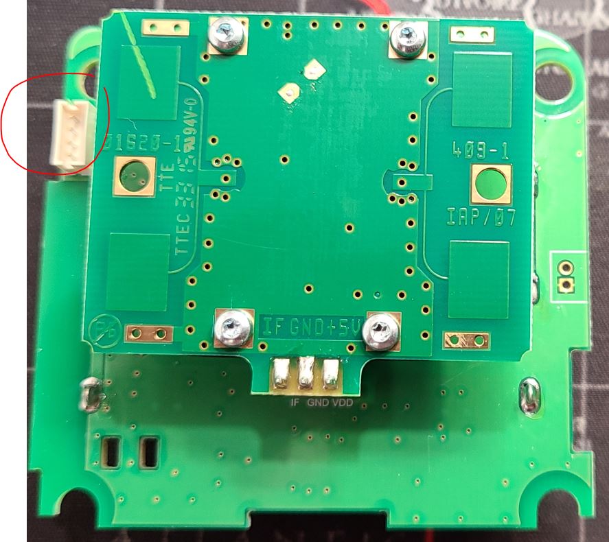

The white 4-pin socket on the left is a serial port. You can hook it up and monitor raw data and software operations. Could also interface with MATLAB if you extract the velocity reading line.

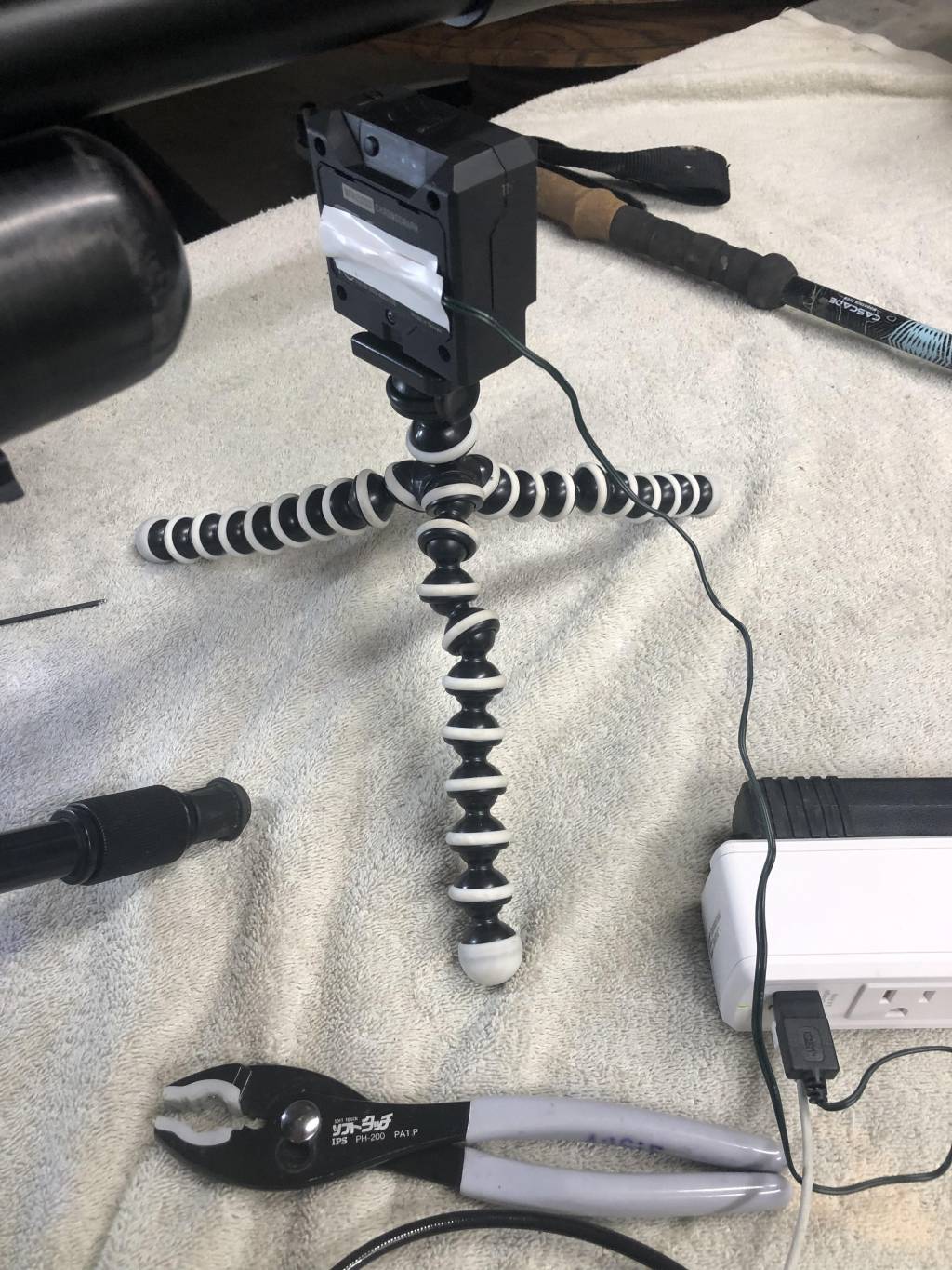

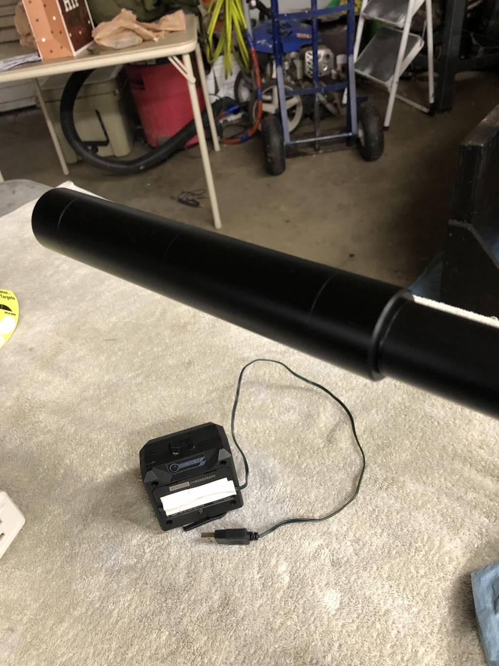

Sorry yours didn’t work out. I just shared with another member ever since I did this mod with the three tied in batteries, now plugged in, my chronograph never misses a shot and I never have any doubt if the readings were true or not due to weak or deteriorating batteries. I still thank you for the tip/link, lol!
the great thing about this mod is it isn’t permanent and no hacking involved. I can easily go back to using rechargeable batteries if I ever use the chronograph in areas without immediate power.
I’ve since change my set up from this pic snd no longer plug into a cord but instead to a rechargeable battery pac, that way its ready for remote use anywhere
