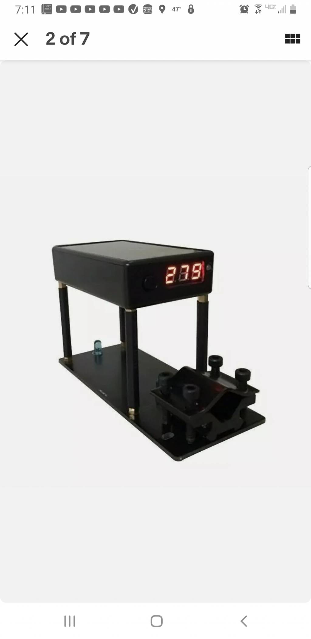

I feel they are at least moderately overpriced. And I dont really like the fact that they dont work without a smart phone. I'm kind of a simple old school guy...
I picked up this little fellow on ebay for 20 some odd bucks. It is truly phenomenal! Yes, it reads in meters per second, but I put a piece of tape on the top of mine in 5 meter per second increments and it gives me a very good and quick reference when I am tuning. And for 20 some odd bucks it just does an awesome job!

Moe, yeah I can relate. I have both the FX and the cheap clamp-on...and I use the cheapie far more often. They each have their pros and cons but what I like about the cheapie is that it NEVER misses a reading. So for example if I'm checking a regulated PCP for potential effects of regulator creep after being idle overnight, I can't risk missing the first shot and the cheapie never lets me down. Never. Sure, it feels kinda sketchy in the hands and it may let the magic smoke out the next time I pick it up. If it does, I won't have one regret and I'll turn around and order a replacement.

A few GTA members have been endorsing this one:
https://www.amazon.com/ACETECH-AC5000-Airsoft-Shooting-Chronograph/dp/B072JSP98J/ref=cm_cr_arp_d_product_top?ie=UTF8
