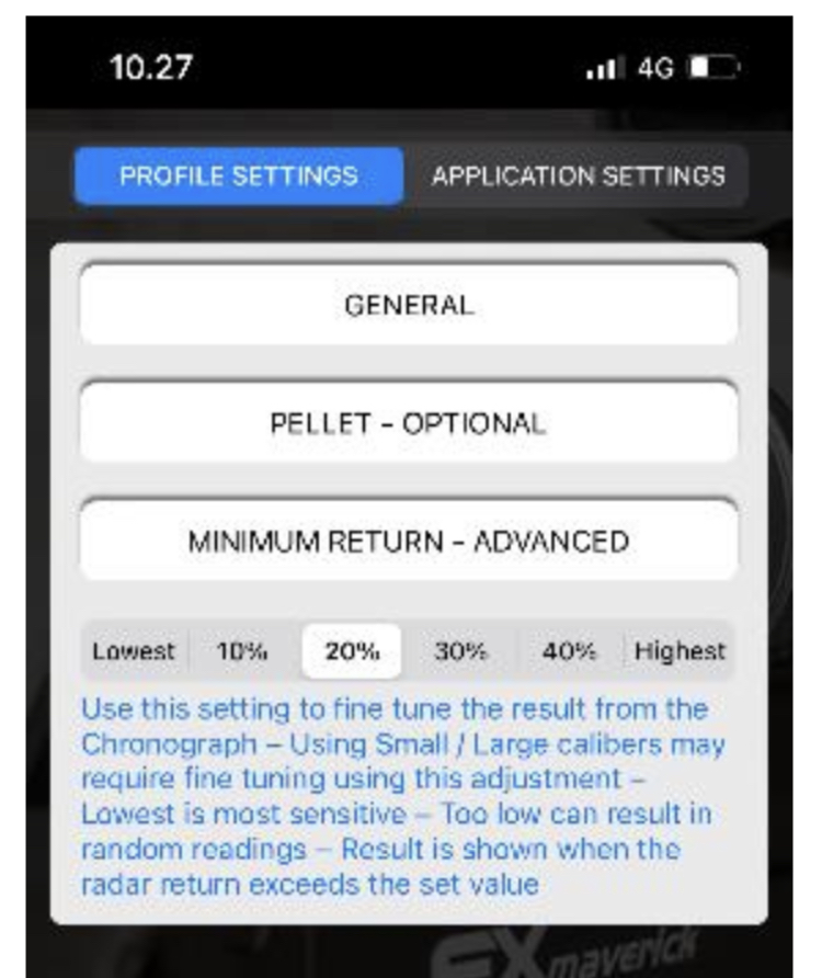

going to the 'Minimum Return' setting under Profile Settings/General in the app. Reduce this setting until you get all your shots being counted.
What he said. ^^^
Screen shot from manual:
For .177 cal pellets I have mine set at Lowest to capture all the shots. No issues with phantom readings.
