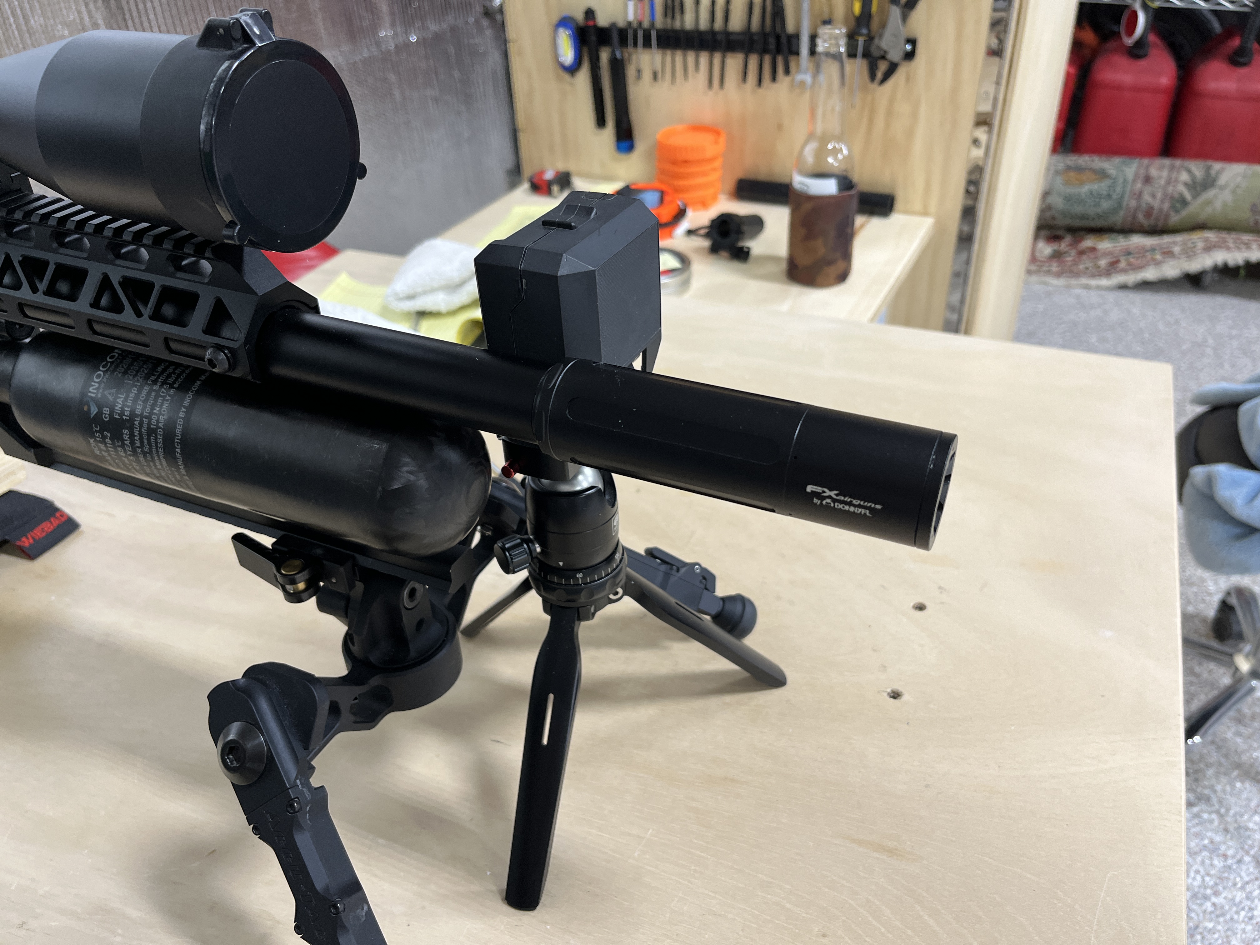

Placement is the key to accuracy and consistency. I place mine at the muzzle of the rifle (NOT THE EXIT FROM THE MODERATOR!) and it works great.
