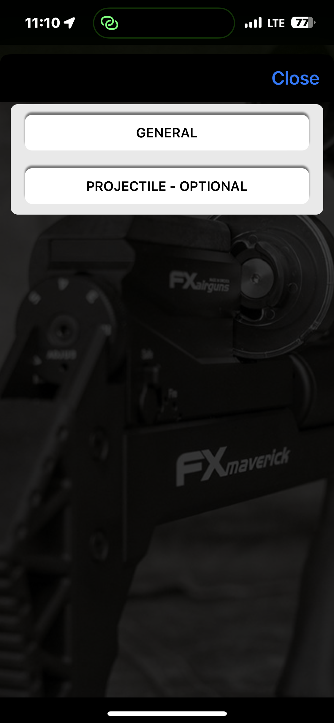

i dont have the v2 but i do have the first version.
im guessing the app is the same?

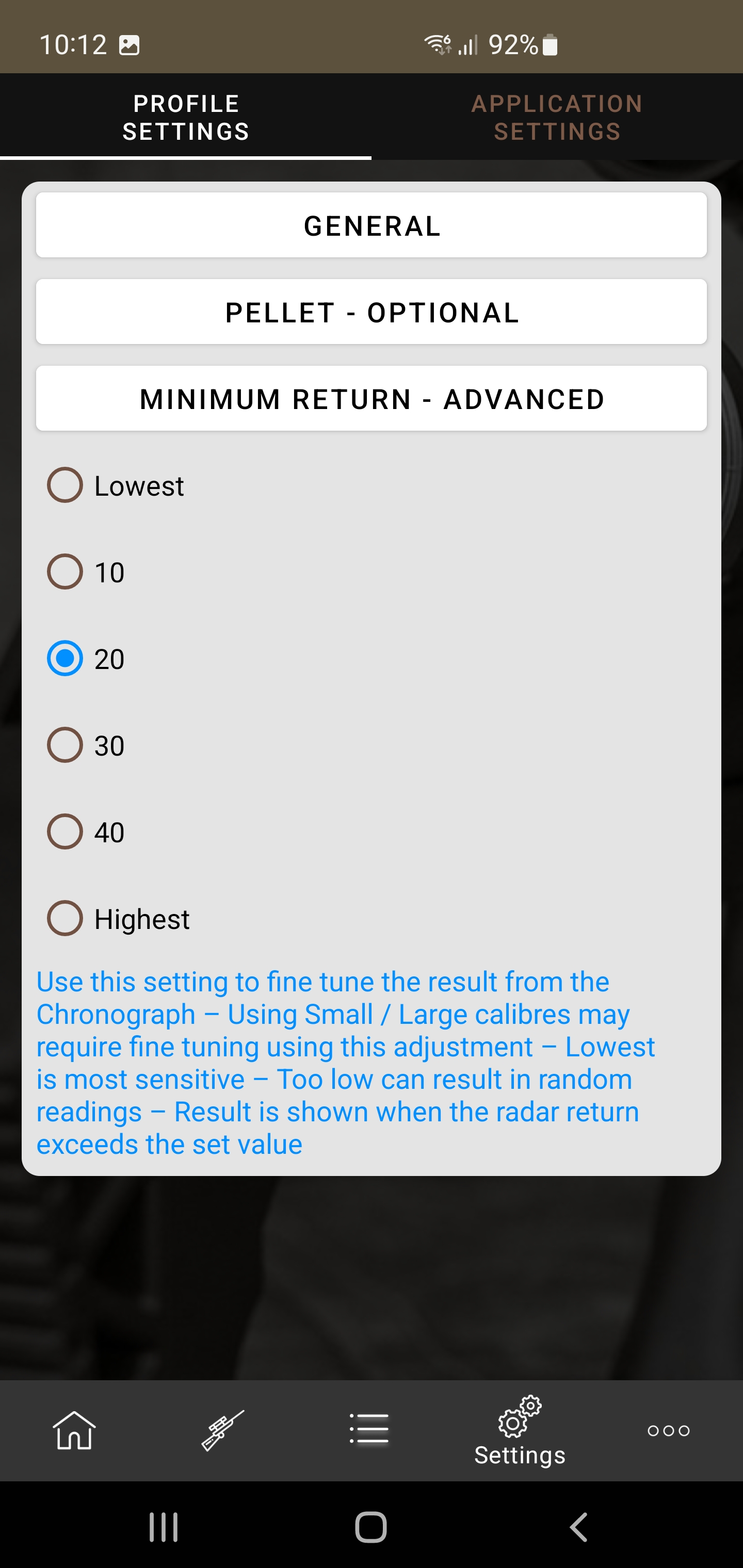

go into the settings and lower the minimum return setting,(pic included)
right on the minimum return settings page it says you may need to lower the setting for small calibers.
