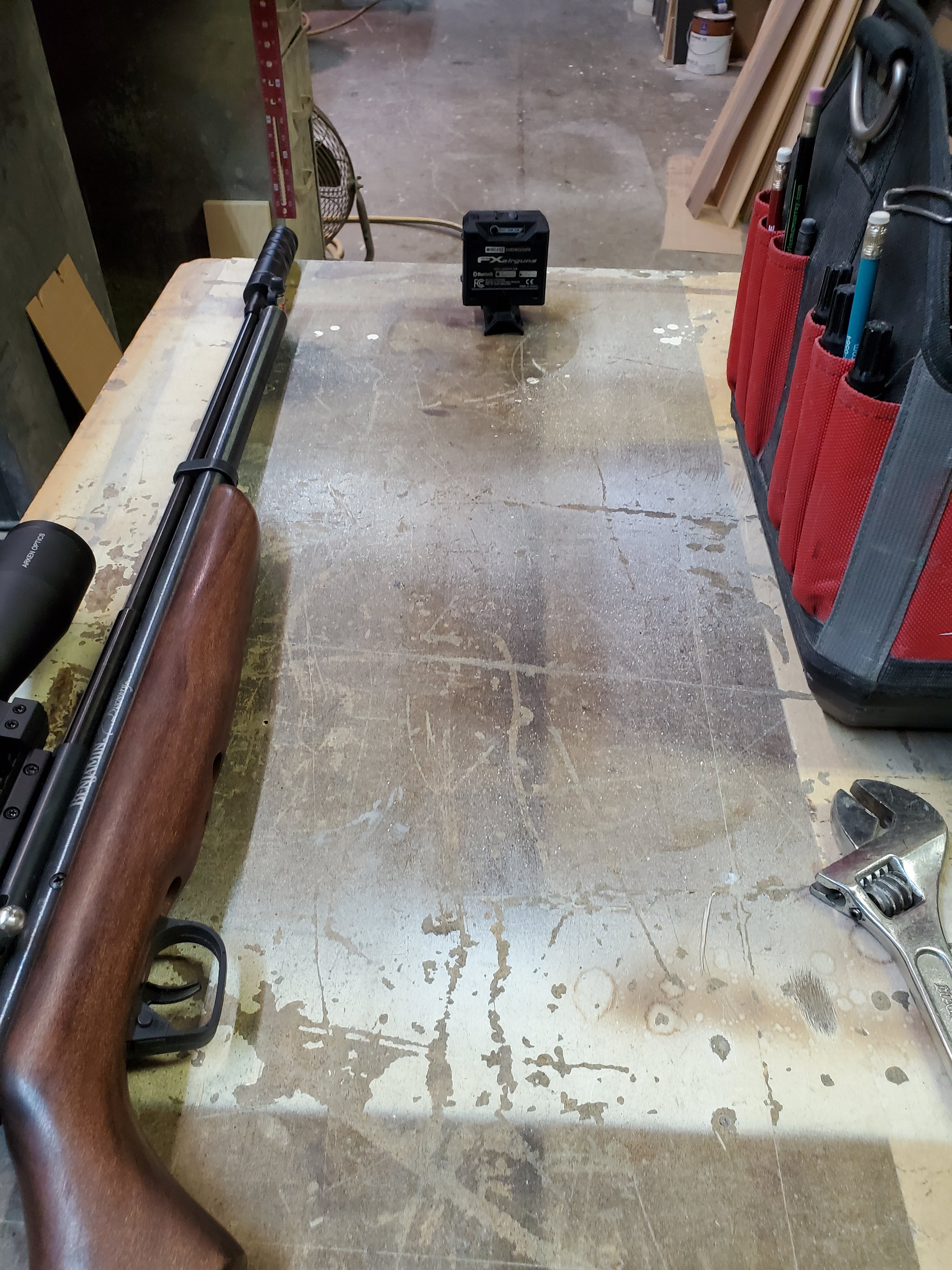

I just set the chrono on the bench, and ive used it sitting on an scba valve even. It's a radar, it doesn't have to be on the gun. This way I can zero and chrono at the same time to collect as much data for my effort as possible. Sure mines a v1 but that doesn't effect the scenario. As long as your lane isn't too cluttered it does just fine.
