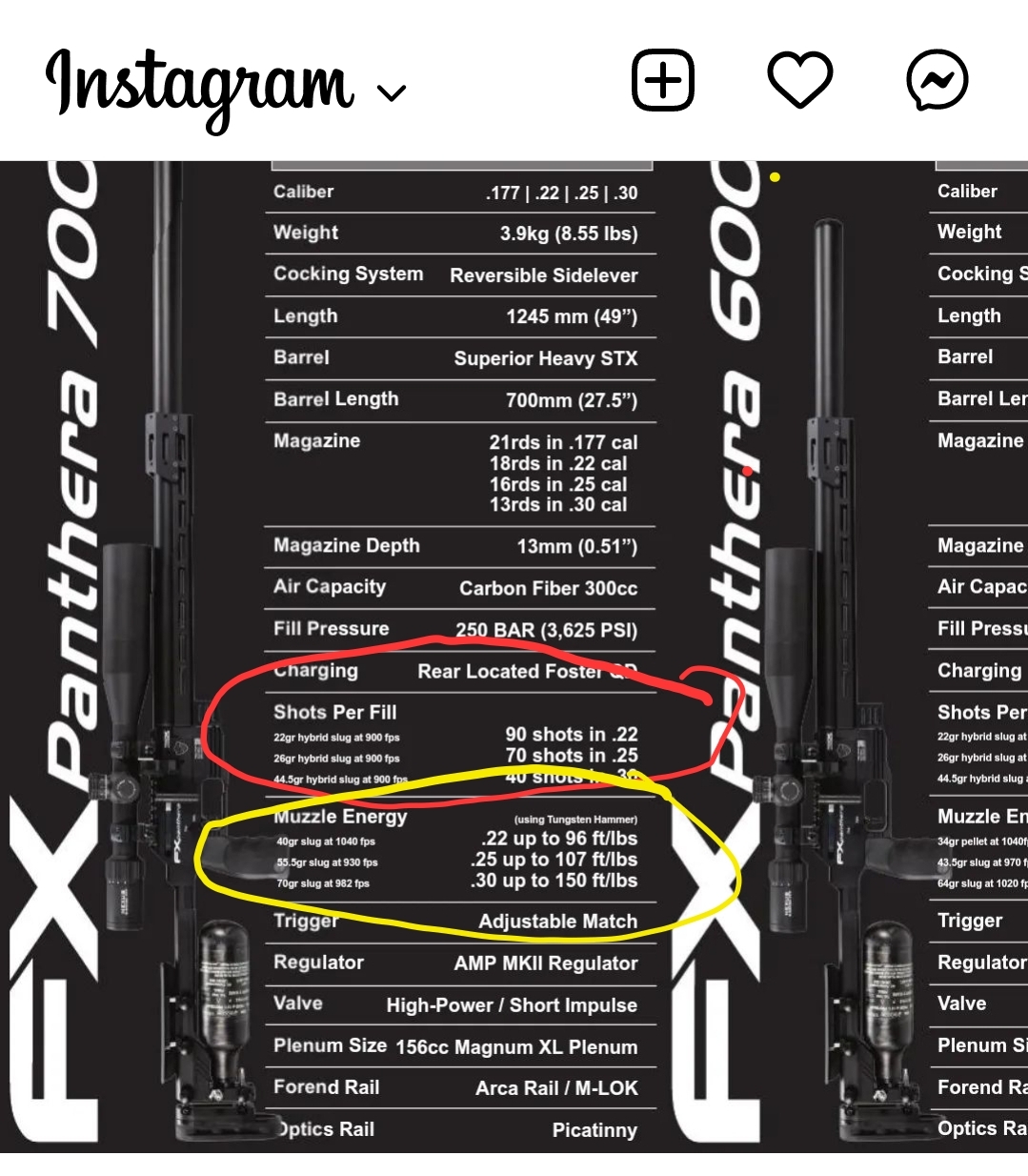

I love this, lol let's build something for a specific market doing a specific thing but
Let's advertise 90 shots with A but advertise FPE with B
Yep I spotted that right away ! Shooting a 40grain slugs at what you want is not going to
give you that many shots say about 1/2 or 1/3...

Well I dont agree with FX or their advertising. A long setup in PRS is certainly not an advantage. It is the opposite, just because FX says something doesnt make it true. And the low shot count is a con no matter how you look at it. A 300Bar 300cc bottle would still be a big improvement and there is no reason FX cant use one. Inocom, the company that makes their FX bottles has 300Bar available. I have one in front of me lol. I understand they were targeting a specific market. But lets be honest, they could have made the Panthera even better with a few small changes. Saying its limited because PRS exists is kinda silly. And since I already started digging this hole, Id like to also gripe about the speeds. If they really wanted to make a PRS rifle to compete with rimfires (FX own words); they should have made a something that can shoot 40 grain slugs at 1080fps in a happy range for the reg/valve and still be accurate.
In closing I think FX could have made a really sweet competition rig, that crossed over into other markets. If it had a 300Bar 480cc bottle, I would have pre-ordered a 500mm version in a heartbeat. But the reality is the limitations are going to exclude a lot of could be customers.

I wonder what the increase shot count would be going with a 300 bar vs. 250. Is it worth the increase pressure? I would also wonder how well the regulator could work at maintaining lets say 140 bar when the bottle is at 250 vs. 300 bar. After all this is a competion gun and having a large spread in speed would affect accuracy I suspect. One could always pay extra money if one wanted for a better regulator and higher pressure bottle for that matter, I'm sure someone will decide that dual bottles are better or a slightly longer butt section to allow for a larger tank maybe? Like the impact I'm sure there are things we can change to make it more suited to our taste.
