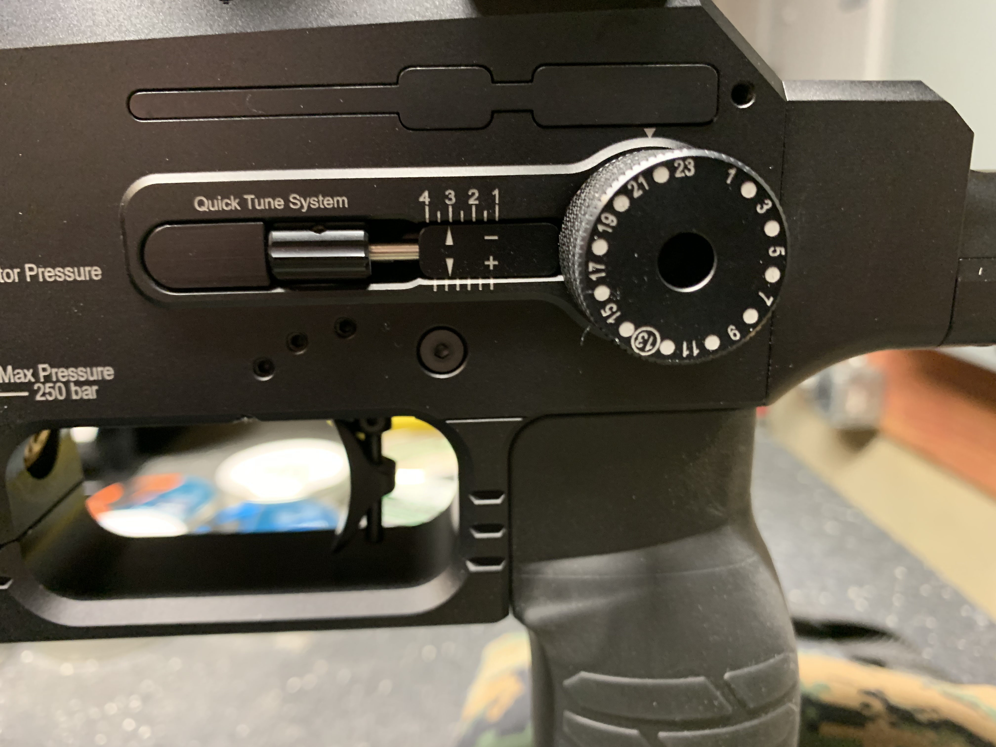

I have an FX Panthera 700 that arrived about a week ago. So far, I have not been able to achieve the 1030 velocities the FX videos indicated. The reg wants to sit a little above 150 though Utah Airguns indicated they had it set at about 170 before shipping it and at a 33gr Patriot Javelin velocity of 990. I am getting an average of 965 with the same projectile.
I tried to turn the reg up, but after about 1/4 turn it starts back down. The macro adjusted is set at 23.

You might want to spend some time experimenting with lower reg pressures. I'm an idiot and this was my first PCP so I went ahead and started turnin' and spinnin' every knob and wheel I got my hands on before I documented the 'factory' settings.
So I set my reg at 125bar, micro adjuster +10 clicks from the circled number and macro adjuster to 3.
34gr gen2 javelin chrony'd at 920fps consistently; I'm at ~200' above sea level.
