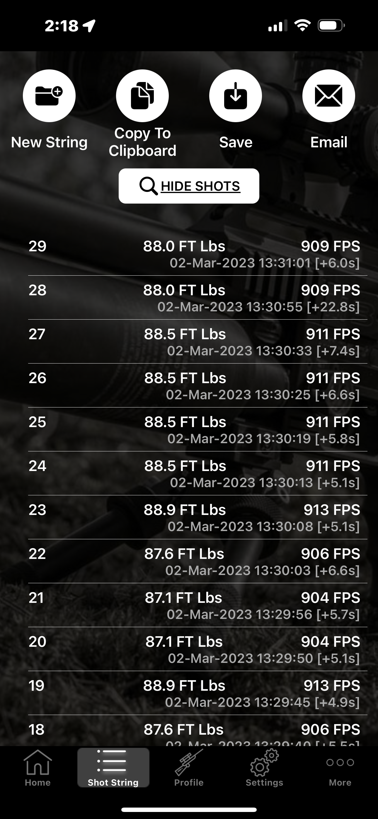

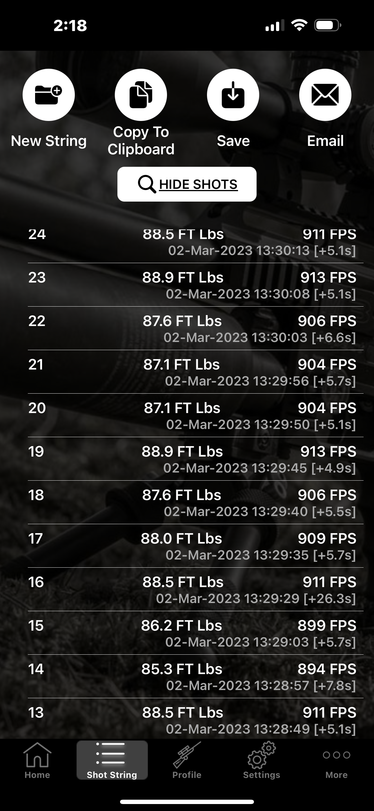

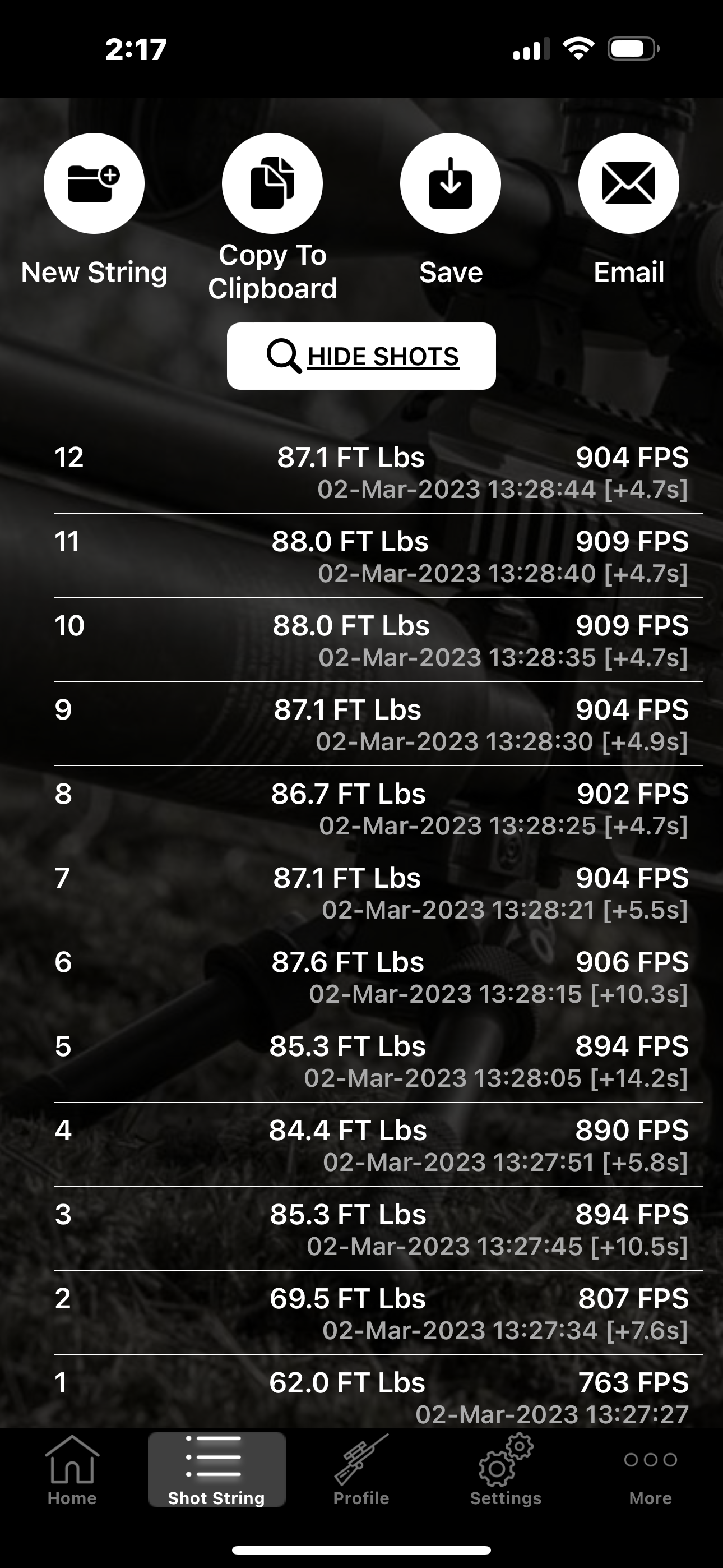

I have the 600mm .22 panthera and swapped it to 700mm .25 today. As a .22, it shot well, I only shot up to 34gr slugs, both javelin and H&N. I turned the reg down to 90 and played with the hammer settings until I was shooting 18.13gr pellets at around 950 fps, it was laser accurate with those, got a lot of shots per fill on the 300cc bottle
Reactions: Airgun Al
