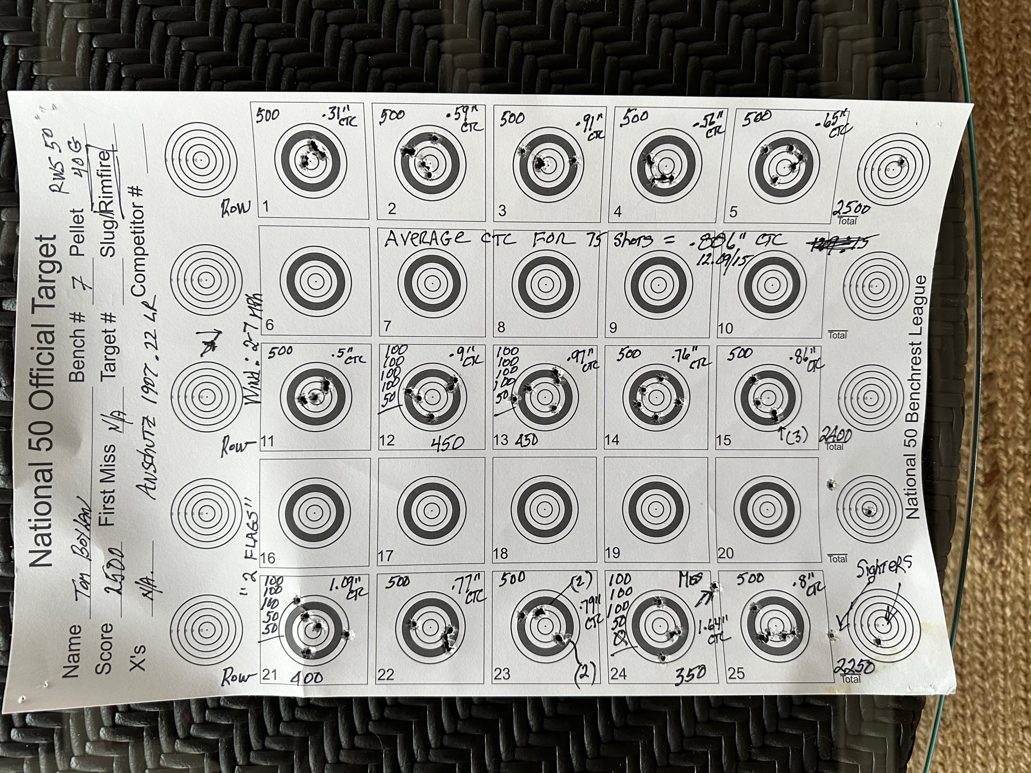

Good write up RusBear!
I am also anxious to see some 100 yard groups ( or scoring with EBR/ RMAC like practice target cards ) with the Panthera shooting 40g slugs.
FWIW - Mike N posted a"slugs in the rings" 100 yard virtual challenge quite a while back, almost a year ago. The idea was to see what .22 LR rimfires and high end slug guns could do at 100 yards in terms of scoring accuracy. We used N50 50 yard scoring targets ( 11 X 17" ) and shot them at 100 yards. The challenge was informal and for fun, but I and some others participated regularly. We did not get a lot of 100 yard air rifle shooters in that challenge unfortunately. Mike had asked me try out my two Anschutz .22 LRs, just to have a baseline for the thread and to see how the rimfires would do. It was and continues to be a lot of fun, and check out the thread in the Benchrest area if you are interested. Some good information in that thread, including how to score the targets.
My own experience shooting the RAW HM1000X .22 HP ( JSB 25.39 RD ), Safari .22 HP ( JSB 25.39 RD) and the FX Boss .25 (JSB MK2 33g ) was humbling for this challenge at 100 yards. All of the above for me, did not have enough gas ( power/velocity ) and pellet weight to achieve a high score. So, I am extremely curious to see the Panthera ( or any air rifle for that matter ) shoot at 100 yards with 40g slugs. Mike N and others shoot the Thomas HPX with 40g slugs very well at both 50 and 100 yards. All one has to do is look at the N50 results in 2022 and you can see how the top air guns stack up vs. rimfires. However, it will be interesting to see how the Panthera does at this distance with 40g slugs.
My best air rifle scores varied between a low of 1250 to a high of 1800 with the BOSS .25. By contrast both of my Anschutz .22 LR rimfires shoot frequently in the 2000-2500 range for the 'slugs in the rings' challenge. Only ONE perfect score ( see photo below, top row ) of 2500 with the Anschutz 1907 .22 LR.
My overall thought here is that a nicely tuned air rifle(s) ( other than a Thomas which we already have seen can shoot at both 50 and 100 yards ); should be able to get some very good accuracy at 100 yards with 40g slugs. Of course, Mike N also shot a 2500 as well with his Thomas HPX. :):)
