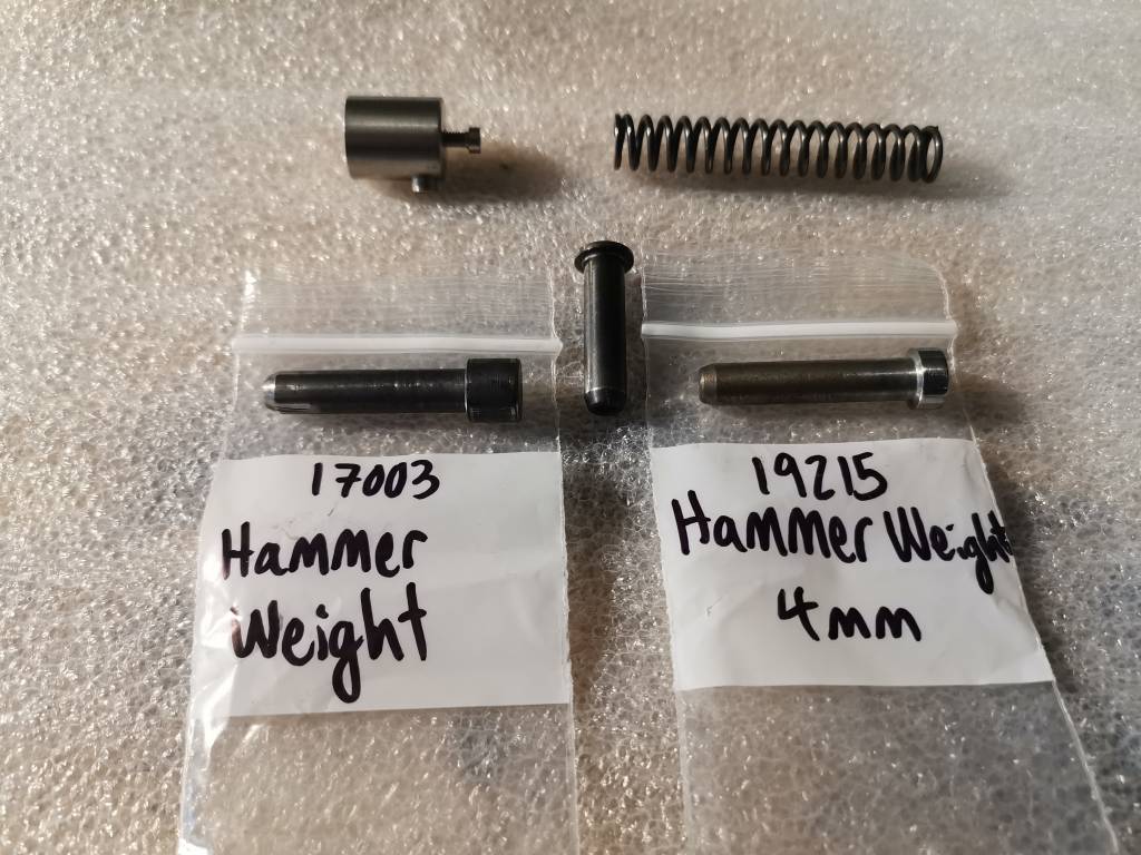

It came from SPAW, who has been completely unreachable for help, unfortunately. I had to go directly to FX USA who have been very helpful. They sent me the right part - a .25 hammer weight and I also purchased the .30 weight as well. The adjustment screw is 2.8 mm, set at 6mm out. Here's a pic, with original weight I the center.
