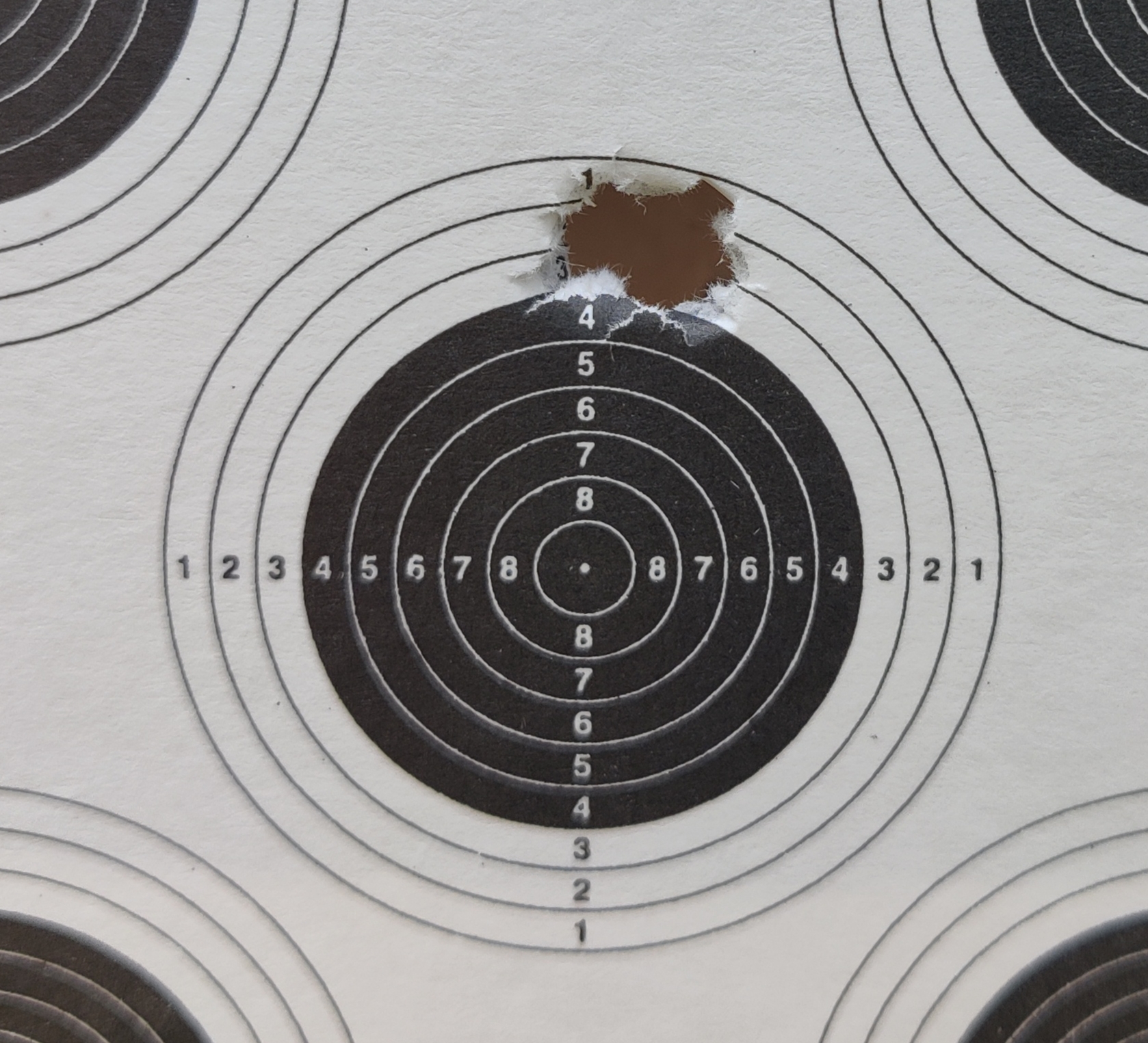

I reduced the IHS all the way down, that helped a bit but not enough so I increased the pressure to around 75 bars. Power settings 6 and 7 were however still the same fps , so the hammer was still overpowering the valve. I used PS 5 with IHS all the way down.
First 10 shot string had 4 fps spread and 1.2 STD. Over time it settled to 11 ED and 4.7 STD. Average fps was 899 on 15.86gr
My first 5 pellet 50 yard group was like this.
However I wasn't able to repeat it and all the other groups were much less consistent and some where all over the place but I guess that could be an user error as the fps was really consistent.
I could tweak this a bit more, but I have only 1.5 tins of 15.86gr left so I think I will be happy with this and then I will tune it to 18gr which should be slightly easier.
