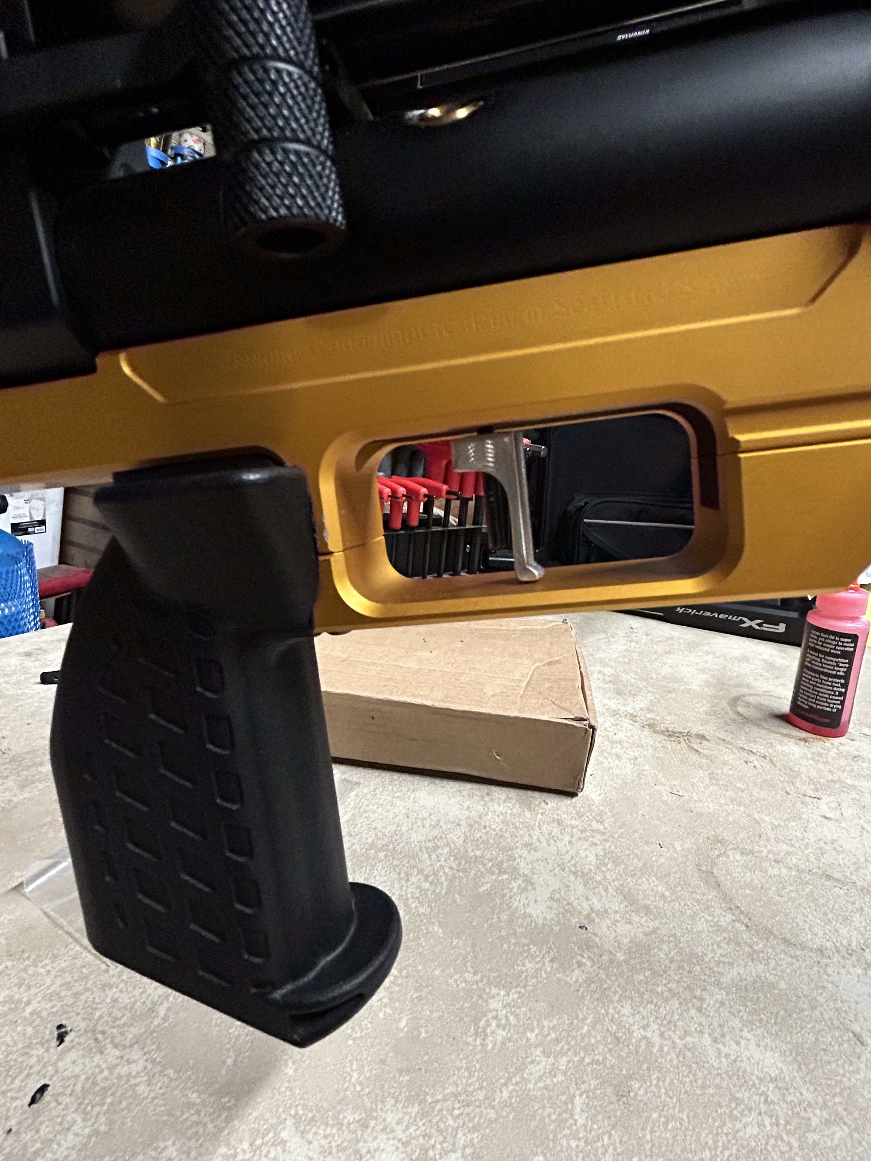

Wondering if there are any options for replacement triggers for the Maverick? I was a big bix n Andy fan for my long range benchrest powder rifles.
Why?Wondering if there are any options for replacement triggers for the Maverick? I was a big bix n Andy fan for my long range benchrest powder rifles.
I’m curious as to why as well. I have not seen or heard of any replacement triggers. The factory triggers are very adjustable, can be set very light and the take up (pre travel) set to where you like itWondering if there are any options for replacement triggers for the Maverick? I was a big bix n Andy fan for my long range benchrest powder rifles.
Not trying to make him justify anything, just curious, maybe he was having a problem, maybe there is something better out there, something for me to learn of as wellMaybe he wants a different shoe?
OP I'll answer your question without making you justify your reasoning.........
Pinpoint Trigger Shoe for FX Airguns
Pinpoint Trigger Shoe for FX Airguns The ultimate accessory for training trigger pull! This revolutionary design incorporates hours of research and development into the needs of a proper trigger shoe, along with review from some of the top shooters in the PCP Airgun industry! Features: Wide Body...www.capefearairguns.com

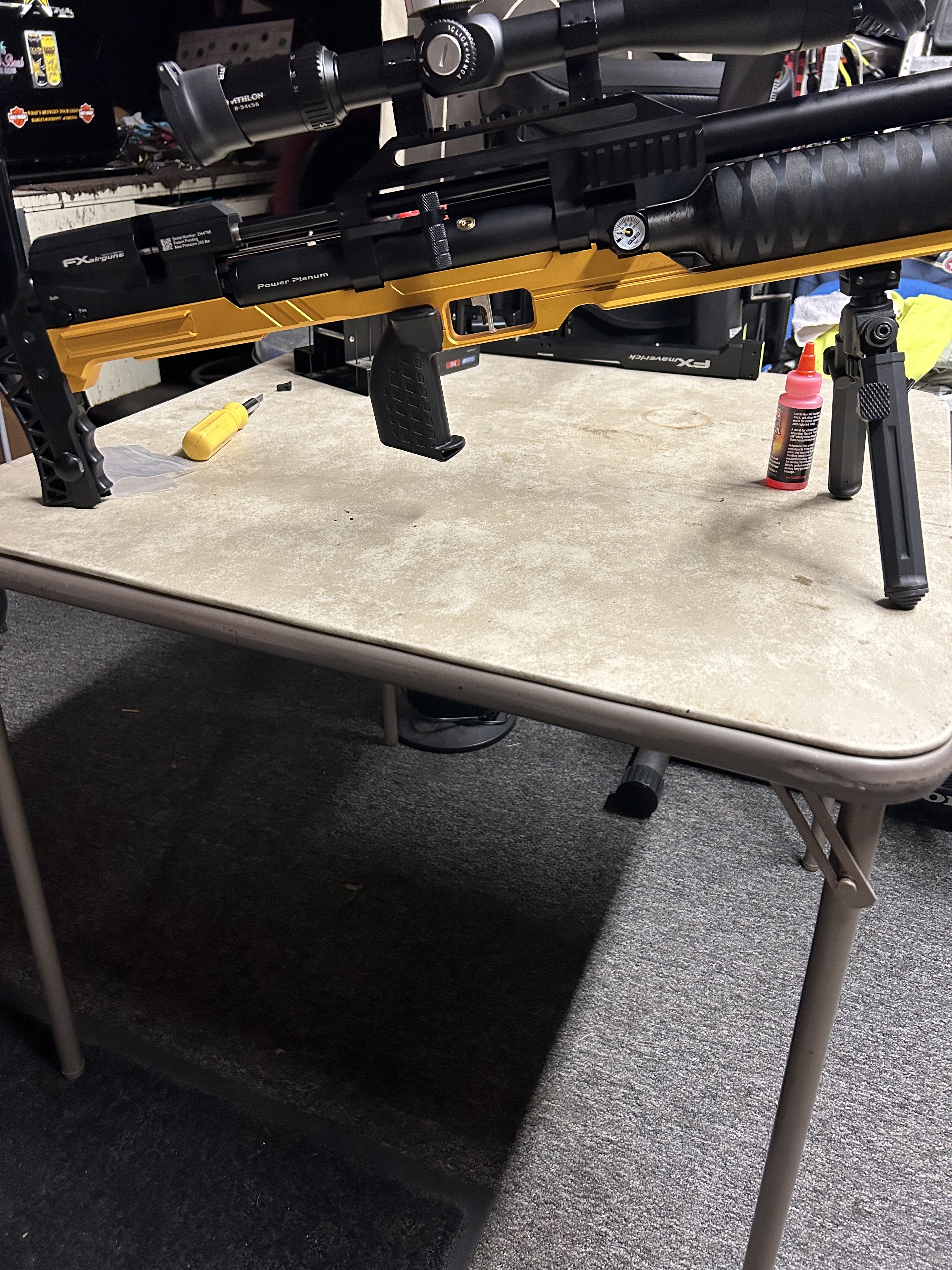

Honestly didn’t know of the adjustments you mentioned,,,the pre travel on mine is annoying. Also prefer much lighter pull then it’s set for…thanks for info.Guess I’ll research adjustment proceduresI’m curious as to why as well. I have not seen or heard of any replacement triggers. The factory triggers are very adjustable, can be set very light and the take up (pre travel) set to where you like it
Found you tube video,,,easy to adjust the travel out of it,,,a cheap fix,thanks for infoHonestly didn’t know of the adjustments you mentioned,,,the pre travel on mine is annoying. Also prefer much lighter pull then it’s set for…thanks for info.Guess I’ll research adjustment procedures
If you have the manual the procedure should be in there. Here is a video on a wildcat but it should be the same in the maverick. Hope this helpsHonestly didn’t know of the adjustments you mentioned,,,the pre travel on mine is annoying. Also prefer much lighter pull then it’s set for…thanks for info.Guess I’ll research adjustment procedures
Guess I was a little late sending it to you lol. Glad it worked out for youFound you tube video,,,easy to adjust the travel out of it,,,a cheap fix,thanks for info
Be VERY careful, the two adjustment screws work in concert, it's a short trip too messed up. Ernst Roe has a great video on the adjusting.Honestly didn’t know of the adjustments you mentioned,,,the pre travel on mine is annoying. Also prefer much lighter pull then it’s set for…thanks for info.Guess I’ll research adjustment procedures
