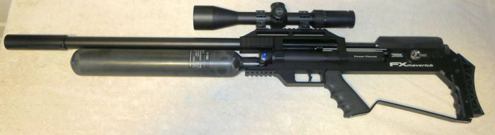

Would like to know from those that have the .30 cal Maverick sniper or M3 700mm what your getting for an actual shot count? Curious to what I can expect shooting slugs around 915fps? Thanks
Sorry I can't answer your question directly as I have never counted mags-per-fill with my .30 cal Mav Sniper. It never seemed to be an issue to me (it just seems like I get a bunch of shots per fill). Gotta be at least 4-5 magazines. Mine came from Baker as a 'demo' gun and was tuned to shoot 44.75's very accurately at 946 fps, so it ain't no powder puff.
Of course if you are worried about shot count, there are pretty painless ways to improve it as compared to the OEM 580cc bottle.
