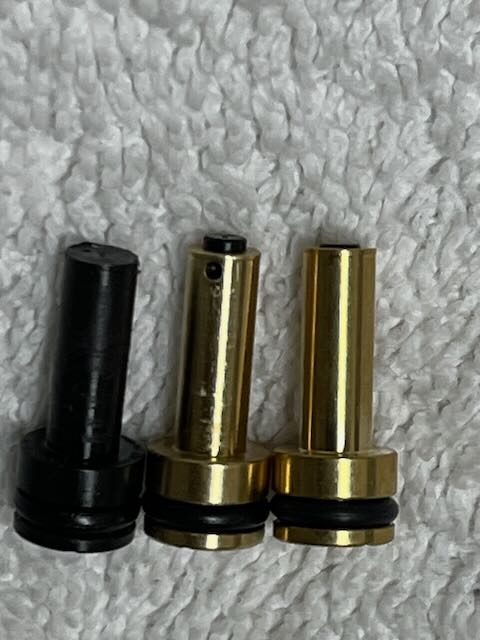

Is the Mav. new or pre loved? Reason is, the reg is slightly messed up either way. So, tear it apart, carefully, IMG_2768.jpeg The rods SHOULD look like the one on the right, if you have a middle one, you'll never get enough pressure, the one on the left is the originals, they tend to die with use, the ends get concave. Your Bellville washers, 11 should be ()()()()()( the last on can to up or down, I do up. And lastly here is a little thing I wrote up on the o-rings. FX changed some of them to 90's but didn't update their drawings

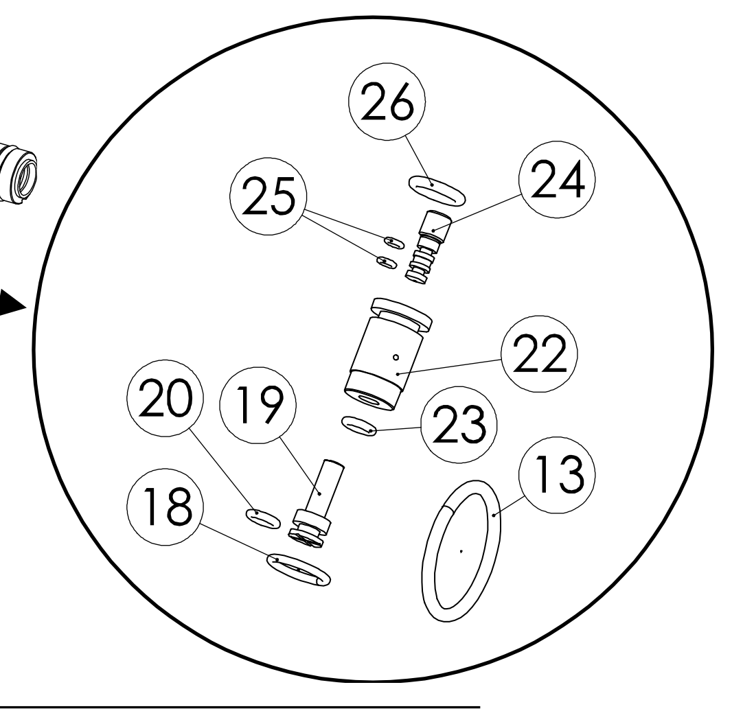

I've been digging deeper into the FX Mavericks o-rings and I've found that there are serious errors in both the online schematic AND the schematic they send with o-ring orders.
The schematic sent has different hardness's i.e. NBR90 instead of NBR70, this makes sense except one is several mm thicker than possible in it's location. The on-line schematic has the old durometer numbers but the right sizes. Numbers below correspond to the online schematic.
13) 10.0 x 1.5 NBR90 inside Regulator hole at bottom of threads
18) 7.5 x 2 NBR70 Regulator Body
20) 4.0 x 1.5 NBR90 End of Piston
23) 4.0 x 1.5 NBR90 Inside Regulator Body
25) 2.0 x 1.0 NBR90 (2x) Adjustment Screw, suggestion heat in boiling water slip on first one, then second one, or if you have a witches hat it’s easier. And no, heating them doesn't mess them up, they return to shape.
I lubricate the o-rings with Mobil 1, my personal thing, if it slide or moves it gets lubed.
I get o-rings from McMaster, O-rings and more, Global 0-ring, and others,cheaper in bulk, and they generally tell you when they were made, they do have a shelf life.

It sounds like your regulators have the pistons that are too long. If your adjustment screw is flush and you can't get enough pressure it's most likely the pistons length. Contact FX and they should send you the proper length.
Which is what I showed up above. Utah Air guns can send him some new ones, that happened to the like the ones on the right. The 'plastic' is just a few thousands of an inch above the brass My guess is about .003, I"d measure but I'm too lazy.
