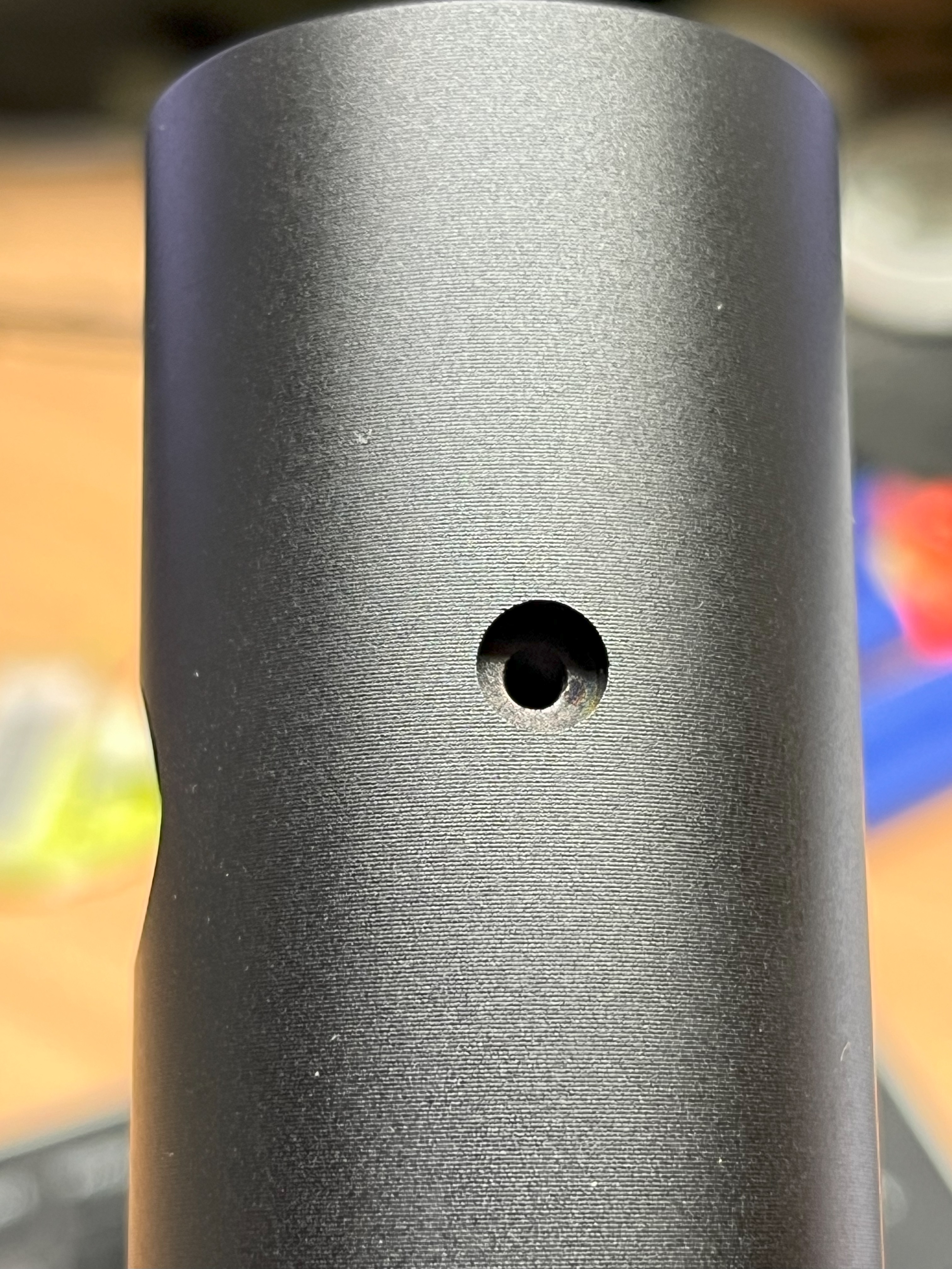

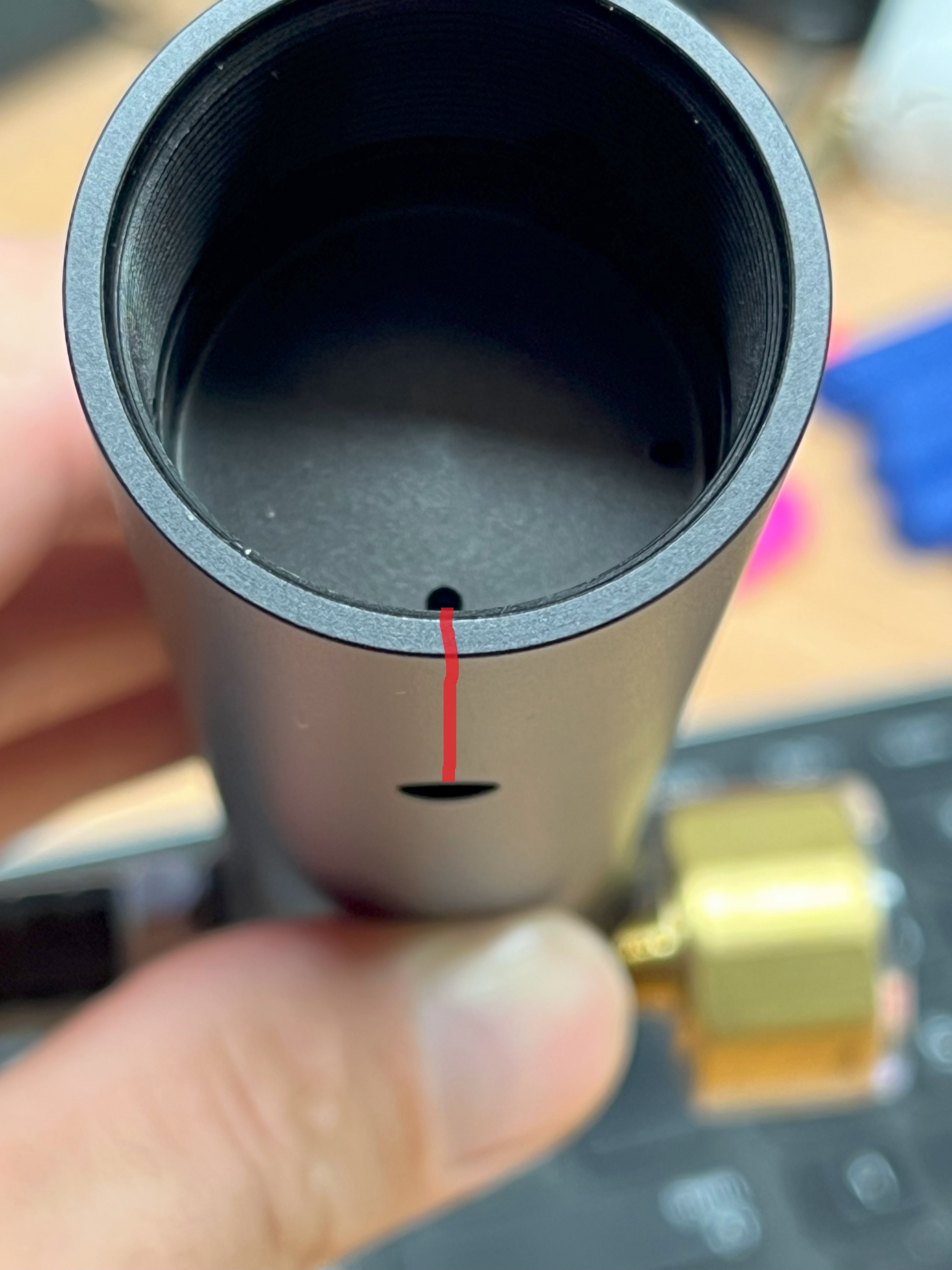

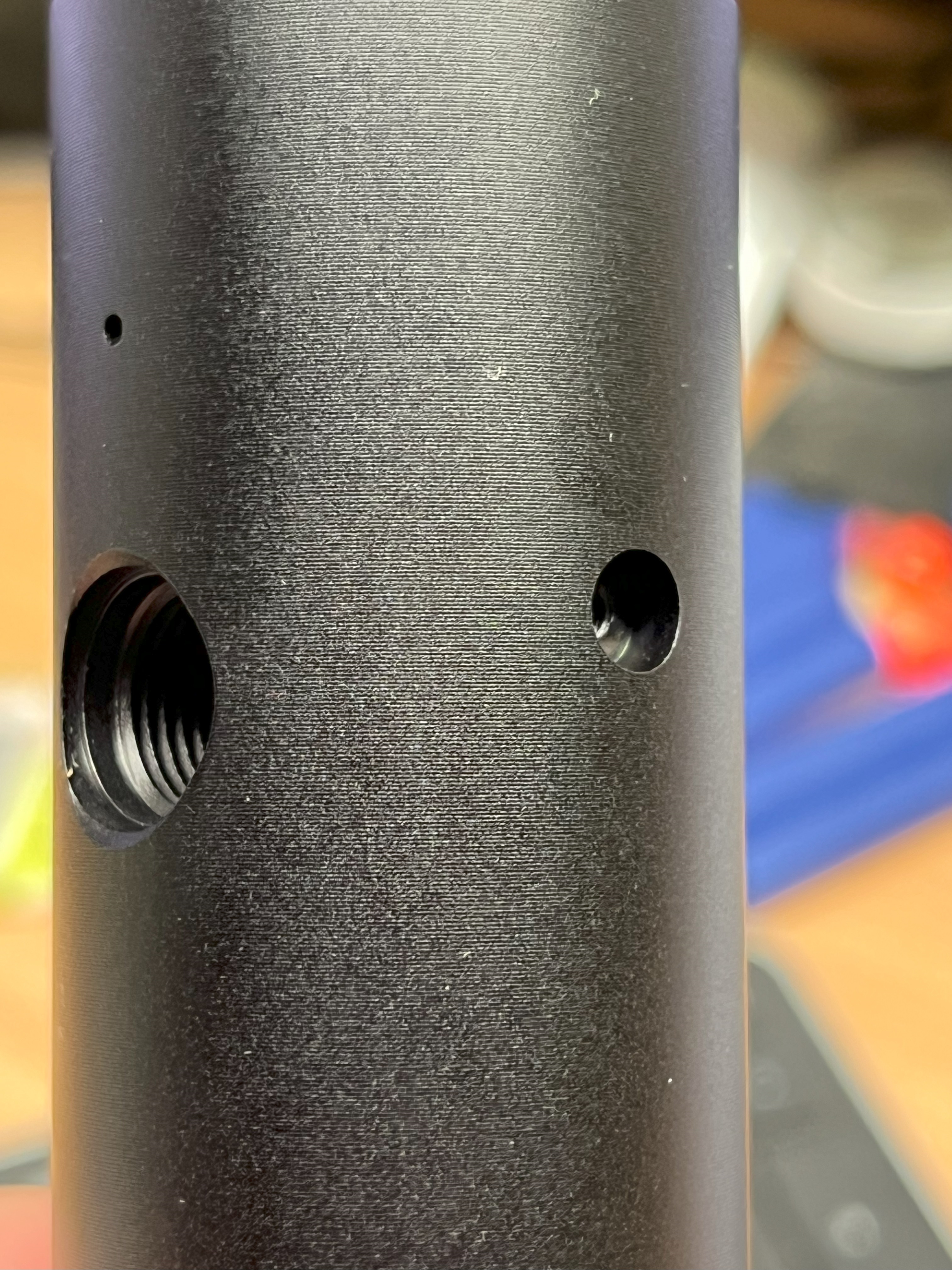

Hi,
Can anyone verify that this little threaded hole (see pics) is some sort of degassing hole. By measuring, it takes M3 screw and is connected to plenum side (red line on 3rd pic).
On first pic - regulator hole left and that M3 threaded hole right.

I know the degassing sequence.
My main question was that has anybody here seen that kind of reg tube with that extra threaded hole innit and know exactly what screw and seal goes into it?
No videos nor parts list show that.
If anyone in the future need to know what screw/bolt goes into that hole then it is M3x8mm. But You have to shorten that a bit.
As You can see on the pictures, if You thread that screw in, it bottoms out before screwhead goes flush with the tube. Recess for screwhead in tube is so deep that screwhead should be flush with the tube outer surface (look pictures).

Hi,

Yup, that vent hole is there on the first pic at left, above reg hole.
Hi, I have a sub 12ft/lbs maverick, being in the uk, and mine has a screw in that hole. Maybe it’s there to do with something about the power limit we have and is not needed in full power versions.
Reactions: Loff
The gun is all put together and fully functioning. This hole is from bottle side to atmosphere and is not interacting with regulator. Only function that came to my mind is for degassing gun between 1st and 2nd regulator.
