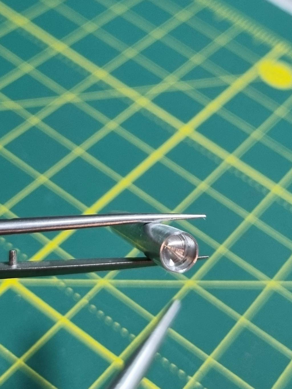

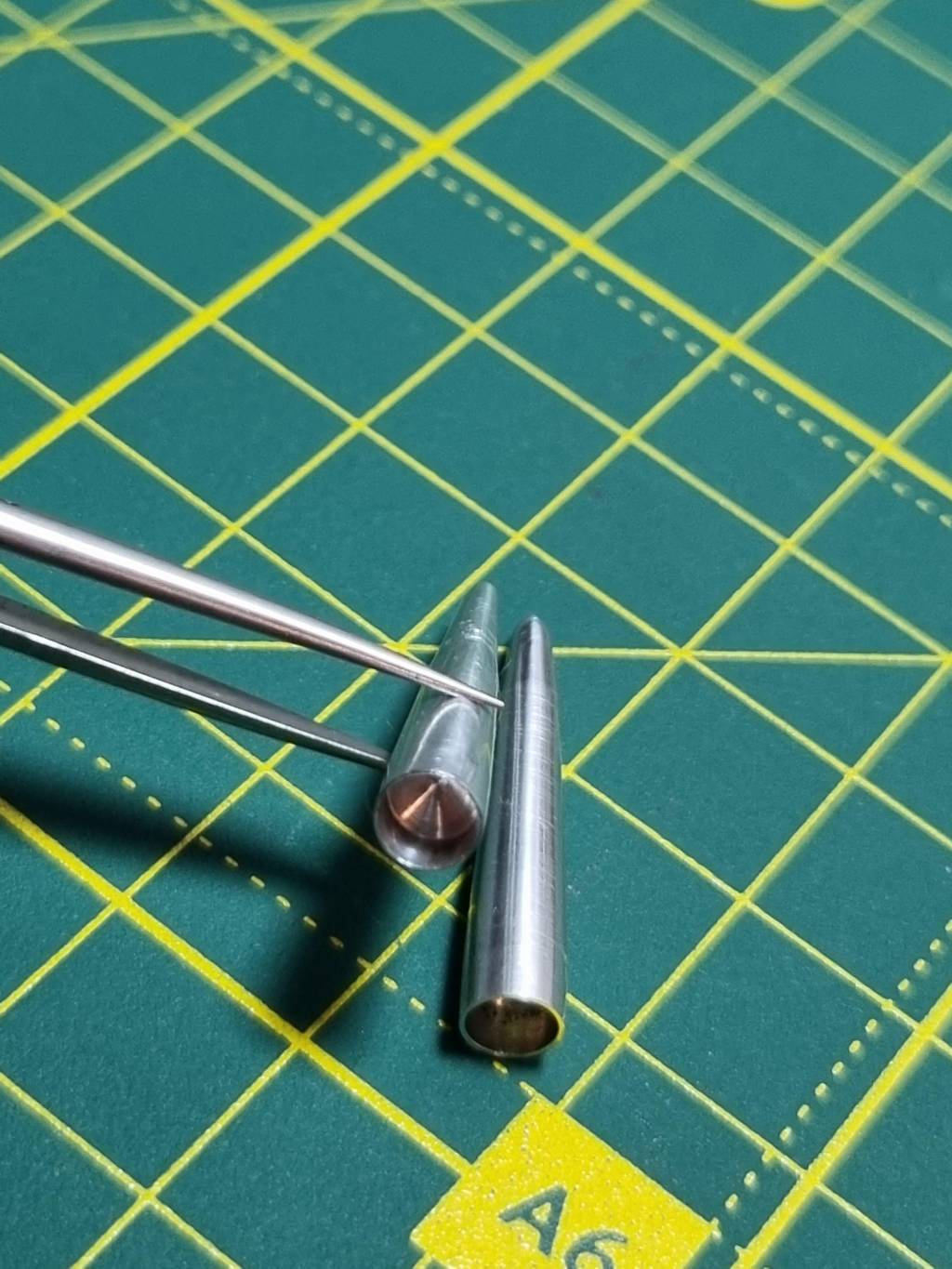

For those tiny 2 x 1mm o rings it helps to fabricate a witch’s hat to help guide those o rings into place-
I had these custom made to my specs, but any material can be used so long as the large end of the taper sits on top of the adj screw and allows the o ring to drag down on the tool and into place on the adj screw.
This tool will also work on the ends of the FX valve rods of the impacts and valve stems of the FX block receiver type guns
