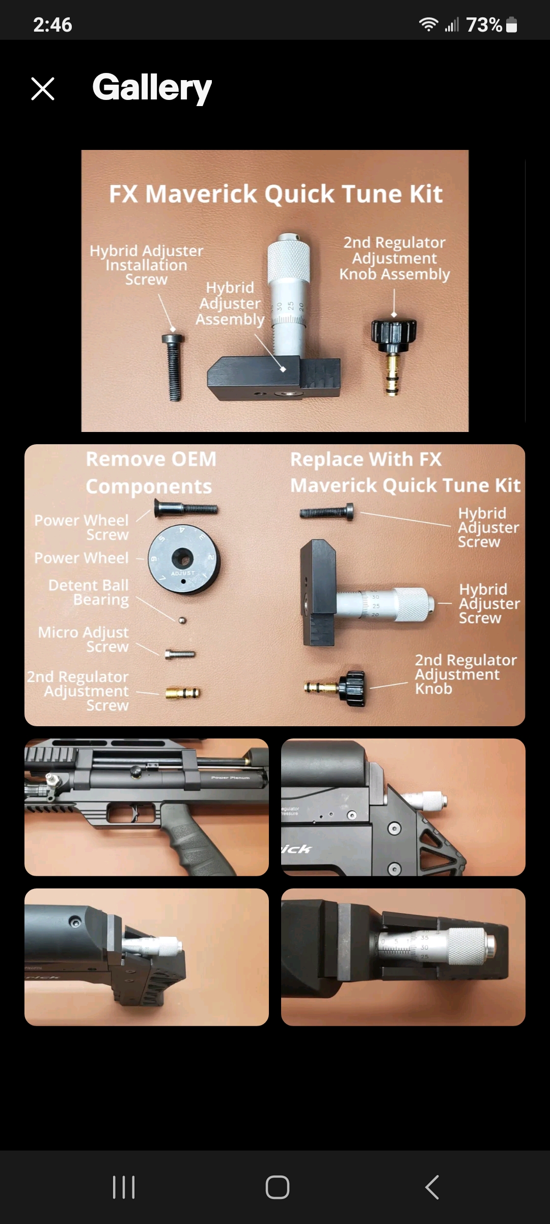

FX Maverick Quick Tune Kit

Sadly my ordered kit will probably not arrive before Saturday, but if the weather prognosis holds up, i am going to my friends place to.

3: Enjoy the first outing of 2024 with my Maverick, which i have just tweaked a little here in the living room earlier in the day, it is now on 970 FPS shooting RD pellets, i assume it will be the ideal 960 with 13 gr Zan slugs.

Nice, so good i did not close the lid on my hard case holding the maverick.
Just need to clear my work bench AKA my living room tabel.
Reactions: Trucker3573
Okay after a quick and easy install, and a little Chrono work, i am getting 960 FPS with 13 gr slugs - 90 BAR REG and 8.95 mm on the hammer,,,,,thingy :)
Needless to say i will dial a little more on Saturday, the HS / BAR are not yet perfect so some minor fluctuations i know can be smaller.
will probably require a few more BAR on top to be perfect., but i dont have too much trust in my chrono readings on my 8 foot living room range.
