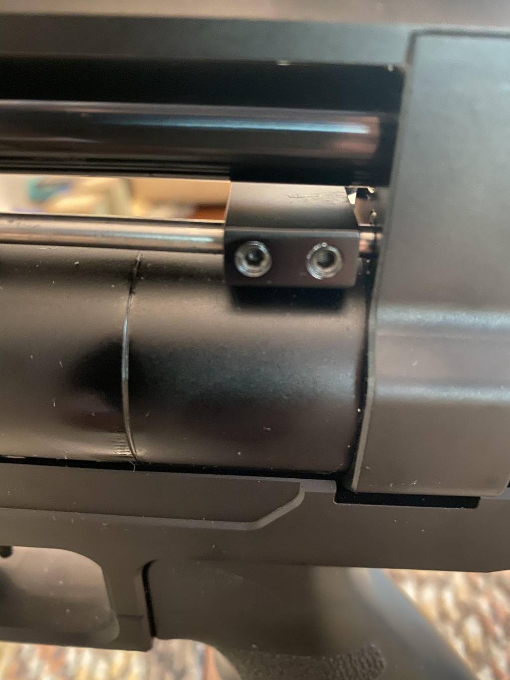

The two screws on the left side I am talking about. I could be dead wrong but had a similar thing with mine after shooting it awhile.
Not responsible if you misunderstand or mistake my meaning of words/description!
Not sure what that one is. I have found a few spots that would be best to loctite in, but highly recommend purple loctite due to size of screws. The grub screws on the block pictured above, the screw that holds the probe in place, and the power wheel screw are the top 3. I also had the small roll pin work itself out of the cocking arm mechanism. Easy enough to push back in and put a dab of clear fingetnail polish on each side to prevent that from happening.
