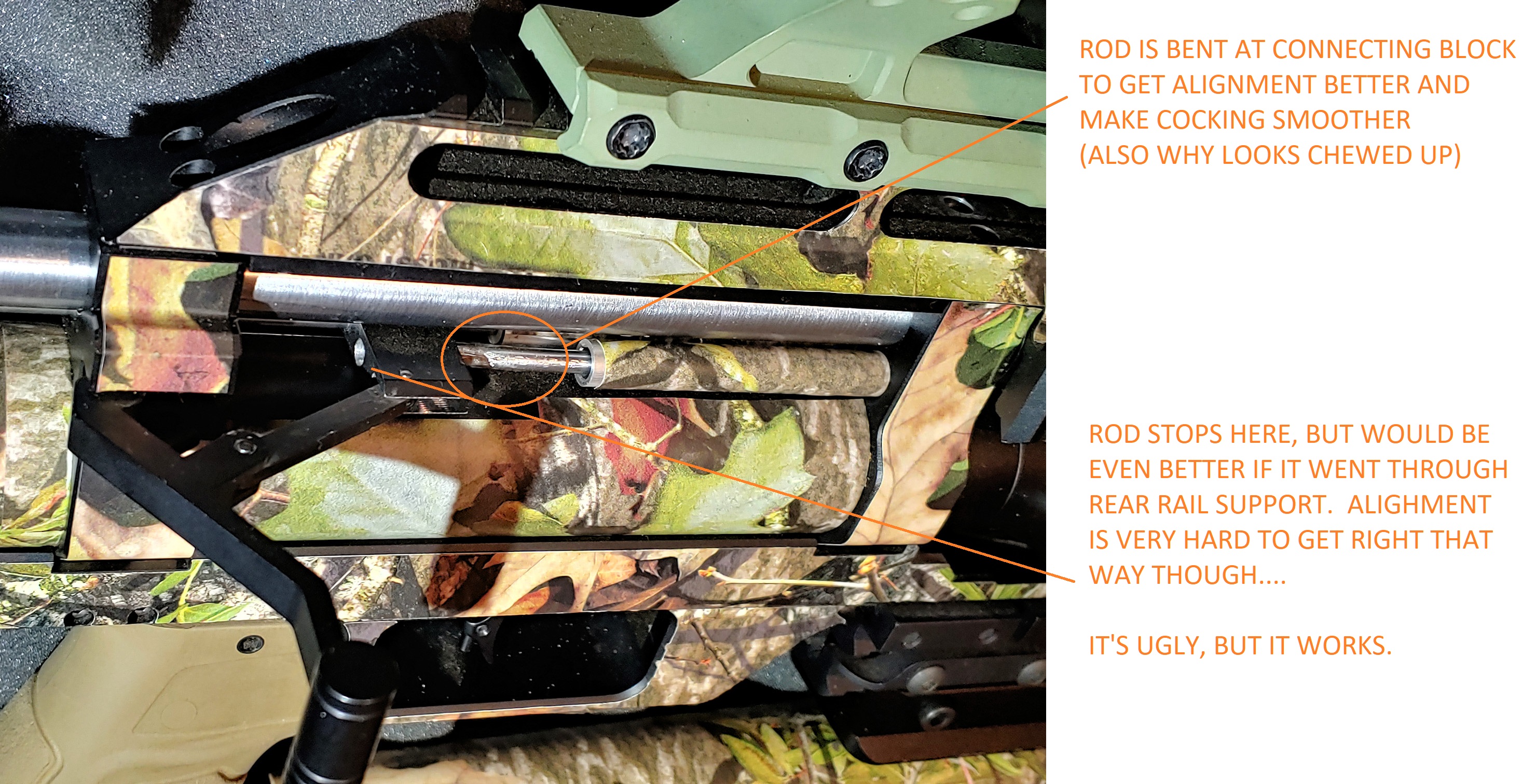

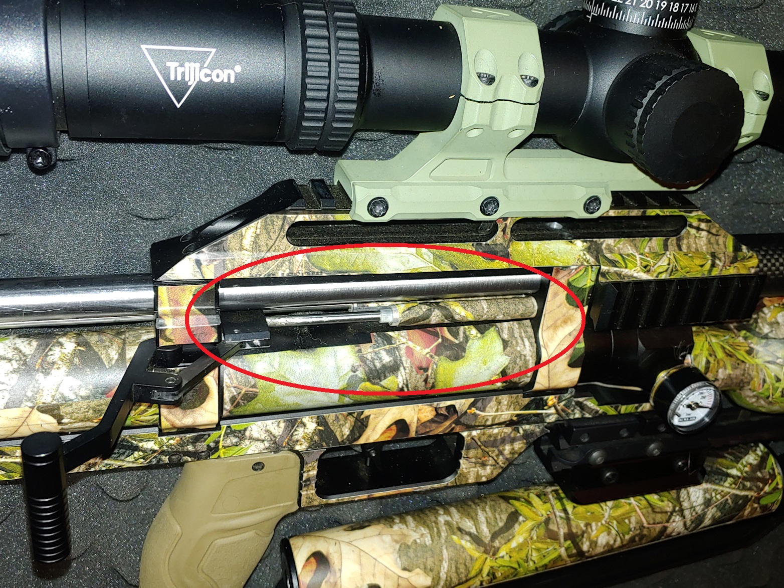

Back when I was running a tool steel cocking rod, I took a dremel and made slight depressions in the shaft where the grub screws contacted the rod. I also used red loctite on the screws. That kept it from moving on that harder cocking rod. I abandoned the HSS rod when it snapped on me during a shot, lol. It did last quite a while though. I'm now using a "dual" cocking rod setup by way of a second cocking rod that terminates on the lever side of the block. That has held up for a few thousand shots at this point. It has been taking over 170 fpe repeatedly with no issues lately, fwiw. It ain't pretty, but it works.

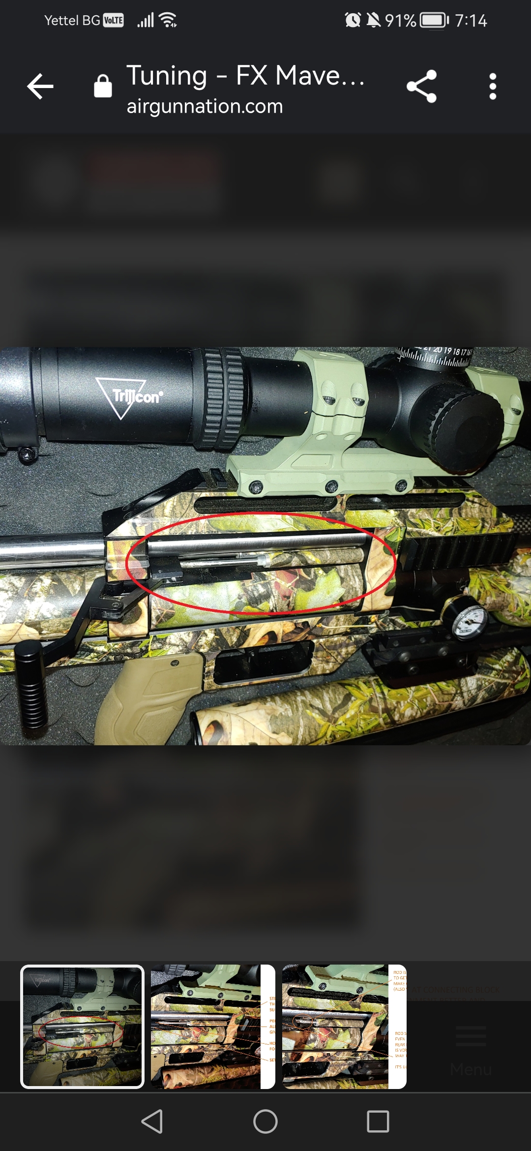

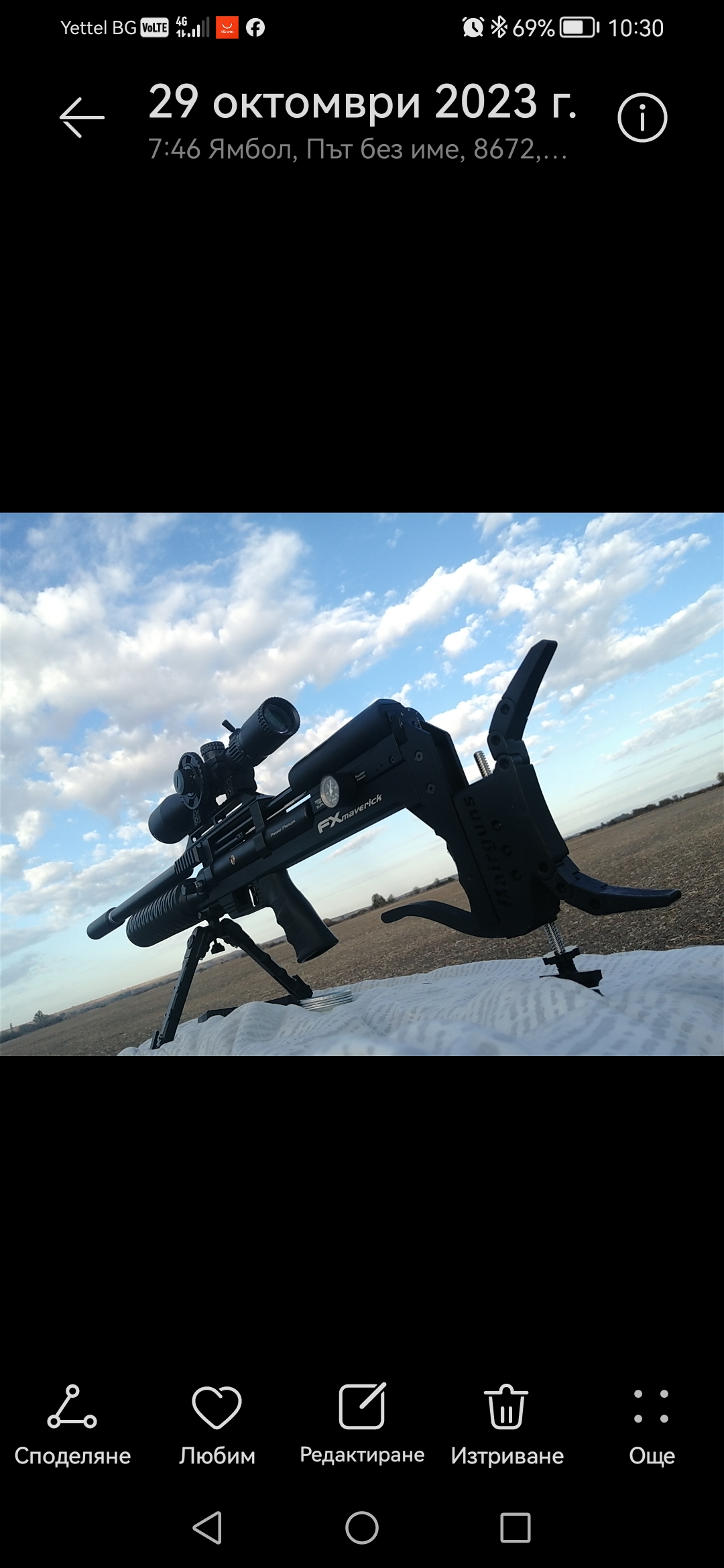

By the way, where did this camouflage film come from? :)
Yes, I only use this gun for larger game like wild hogs etc., and never use it for target shooting other than sight in. I want maximum power for those uses, but I don't want to use a big bore. I like that I can still make the .30 really quiet, even if it is shooting at 180 fpe(244 joules) with 90 grain slugs :D I used Mossy Oak Shotgun Wrap(comes in a kit). It's tedious to do right, but it works well and can always be removed if wanted.
I'm talking about these spokes.
Most of the info you need is in reply #58. I made all of those parts from scratch, and the extra rod itself is just a section of a bent FX cocking rod that chopped to fit. That's really all of the info I have on that. 170-175 joules will definitely kill a hog, just know your anatomy and probably stick to head shots. You could do body shots on smaller ones, but be prepared for some tracking and possibly losing a hog if the shot isn't perfect. I ALWAYS take head shots on hogs myself, regardless of power. I wanted the extra power for more flexibility if I needed to take a body shot on a deer, but I still prefer head shots.

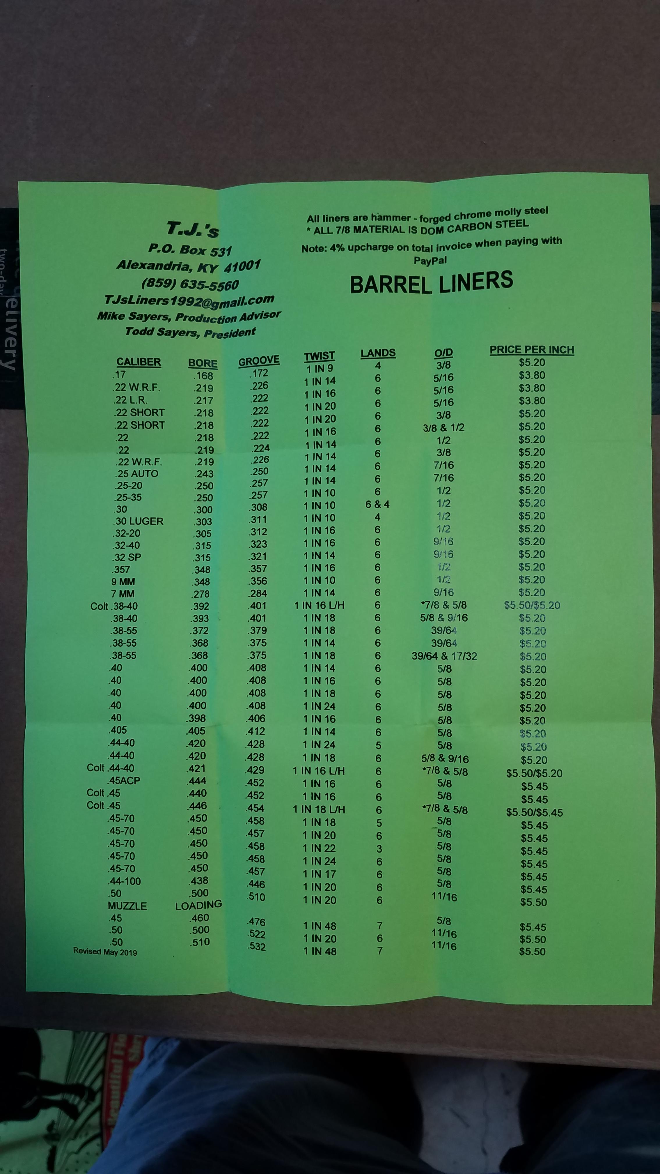

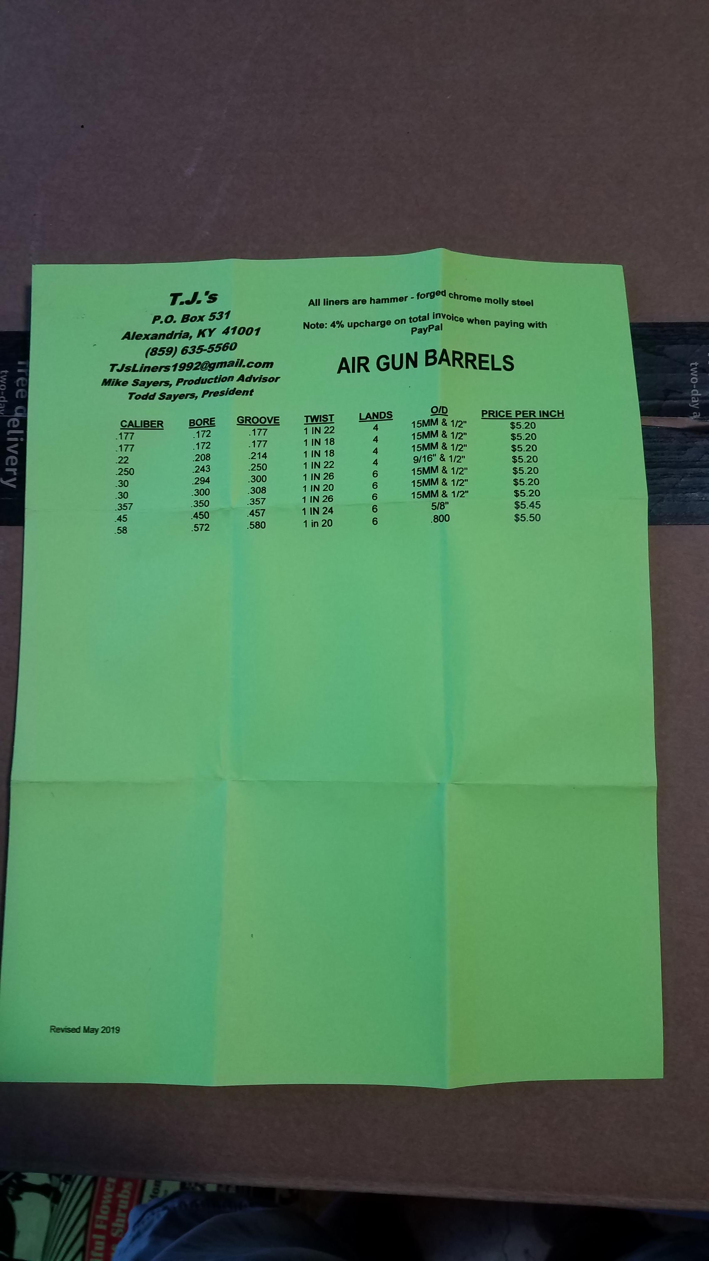

Is it possible to give me information on where I can buy such a TJ barrel in America? Data for an online store that sells them or ??? As well as foil shop data !!! Thanks in advance. :)
Sorry, I was out of town for a few days... Here's the info sheet for TJs. You can try emailing them, but I don't know if they ship out of the country. They don't list the 1:16 twist .300 barrel on their sheet, but they do have one. I'm not sure what you mean by the foil shop, are you talking about the camo wrap? Just search Mossy Oak Shotgun Wrap on Amazon or google and you'll find it.

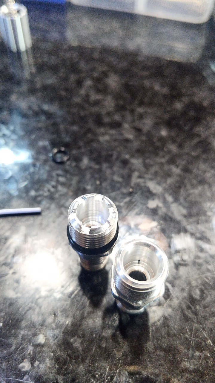

Just to summarise the valve testing and to put an end in using rallyshark full beans thread i can say a valve shaft of 3.7mm is about the more balanced you can go with a maverick valve and only if using a valve return spring with preload close to the original one.
Just for sake of completion i must say all the different valves i tested at beginning were using a 6mmOD and 0.3mm thickness 316L wire so they couldn't be directly comparable to the original because i was already introducing a change that worked well with the original valve but was creating a problem with the more balanced ones-- being not enought preload to close the valve back if little pressure was behind it causing valve to blow open temporarily.(not enough energy in the spring to overcome o-ring stiction on it's own).
The original valve return spring solved this though I'm still using a weaker one at the moment but i still use an adjustable one like the impact.
Needed around 5mm hammer pre-load for 170bar pressure with 800mm .25 barrel but there are drawbacks to using this type of valve experience by me and said by others.
@nervoustrig recently posted something that matched my testing and that i couldn't put so eloquently in words. Big thumbs up for this guy, for everything i have red from him, he knows his stuff and says things to the point.
"A balanced valve does not produce more power at lower pressure. A balanced valve is simply easier to knock open…easier to develop a given amount lift and dwell with a lighter hammer and/or spring. This advantage comes at a price, however. Relative to a conventional valve, balanced valves are more sensitive to inevitable variations in hammer strike, more sensitive to pressure variations related to regulator linearity and temperatures changes, and more susceptible to a slow first shot due to O-ring stiction (breakaway friction of the O-ring which seals the balance chamber).
As such, I am of the opinion that a balanced valve is best suited for energy levels somewhere north of 100fpe. In that role, they really shine. For everything else, a conventional valve is hard to beat for its simplicity, tuneability, reliability, and consistency."
The point of this testing was to use less hammer so that more flow area is available for larger calibers by not needing a thick valve stem around throat area. Done. Happy mostly with what I learned and that there are some people who have good info around this forum and are humble and patient enough to share.

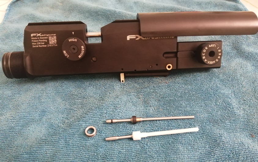

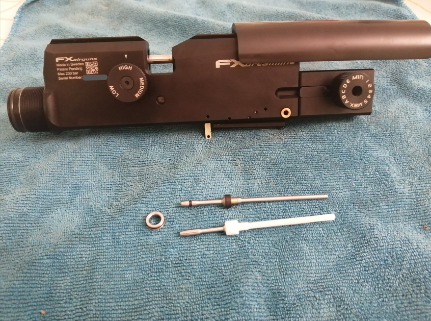

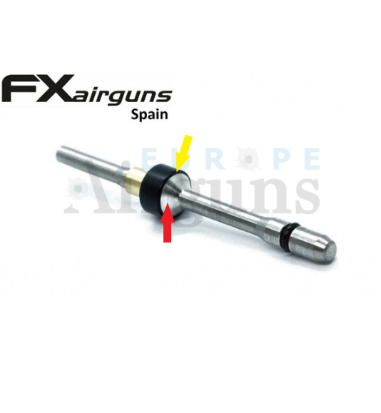

Здравейте. Извинете за необичайния въпрос, но къде трябва да уплътнява клапана към седлото си, металната му част или тази от Делрин ???
При мен има за ремонт една дива котка в 22 калибър, определено се докосват двете метални части на детайлите и не може да задържи налягане след свързване на бутилката към пушката :)
I just saw this, but it is supposed to seal on the Delrin part, not metal to metal.
Аз също така си мислех , но при мен има един Дриймлайн на който уплътнява метал в метал, направих нов клапан от метал и полиамид, вече няма о-пръстен на стеблото на клапана, сухите тестове за налягане са издържани, днес и утре ще се тества всичко по време на стрелба.
